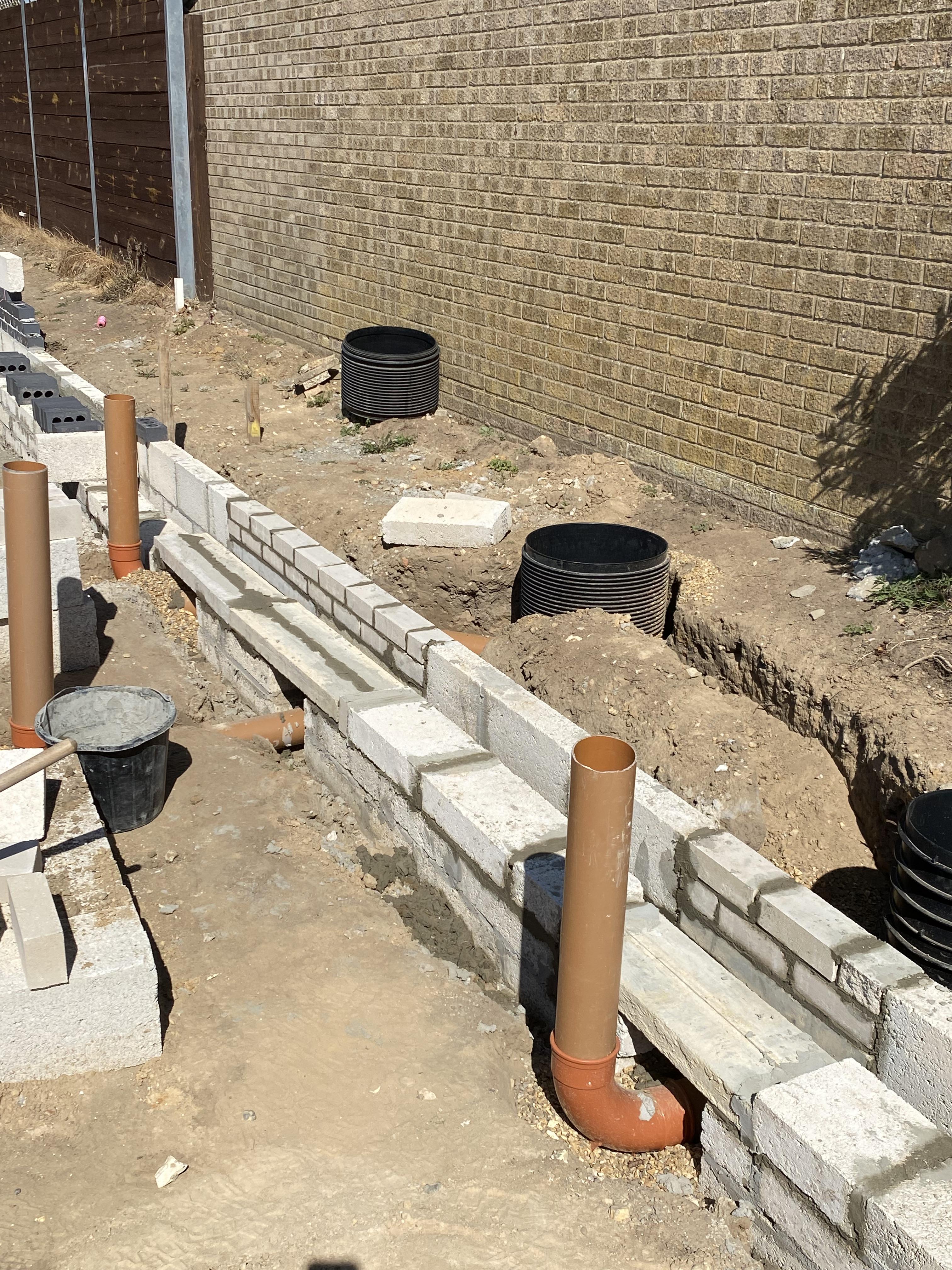

Martin S Posted July 30, 2023 Posted July 30, 2023 Hi there I am self-building our family home and have minimal fall from ground floor level down to the combined sewer to make a connection without having to rely upon a domestic pumping station. We are building using ICF with strip footings and a ground bearing slab. Our floor build up is as follows per attached details: - nom. 25mm finish above screed level - nom 50mm self leveling screed (assuming 50mm rather than 60mm drawn) - Vapour control barrier/500 gauge polythene sheet over of nom thickness - 165mm thick rigid PIR insulation - Visqueen DPM of nominal thickness - 150mm reinforced concrete slab - 50mm sand blinding - min 150mm hardcore - min 225mm deep strip footings I understand that it is usual for the drainage to penetrate through the rising wall above the strip footings with flexible connections either side to allow movement and that there is no need for lintels given ICF walls. In terms of the floor build up what is the highest layer that I can penetrate the rising wall at, i.e. can the pipes penetrate down through the top of the floor, bend and penetrate through the rising wall within the hardcore, sand blinding, reinforced concrete slab or PIR insulation layer? Reference to relevant building regs would be greatly appreciated in case I'm challenged by Building Control. Thanks for your help. Martin

Martin S Posted July 30, 2023 Author Posted July 30, 2023 Thanks. So I could break through the wall through the PIR layer and through the DPM lapping up the internal face of the rising wall? The DPM is Visqueen R400 Radon Membrane as also acting as a radon barrier with sump below. Yes, using Polarwall.

Martin S Posted July 30, 2023 Author Posted July 30, 2023 Understood but seeking level thresholds for wheelchair access. Unfortunately can’t raise house - had to dig down in the site to accommodate ridge height - and connecting into pre-existing combined sewer at a certain height. Be great if, as a minimum, I could lay drain across sand blinding to gain its 50mm thickness and 150mm thickness of hardcore. If I could go across higher even better.

saveasteading Posted July 30, 2023 Posted July 30, 2023 And how much lower than the floor is your final drainage connection?
Chanmenie Posted July 30, 2023 Posted July 30, 2023 (edited) 11 minutes ago, saveasteading said: And how much lower than the floor is your final drainage connection? I brought my pipes in over the strip footing under the PIR but I have loads of fall to play with as the main is approx 1.6m below my finished floor Edited July 30, 2023 by Chanmenie
Martin S Posted July 30, 2023 Author Posted July 30, 2023 Final drainage connection is 770mm below internal ground floor finish level but pipes need to run ~50m.
Chanmenie Posted July 30, 2023 Posted July 30, 2023 2 minutes ago, Martin S said: Final drainage connection is 770mm below internal ground floor finish level but pipes need to run ~50m. So you need to start max 270mm down to give 1:100 fall which I believe is the min fall you can have. Not ideal but you’ll have to have the pipes in the insulation layer
saveasteading Posted July 30, 2023 Posted July 30, 2023 1 hour ago, Chanmenie said: 1:100 fall ..is beyond many groundworkers' abilities. For later of course, but you will have to check their abilities and understanding or 1. The pipes won't join. 2. It will be flat or uphill in areas and get blocked. Also be aware that height is lost at turns in inspection chambers. I think it is about 30mm but this could matter. This all needs thinking through now.
Chanmenie Posted July 30, 2023 Posted July 30, 2023 36 minutes ago, saveasteading said: ..is beyond many groundworkers' abilities. For later of course, but you will have to check their abilities and understanding or 1. The pipes won't join. 2. It will be flat or uphill in areas and get blocked. Also be aware that height is lost at turns in inspection chambers. I think it is about 30mm but this could matter. This all needs thinking through now. Yeah certainly, I personally would not want a 1:100 fall, I’ve done mine at 1:60 as you say very little room for error.
