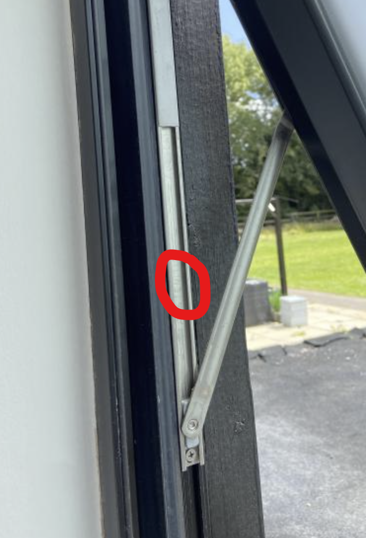

Surfdude Posted July 29, 2023 Share Posted July 29, 2023 Have some Origin windows whose restrictors don’t restrict much at all, windows fly wide open all the time. Strikes me that I could limit their opening if I could get hold of some more of the plastic insert that was placed in the channels by the installers. Unfortunately, they’ve gone bust so I don’t know where to get extra inserts from. Have any of you guys come across them? Link to comment Share on other sites More sharing options...
Rob99 Posted July 29, 2023 Share Posted July 29, 2023 That seems a fairly simple plastic profile but if you can't find any then you could screw a small stop into the channel at whatever point you want the window to open to. Link to comment Share on other sites More sharing options...
Surfdude Posted July 29, 2023 Author Share Posted July 29, 2023 Hi Rob Yes, thank you, I did indeed consider that. Only thing is that means unscrewing the window from the hinges in order to insert the screws. Don’t really want to start doing that, unless I really have to. Obtaining and just cutting a few lengths of those profiles would be a whole heap simpler. Just a question of locating a source for the darn things! Link to comment Share on other sites More sharing options...
Rob99 Posted July 29, 2023 Share Posted July 29, 2023 I don't think you need to remove the window, just drill a small hole in the slider and put a screw in it, see pic 1 Link to comment Share on other sites More sharing options...
Temp Posted July 29, 2023 Share Posted July 29, 2023 Google.. Channel closure strip or Channel cover strip. Link to comment Share on other sites More sharing options...

Temp Posted July 29, 2023 Share Posted July 29, 2023 1 hour ago, Rob99 said: Just another thought, is there a manufacturers name anywhere on the hinge? Might narrow down an online search, or give you somebody to ask. You can just make out the word austenitic (?) on the channel in the photos but I think that just a type of stainless steel. 4 hours ago, MikeSharp01 said: Cut a little bit, 5-10 mm of the plastic top you want, take it to someone with a 3D printer, e.g. @Onoff and ask them to print you some lengths for you. Some 3D printers are held together with T nuts. You put them in the channel, turn them 90 degrees and tighten a screw to fix in place. Something similar would probably work here. 1 Link to comment Share on other sites More sharing options...
