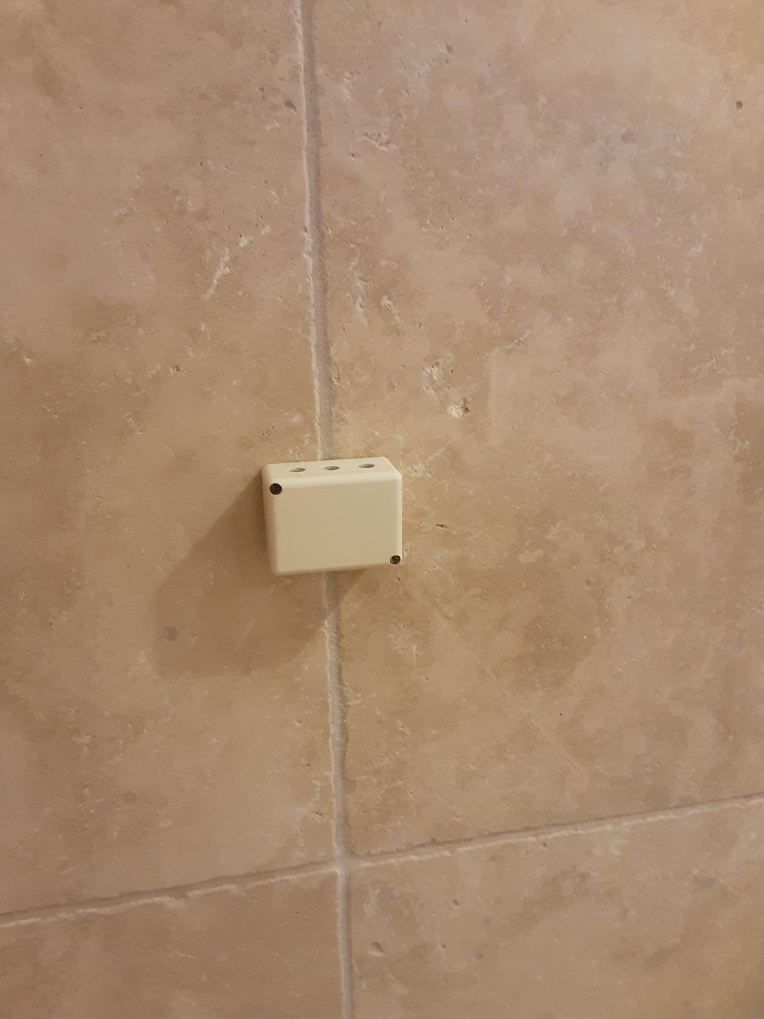

I actually made one. Its just a 10k NTC (@25C) resistor. Something like this and some heat shrink sheeve to insulate the wires after soldering. I used telephone cable to hook it up to the stat. Only need two wires but ideally they should be twisted together.
https://www.ebay.co.uk/itm/5pcs-NTC-10k-Thermistor-MF52-103-Temperature-Sensitive-Resistor/264908446152?hash=item3dadc619c8:g:d04AAOSwYP5i58R2&pageci=3bf7b223-b3df-4e6b-a18e-b2df511f1ba3&redirect=mobile
I put it in a small plastic box (about the size of a match box) with a few holes drilled along the top and bottom. If doing it again a could probably 3D print an even smaller one.
Google found another make that im sure would also work...
https://www.sterlingsensors.co.uk/indoor-wall-mount-thermistor-sensor.html
I'm sure Heatmiser must make a a remote air temperature sensor - I probably made mine after seeing the price !
