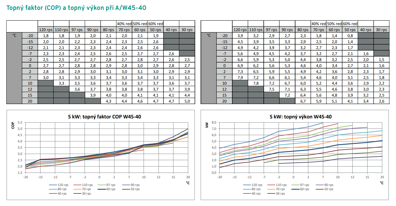

embra Posted July 24, 2023 Posted July 24, 2023 (edited) Our heating engineer has prepared an MCS heat loss calculation to size an ASHP. There are some factors in there which I feel are conservative (such as ventilation losses which don't consider air tightness improvements), and when comparing to my own best case calculations I've found we could potentially drop to a heat pump with a lower output (e.g. 7 kW to 5 kW), saving a bit of money on equipment costs. I have tendency to over analyse things, so I'm wondering if there's a general rule of thumb around the tolerance in heat pump sizing, or if there are any specific drawbacks or watch outs when it comes to potentially oversizing a system due to conservative assumptions in the heat loss calculations... any guidance most appreciated! edit: if it helps, we're looking at a Vaillant Arotherm Plus unit Edited July 24, 2023 by embra
sharpener Posted July 24, 2023 Posted July 24, 2023 54 minutes ago, embra said: if it helps, we're looking at a Vaillant Arotherm Plus unit There is full performance data here, it seems not to be available on English-language web sites but is easy enough to work out. Your experience is similar to mine, installers play safe and make conservative assumptions as do Vaillant tech support. Watch out for lower than necessary OAT (Outside Air Temperature) assumptions, they should vary by region, the table is on p10 here. Also if you have additional heat sources e.g. WBS (Wood Burning Stove), AGA, MVHR (Mechanical Ventilation and Heat Recovery) make sure they know these are available to help out below the design OAT. Equally supplementary water heating by solar PV. These considerations are not officially allowed by MCS but might tip the balance of thinking. Arotherm + specs seem to be quite generous so you may well be right and could get away with a smaller unit. I was orginally told their 12kW was too small but after arguing that the proposed 15kW Stiebel Eltron was physically too large they reworked the figures based on 18C everywhere (?) and conceded the Vaillant would do the job. They also proposed to put lever valves in so an inline heater could if necessary be installed in the light of experience over the first winter.
embra Posted July 24, 2023 Author Posted July 24, 2023 9 minutes ago, sharpener said: There is full performance data here, it seems not to be available on English-language web sites but is easy enough to work out. Your experience is similar to mine, installers play safe and make conservative assumptions as do Vaillant tech support. Watch out for lower than necessary OAT assumptions, they should vary by region, the table is on p10 here. Also if you have additional heat sources e.g. WBS, AGA, MVHR make sure they know these are available to help out below the design OAT. Equally supplementary water heating by solar PV. These considerations are not officially allowed by MCS but might tip the balance of thinking. Arotherm + specs seem to be quite generous so you may well be right and could get away with a smaller unit. I was orginally told their 12kW was too small but after arguing that the proposed 15kW Stiebel Eltron was physically too large they reworked the figures based on 18C everywhere (?) and conceded the Vaillant would do the job. They also proposed to put lever valves in so an inline heater could if necessary be installed in the light of experience over the first winter. Thanks for sharing, strange that this information is not available in all regions. Do you know what "rps" means in the below tables?

Beelbeebub Posted July 24, 2023 Posted July 24, 2023 (edited) I beleve it"s "revolutions per second" of the compressor. Basically the modulation of the HP from full power (120rps) down. Note the most efficient speed is not full speed and varies with external temp and flow temp. Also note the max power delivered can increase with falling external Edited July 24, 2023 by Beelbeebub
