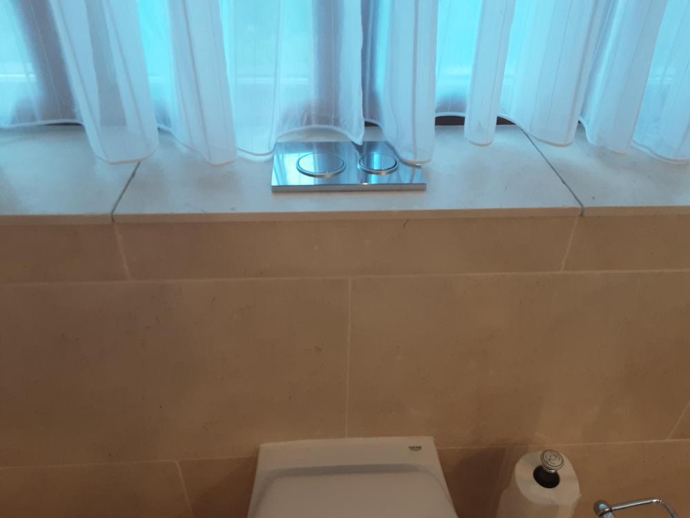

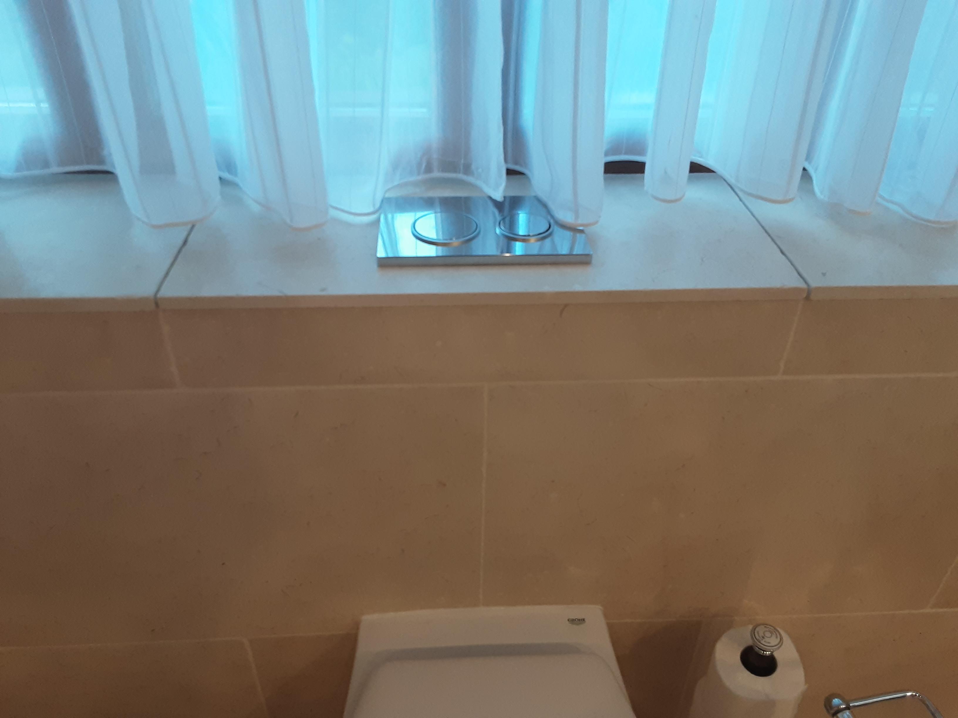

Temp Posted July 23, 2023 Share Posted July 23, 2023 Regular grout can be raked out but it's not super easy. There are grout removal tools. I have stone tile hatches over the cisterns in our bathrooms and just left them ungrouted. I suppose I could fill them with a strip of wood and a very thin layer of grout but haven't felt the need. 1 Link to comment Share on other sites More sharing options...
