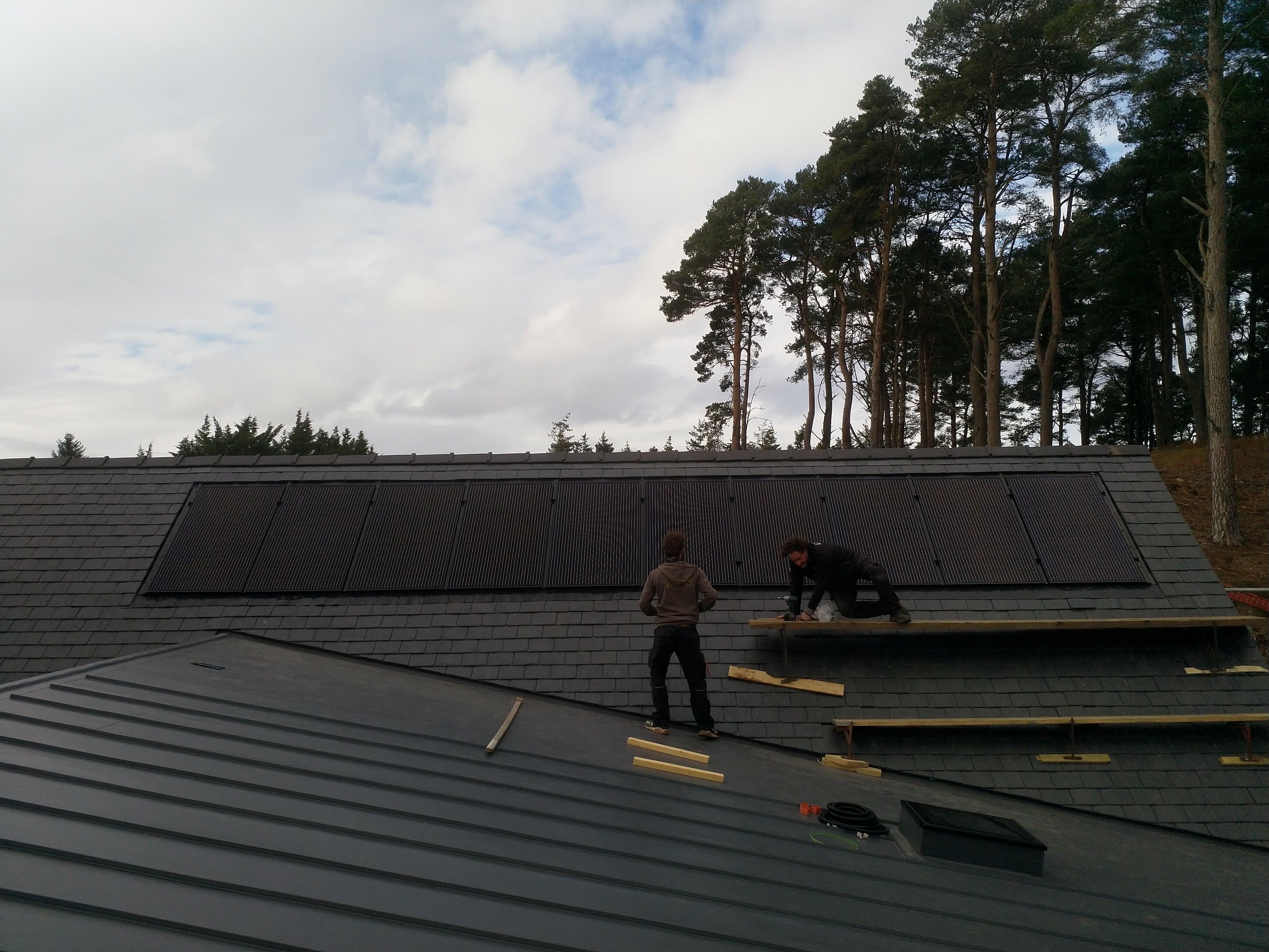

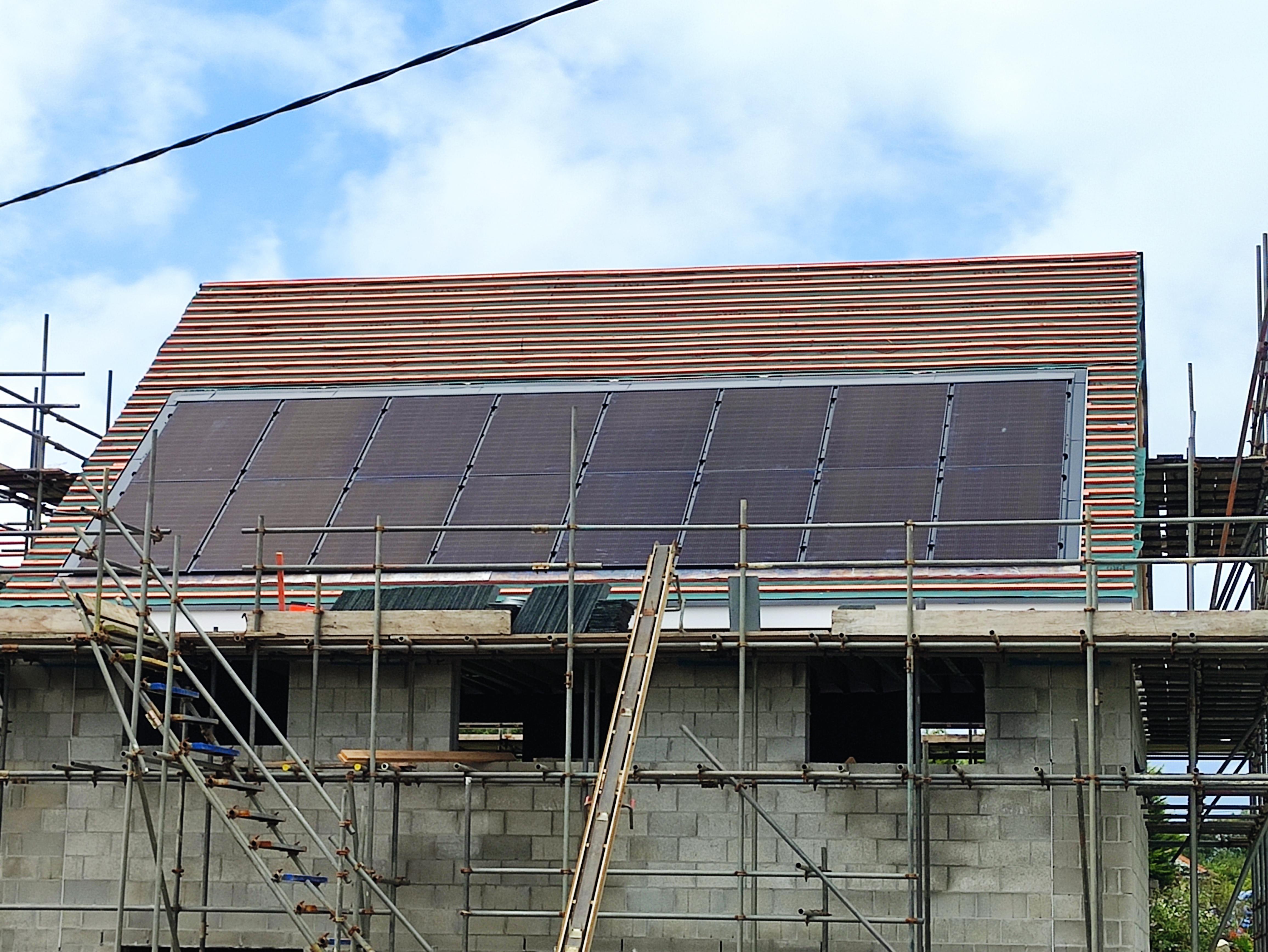

luke666 Posted July 22, 2023 Share Posted July 22, 2023 Hi, I can't figure out if I need to earth panels if they are sat on GSE plastic panels? If so how do I size the cable? Any help from people with GSE inroof would be much appreciated?? Thanks Luke Link to comment Share on other sites More sharing options...
SteamyTea Posted July 22, 2023 Share Posted July 22, 2023 I have replied to your other post about this. Link to comment Share on other sites More sharing options...
JohnMo Posted July 22, 2023 Share Posted July 22, 2023 I used 6mm2 earth from each panel Link to comment Share on other sites More sharing options...
luke666 Posted July 22, 2023 Author Share Posted July 22, 2023 That's with GSE Panels? Where did you rin it too? Did you go panel to panel? Link to comment Share on other sites More sharing options...
JohnMo Posted July 22, 2023 Share Posted July 22, 2023 Panel to panel and then to ground. If you zoom in enough you can just see the earth between the panel at the top Link to comment Share on other sites More sharing options...

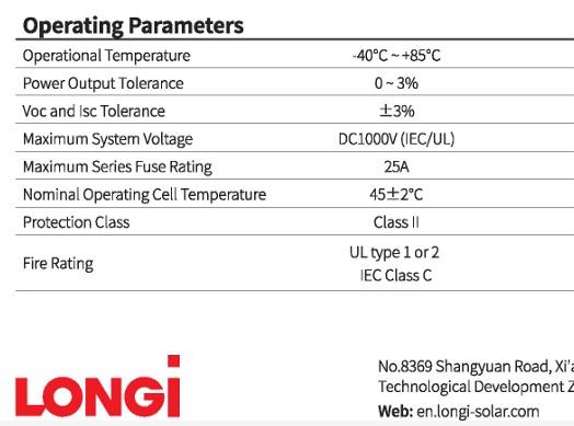

Jenki Posted July 23, 2023 Share Posted July 23, 2023 Longi panel installation manual require ,grounding see section 7. Link to comment Share on other sites More sharing options...

Jenki Posted July 23, 2023 Share Posted July 23, 2023 11 minutes ago, SteamyTea said: Is that for ground mounted only though? It is hard to find information on this. I think, if it is grounded/earthed, then it needs an earthing rod and not connected to the house earth. Last thing you want is 1000V of DC going up the neutral line. Just found this BRE document. Page 22 https://files.bregroup.com/solar/Guide_to_the_installation_of_PV_systems_2nd_Edition.pdf QUOTE: " In design of modules, the anodized corrosion resistant aluminum alloy frame is applied for rigidity support. For safety consideration and to protect modules from lightning and electrostatic damage, the module frame must be grounded. The grounding device must be in full contact with inner side of the aluminum alloy and penetrate surface oxide film of the frame. Do not drill additional grounding holes on module frame. The grounding conductor or wire may be copper, copper alloy, or any other material acceptable for application as an electrical conductor per respective National Electrical Codes. The grounding conductor must then make a connection to ground with a suitable ground electrode. Holes marked with a grounding mark on the frame can only be used for grounding but not for mounting. Frameless double glass modules have no exposed conductor, and therefore according to regulations it did not need to be grounded. Grounding methods below are permissible 1 Grounding by grounding clamp There have grounding holes with the diameter of Ø4.2 mm at the edge location of module's back-side frame. And the grounding holes are identified with typical grounding symbol according to IEC61730-1 standard. Grounding between modules shall be confirmed by qualified electricians and grounding devices shall be manufactured by qualified electric manufacturer. The torque of copper core wire used for the grounding clamp is recommended to be 2.3 Nm. 12 AWG. And copper wires cannot be pressed during installation in case of damaging. 2 Grounding by unoccupied mounting holes Mounting holes on modules that are not occupied can be used for installing grounding components. ◆ Align grounding clamp to the frame mounting hole. Use grounding bolt to go through the grounding clamp and frame. ◆ Put the tooth side of the washer on the other side and fasten the nuts. ◆ Put grounding wires through the grounding clamp and grounding wire material and dimension shall meet requirements in local national and regional law and regulations. ◆ Fasten bolts of grounding wires and then installation is completed. " My reading of this is they (Longi) need earthing. Link to comment Share on other sites More sharing options...
SteamyTea Posted July 23, 2023 Share Posted July 23, 2023 Just now, Jenki said: My reading of this is they (Longi) need earthing. Maybe they are not Class2. It is, as I said earlier, hard to get to the bottom of this. Anyone got the latest copy of BS 7430, BS 6651 and BS 7671. Link to comment Share on other sites More sharing options...
billt Posted July 23, 2023 Share Posted July 23, 2023 3 minutes ago, Jenki said: per respective National Electrical Codes. Tells me that those instructions are aimed at the US market. They have different rules re earthing to us and seem to demand earthing of PV panels. Link to comment Share on other sites More sharing options...
Jenki Posted July 23, 2023 Share Posted July 23, 2023 They Are Class 2, so its confusing / conflicting Link to comment Share on other sites More sharing options...
