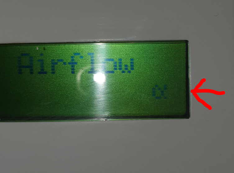

Andehh Posted July 28, 2023 Posted July 28, 2023 I changed our boost to 50% and left it at 60% humidity for now. I did/do have an issue where it randomly does full boost during the night, despite no settings calling for it... Remote digital display had a c3 showing when it did this which the VA tech team couldn't help with explaining why...

Andehh Posted July 28, 2023 Posted July 28, 2023 It's difficult to tell....as we have a lot of big sliders which we like to keep open. It only seems to occur middle of the night & always with a ' c3 ' displayed in bottom right hand corner which doesn't appear on any of the other boost modes..... 1
Blooda Posted July 31, 2023 Posted July 31, 2023 On 28/07/2023 at 15:35, Andehh said: It's difficult to tell....as we have a lot of big sliders which we like to keep open. It only seems to occur middle of the night & always with a ' c3 ' displayed in bottom right hand corner which doesn't appear on any of the other boost modes..... Expand Are you sure it's "C3" or is the fishy looking symbol, which indicates humidity boost is on? 1
Andehh Posted August 1, 2023 Posted August 1, 2023 (edited) Thanks blooda, yeah...whikst bleary eyed a couple times in the middle of the night, I am sure it said c3. Edited August 1, 2023 by Andehh
Blooda Posted August 1, 2023 Posted August 1, 2023 So - now we know it is the humidity control sensor. There are two ways the boost will come on [if you do not have an external sensor attached] - 1 is if the humidity increases above the set amount, the other is a sharp increase in humidity. So random questions, does anyone take showers in the night ? or does anyone Vape in the house, both may set off the boost. [Note:- I have no proof what so ever the vaping would set it off, it's only a theory] How's it been since you set it to 68% ?
