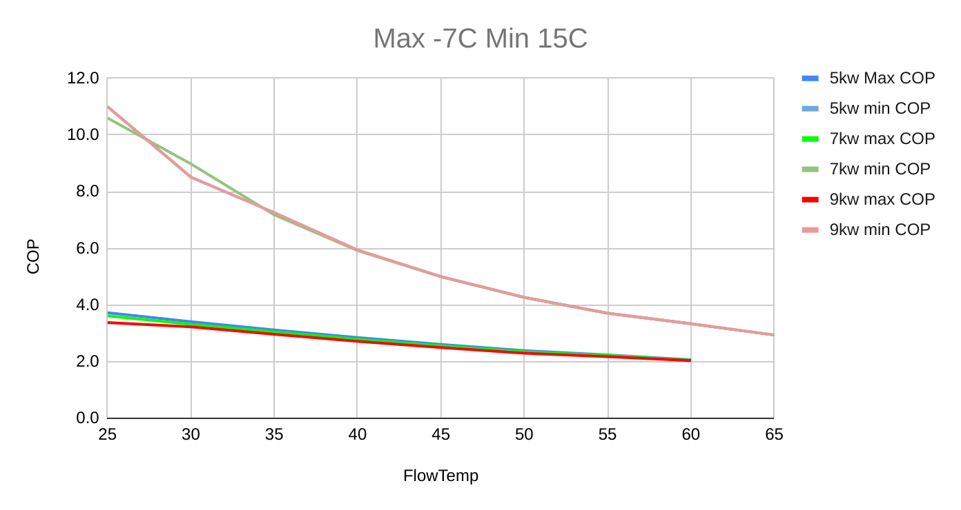

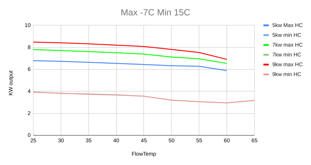

Beelbeebub Posted July 28, 2023 Author Share Posted July 28, 2023 Had a bit of a dig, it appears the 5, 7, 9, 12, 14 and 16kw units are externally identical and all use the same hydraulic module (water pump, PHX etc) They also share fans, fan motors and (interestingly) evaporator/condenser coils. The 5, 7 and 9kw units are identical except for charge. The 12, 14 and 16kw units are identical except for the charge The differences are the compressor, expansion valve and 4 way valve (as you would expect). The units seem to be complete monoblocks so everything except 3 way valve and controls is in the box. Some other brands need external expansion vessels (Grant) or pumps (Samsung). York are a big wheel in the commercial refrigeration and air con world, particularly in the US and are part of Johnson Controls (hence the control units being seen elsewhere) The units are apparently made by an OEM exclusively to York design and spec. Link to comment Share on other sites More sharing options...
Beelbeebub Posted July 28, 2023 Author Share Posted July 28, 2023 As an addendum to the post above, it's interesting the 5-9kw units and 12-16kw units are identical except for charge. This opens up the possibility of just holding 5-9kw and 12-16kw units at suppliers and then adjusting the charge on site. If the refrigerant were r290 the units could be supplied fully charged and then adjusted down to suit the property by simply bleeding (in a safe manner of course) the excess charge out during commissioning. Likewise, some careful monitoring over the first few years might be able to recommend up or down charging the system, which could be done at the next annual service. If the heatloss calculations were way out and the unit was too big/small despite charge adjustment the fact they are externally identical means the whole unit could be part exchanged for a bigger/smaller unit as required. Of course the dream would be to get the 5-16kw range (which would do most houses in the UK) into a single machine with and adjustable charge. That would massively simplify the logistics and manufacturing, hopefully making things cheaper. Link to comment Share on other sites More sharing options...

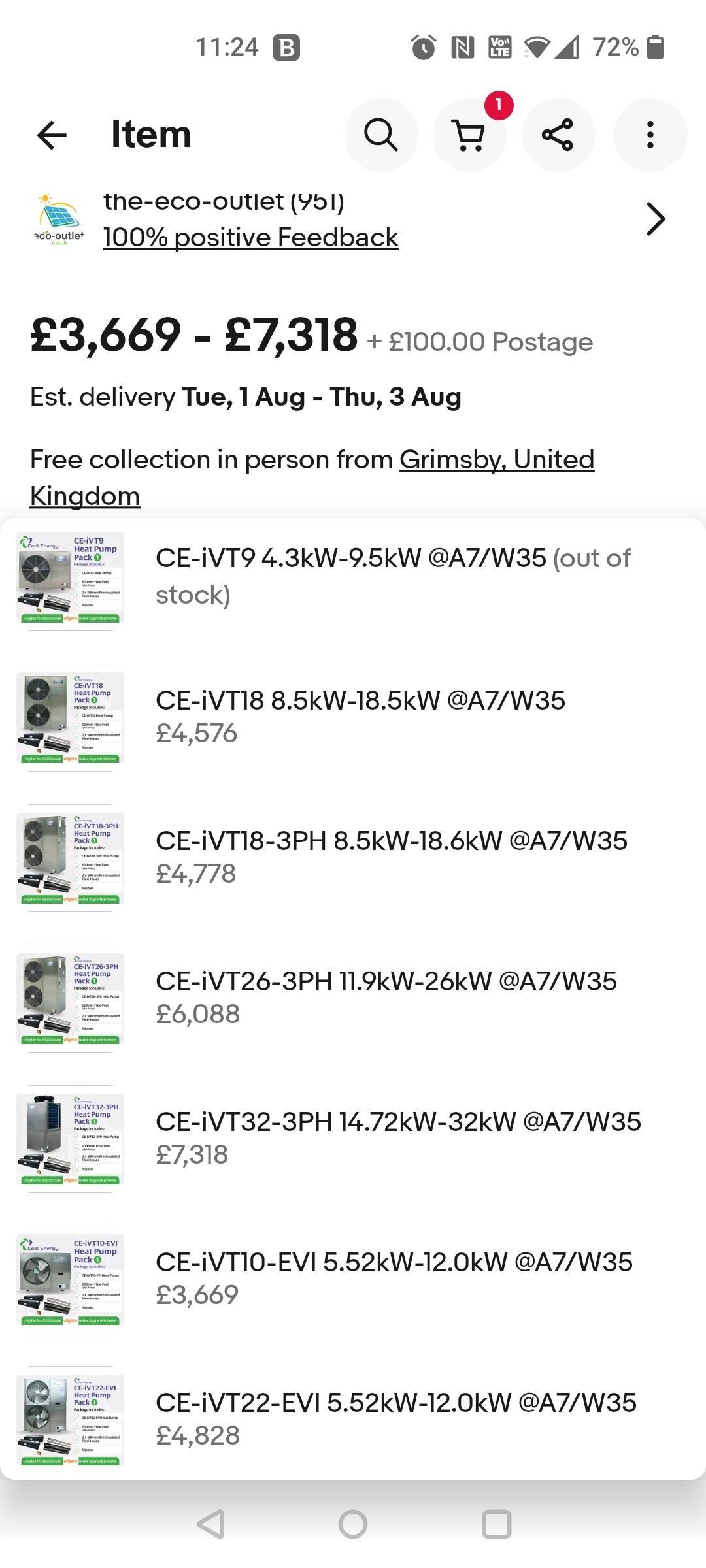

JamesPa Posted July 28, 2023 Share Posted July 28, 2023 38 minutes ago, Beelbeebub said: Of course the dream would be to get the 5-16kw range (which would do most houses in the UK) into a single machine with and adjustable charge. That would massively simplify the logistics and manufacturing, hopefully making things cheaper. That's probably over optimistic, but two models with some overlap would be nearly as good. 5-12 and 9-16 for example. Link to comment Share on other sites More sharing options...
JohnMo Posted July 28, 2023 Share Posted July 28, 2023 Cool energy already have that built in to their range of heat pump, with plenty of overlaps. Link to comment Share on other sites More sharing options...
JamesPa Posted July 28, 2023 Share Posted July 28, 2023 7 minutes ago, JohnMo said: Cool energy already have that built in to their range of heat pump, with plenty of overlaps. I had always read this as min op modulated down - max op, not as an adjustable higher end. Am I reading it wrongly. Link to comment Share on other sites More sharing options...
JohnMo Posted July 28, 2023 Share Posted July 28, 2023 Maybe I'm reading it incorrectly. Makes sense that it's min max modulating range Link to comment Share on other sites More sharing options...

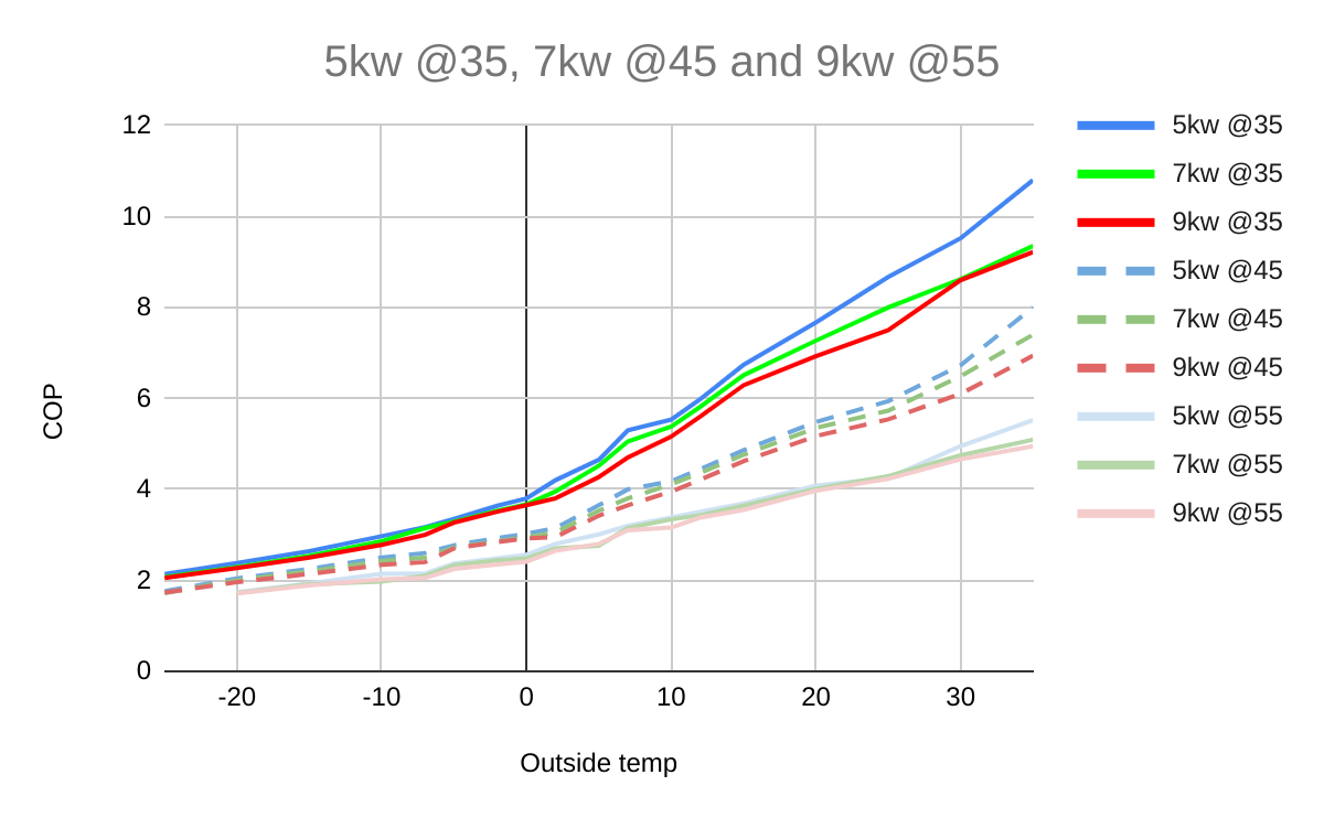

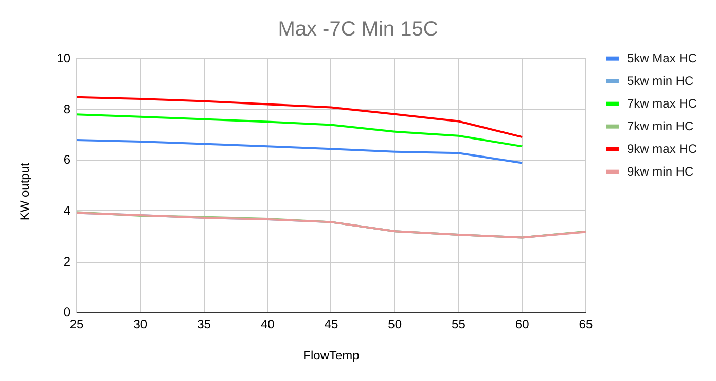

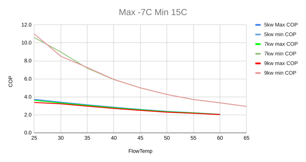

Beelbeebub Posted July 28, 2023 Author Share Posted July 28, 2023 so more digging.... I've looked at the 5,7,9 kw machines as they appear to be identical except for the charge. This is specific to the York units but i suspect most modern r32 units are similar, it just depends where the manufacturers draw the line building different machines vs just tweaking the charge and control of an existing machine. I then took -7 as the coldest outside temp where you would want to be working at max power (regardless of your flow temp) Then 15C as a nominal point where you would want to be at minimum power as your barely need to heat the house. Then I graphed the max/min power outputs for each of the 3 units So it looks like the lower bound of modulation is the same regardless. You don't get any advantage of lower modulation by going for the "smaller" unit. I thin looked at COP at those extremes. In this case the COPs are pretty much the same. There is a small difference at the lower flow temperatures but by the time you get past 35C they are near identical. So far it looks like the only disadvantage of going for the bigger unit is purchase cost and possibly the slightly larger electrical supply to the unit. The final area i looked at was the COPs for the nominal power rating at 35, 45 and 55 flow temps as you can see below about 15C there isn't much difference except maybe at 35C. For 55C there is almost no difference even out to 30C outside temp If you are after the ultimate efficiency and can run at very low flow temps (35C) and definitely don't need the higher powers when cold, so basically a good spec new build, you could get away with the 5kw and save some money up front and maybe get a little more efficiency. For anyone else I reckon oversizing isn't going to be an issue with these units. Link to comment Share on other sites More sharing options...
