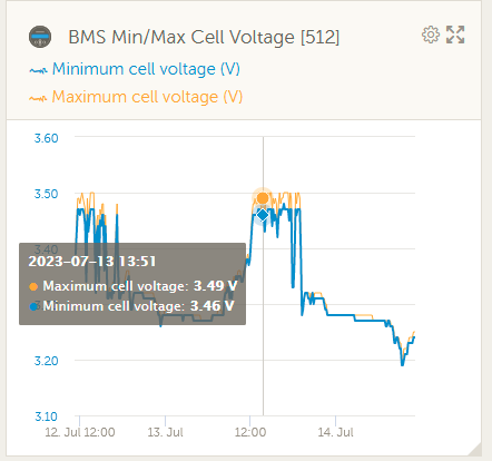

I have 3 modules (10.65 kWh) of Pylontech Force L2 and am quite happy with them. They have balancing in the BMS and the difference between min and max voltage is typically 30 mV or less.

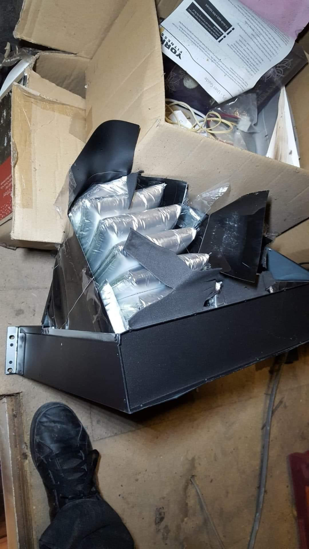

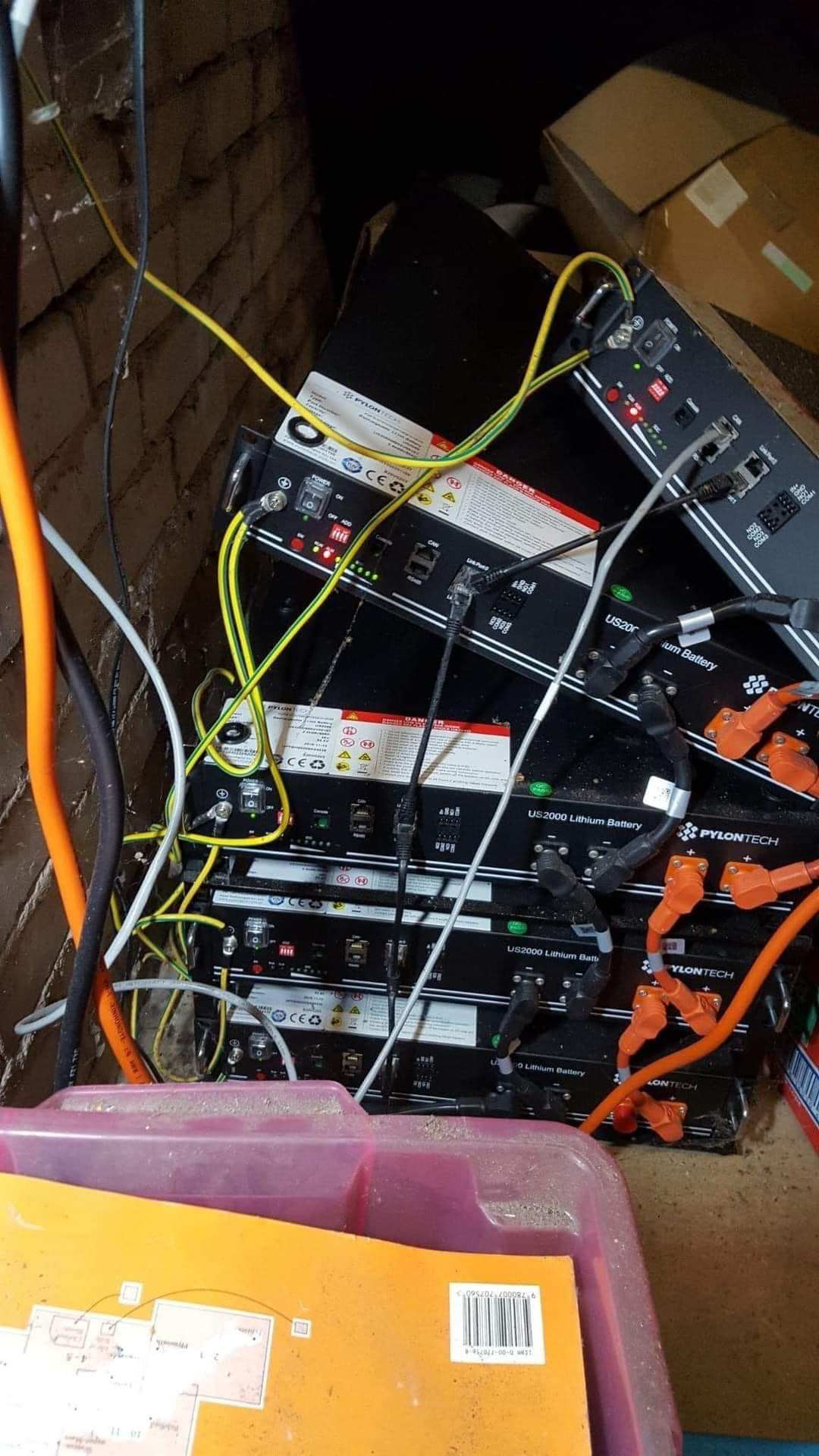

image.thumb.png.37f3946d31b6907da0838ba18c35a478.pngimage.thumb.png.c8861dde57c8831173f5918d256437ed.png
Yup. 👎
Yup. 👎
You can find lots of photos online of this type of accident, which happens to all types of batteries for all sorts of different reasons, mainly to do with incorrect installation and use.
So I'm not sure it's really justified to single out one particular make/model.
On VAT clearly suppliers are interpreting the law as meaning 0% is applicable when installed as part of a (pre-existing) solar system, and VAT'able only when "stand alone"
The point is valid if that manufacturer is charging multiples of cells without proper (or any) means of balancing. I've happily moaned about Makita battery packs dying early from this exact same issue, even though I own probably over £3k worth of Makita cordless and mains power tools.
