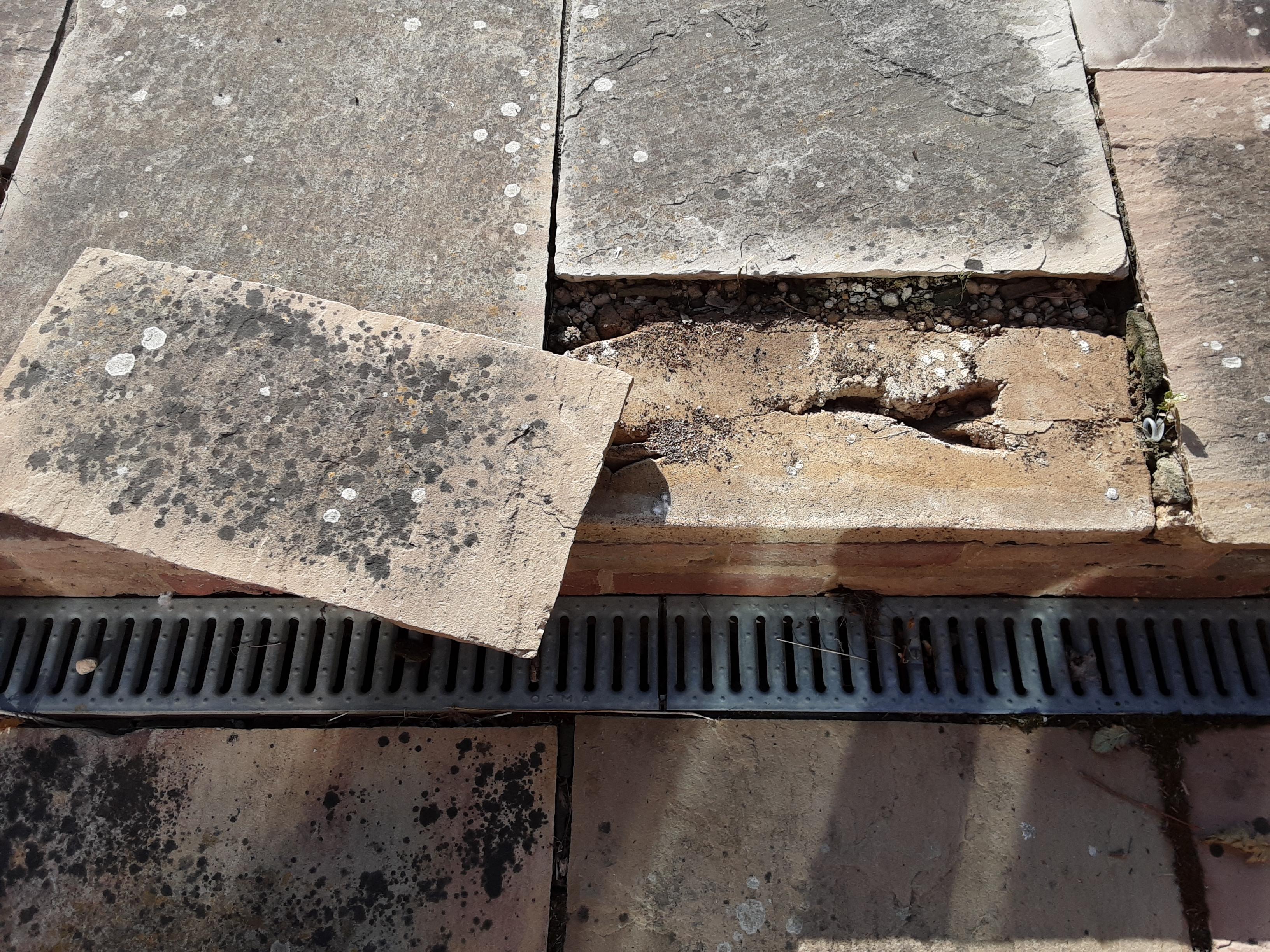

Temp Posted July 9, 2023 Share Posted July 9, 2023 1 hour ago, ToughButterCup said: Why has it taken 70 years for someone to tell me that ......🤔 I've started using Ultra Scape Pro Prime to repair loose india stone originally stuck with unknown slurry. Link to comment Share on other sites More sharing options...
saveasteading Posted July 9, 2023 Share Posted July 9, 2023 This need for an sbr primer on stone slabs is news to me. So I looked it up. BAL Bond SBR is also useful as a primer before tile fixing, providing extra protection for peace of mind. well, i don't think that is good enough. Somebody needs to say why the stone needs it. and what horrible things will happen if it isn't used. I'd think It will keep water inside the stone, if porous, making it more liable to frost damage. Link to comment Share on other sites More sharing options...
Temp Posted July 9, 2023 Share Posted July 9, 2023 Mortar just doesn't seem to stick to some stone very well without it. Not a great example but.. Link to comment Share on other sites More sharing options...
