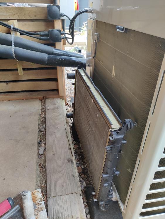

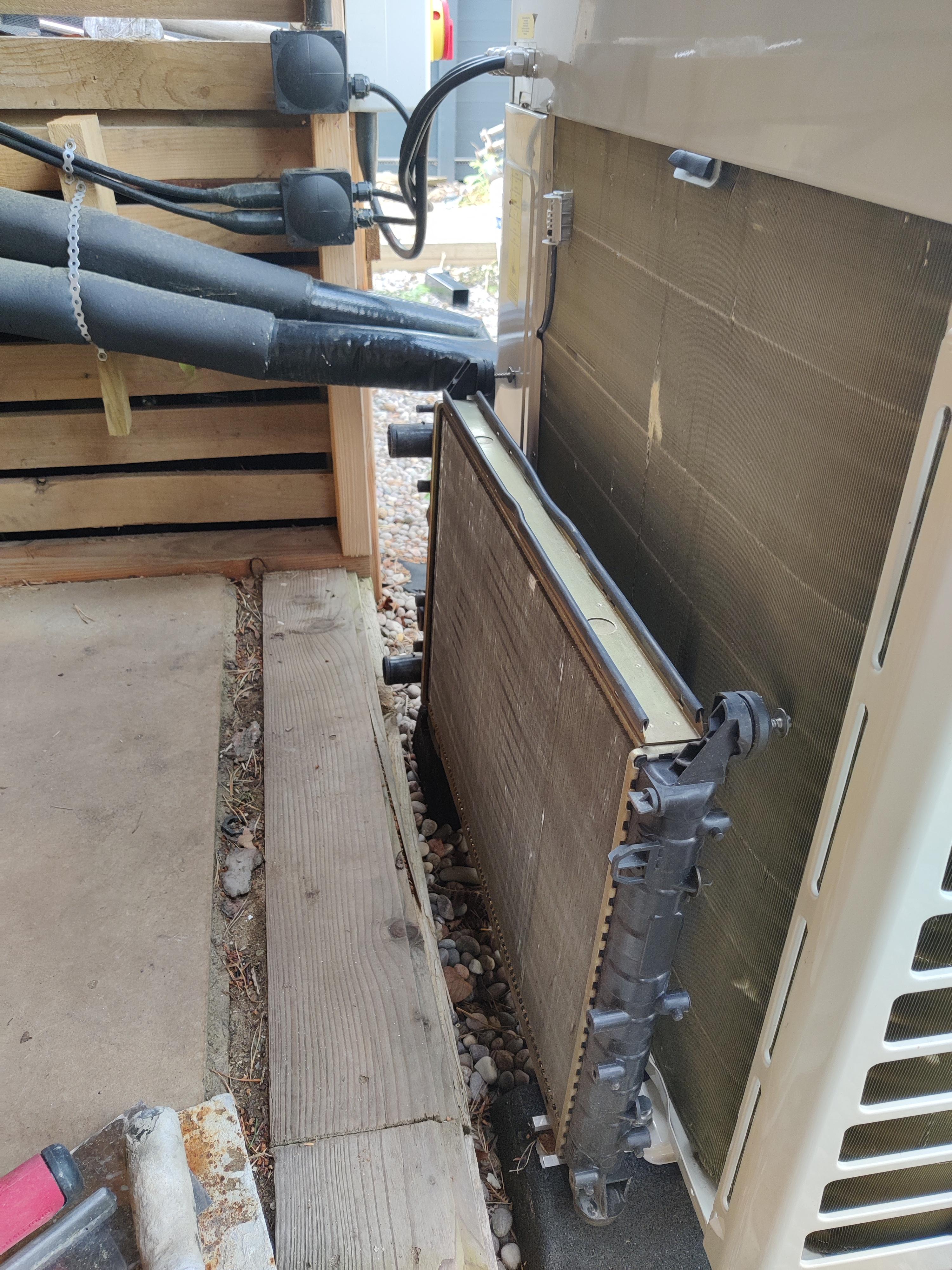

JohnMo Posted July 7, 2023 Author Posted July 7, 2023 The drain back unit has an inbuilt PHE. Had another thought about indirectly increasing CoP through air pre heating. Basically flow ST water through car radiator say behind ASHP. Something like the attached. Even though only part covering the ASHP condenser air is being pulled through the radiator.
JohnMo Posted July 7, 2023 Author Posted July 7, 2023 ST only needs to operate just above OAT with radiator, as long as get back more energy than the pumps being used it's a bonus. Looking at my CoP chart flowing at 30 degrees the difference between -2 and +2 is a drop of 300W. The pumps will pull around 30W each, there are two.

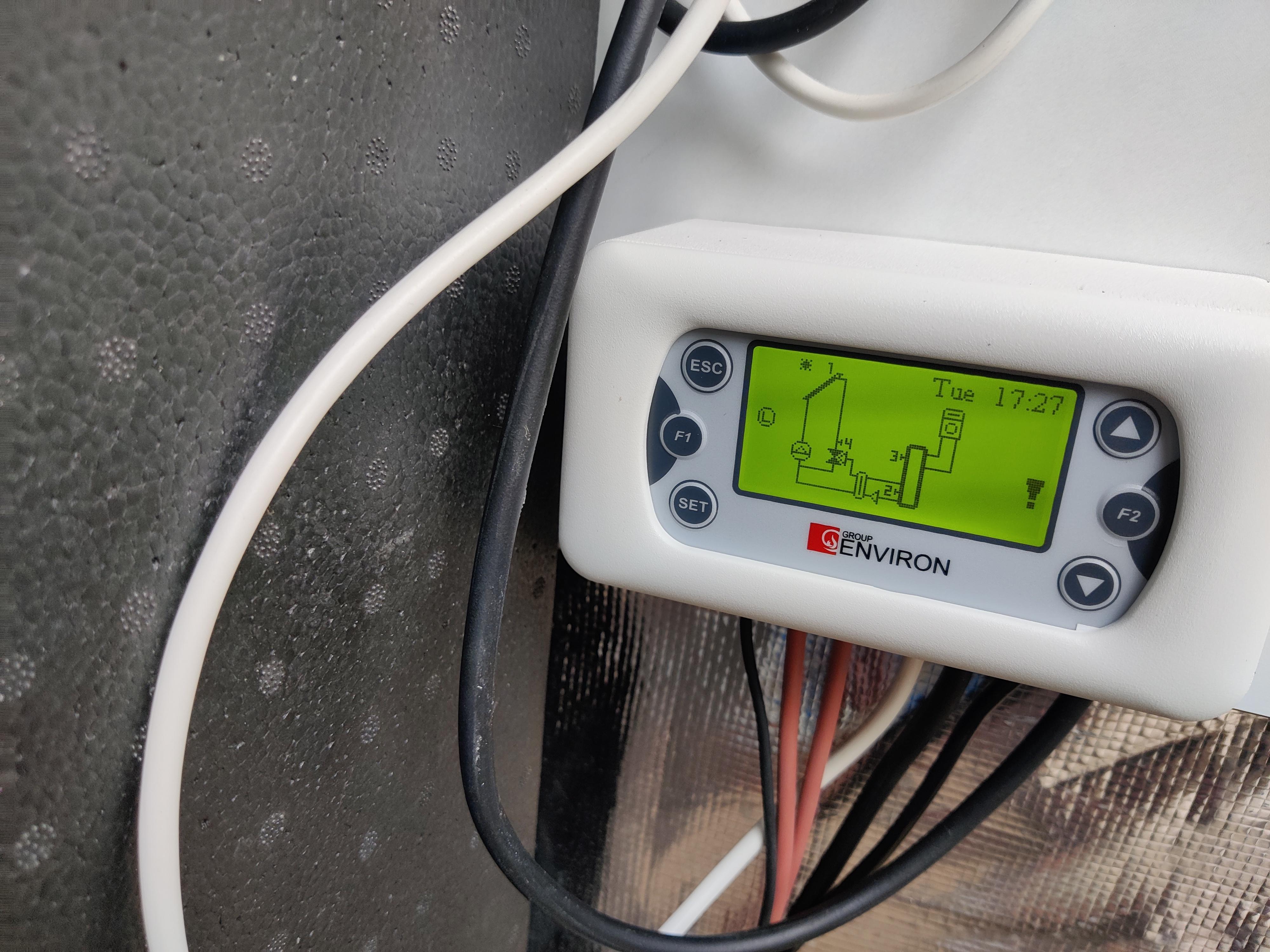

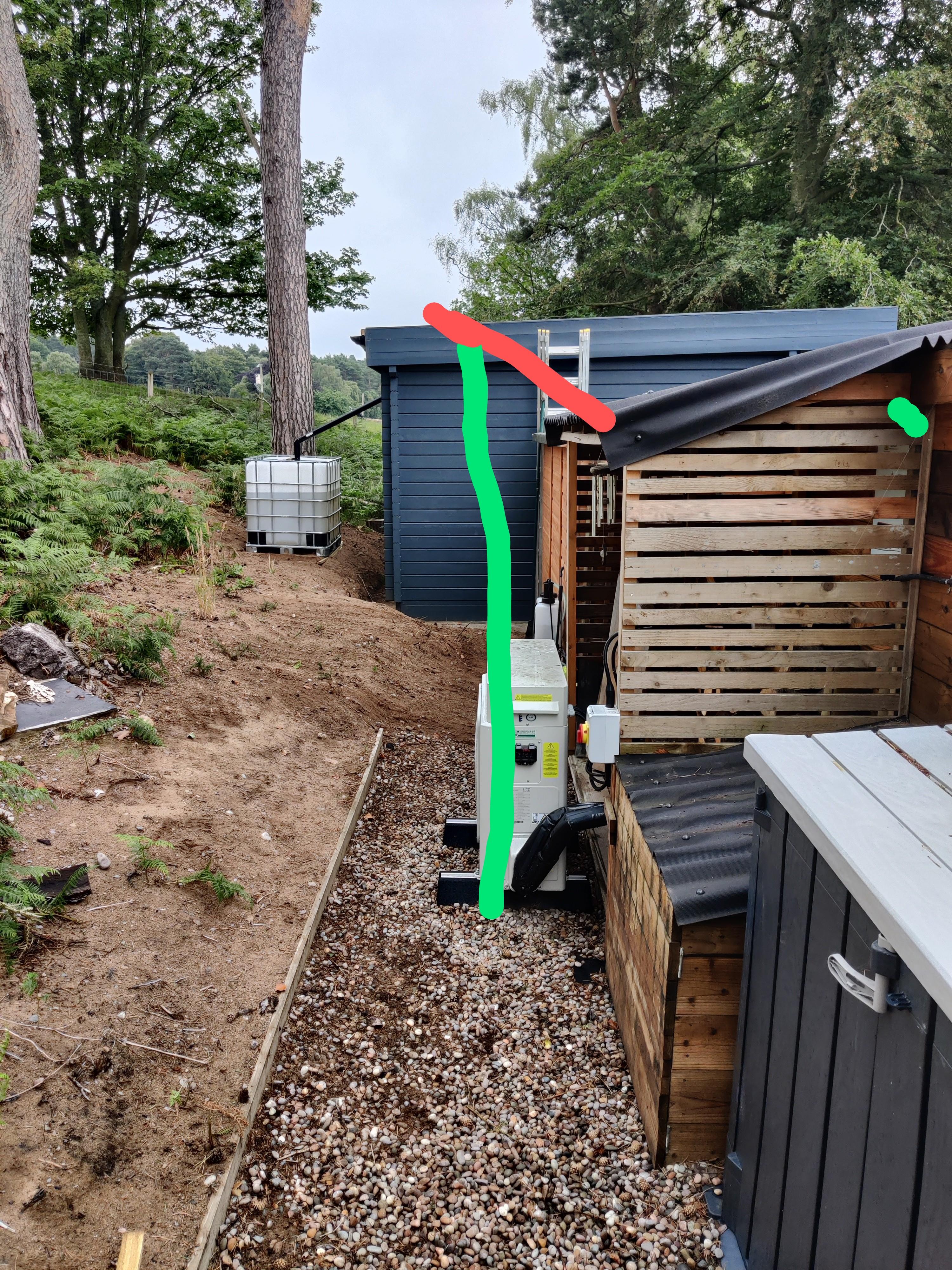

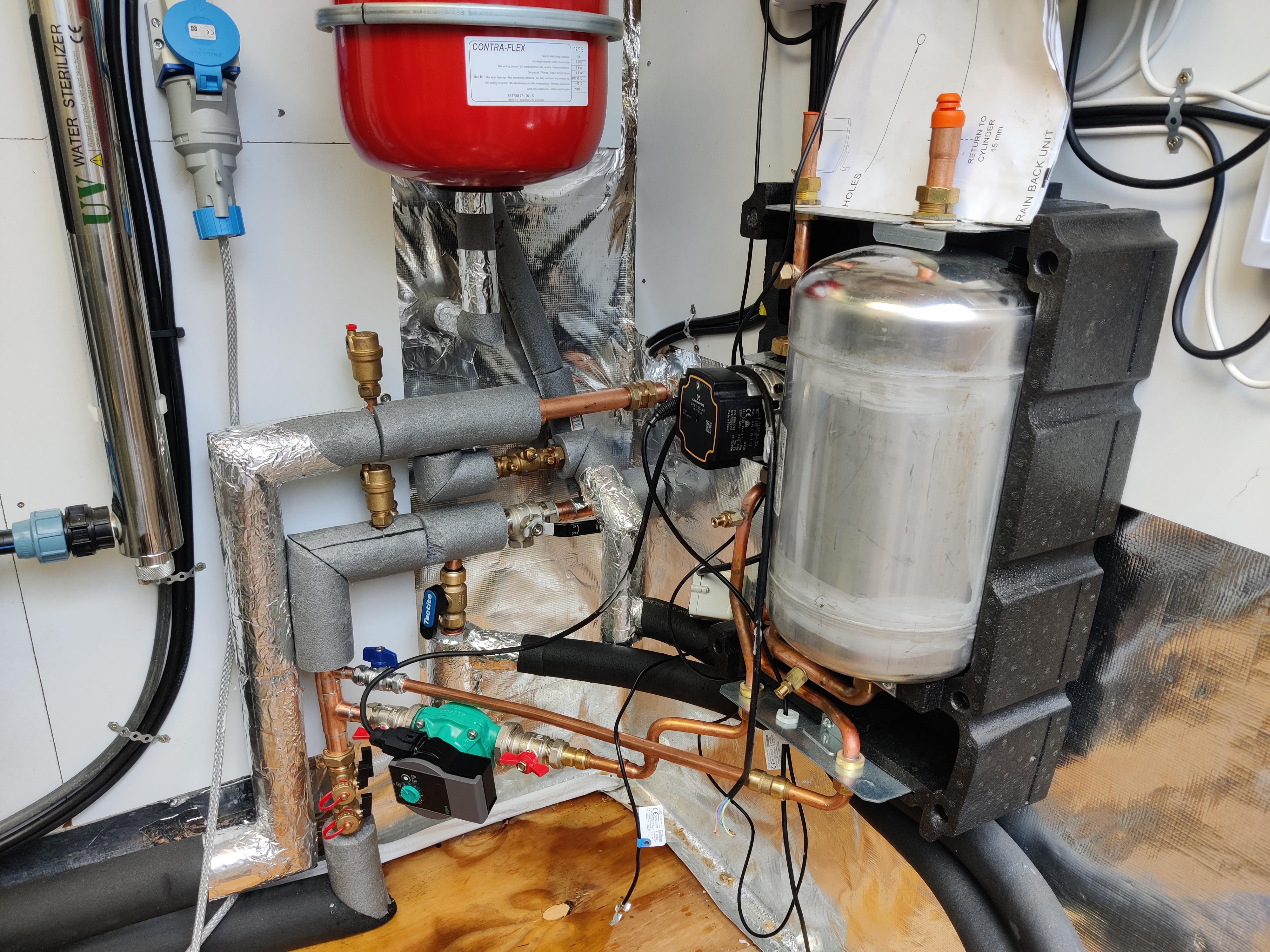

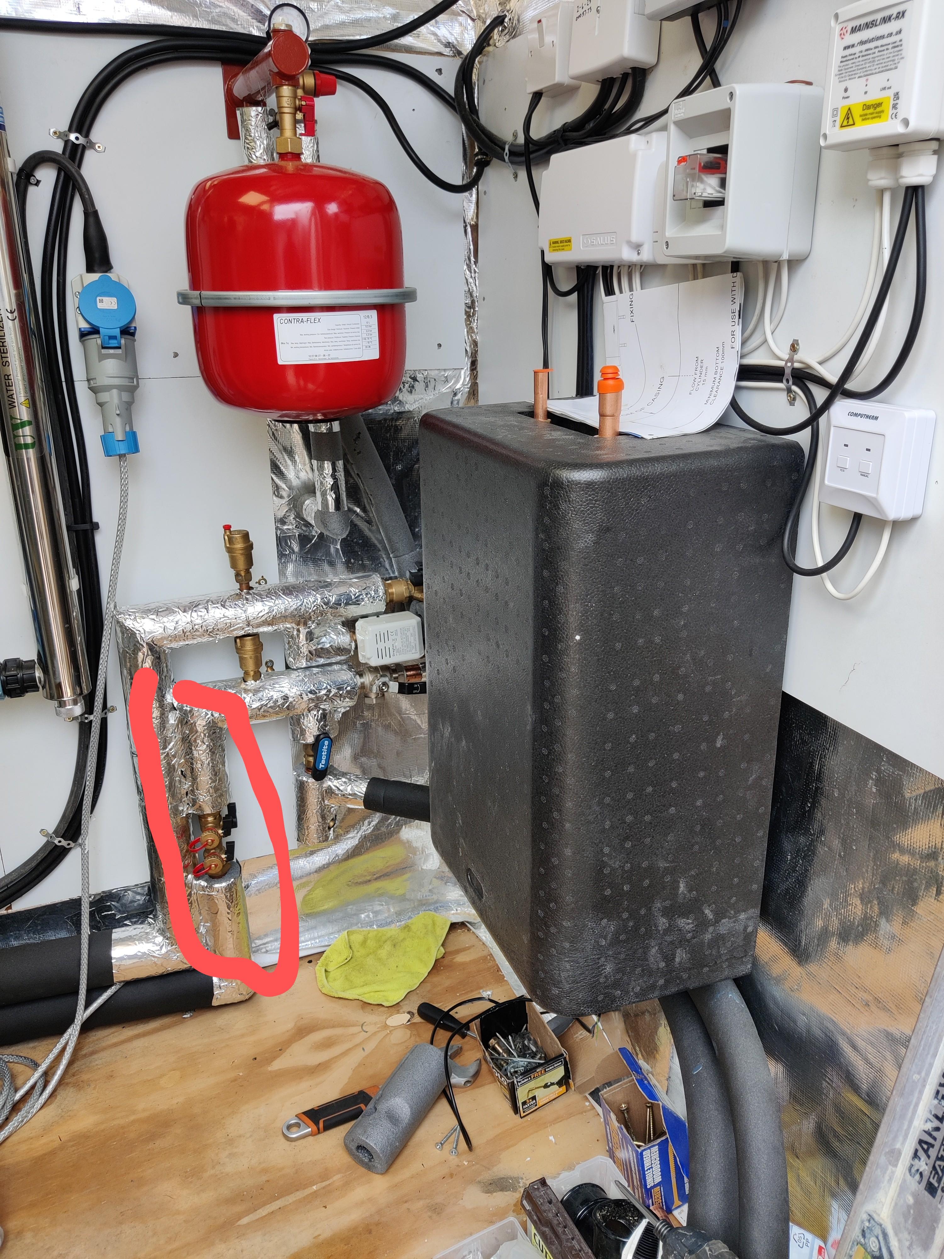

JohnMo Posted July 9, 2023 Author Posted July 9, 2023 Started to get things together. Will be using a CCT in the return pipe. Will use the solar controller, so it thinks the flow and return pipes are the top and bottom of a cylinder and set the temperature and hysterisis as required. Have mounted the drain back unit (black box), the pipes at the top connect to the solar panel and there are pipes at the bottom that will connect to the CCT. CCT will be located in the pipe section highlighted in red. Still need to figure out how to make the system to work during DHW heating and UFH heating, but be off in cooling mode - maybe some relay logic.🤔

JohnMo Posted July 10, 2023 Author Posted July 10, 2023 (edited) Solar panel will become a roof above my ASHP to keep the worst of the weather off it. The green dots are where the pipes will go through the wall to the drain back unit Edited July 10, 2023 by JohnMo Missed details 1

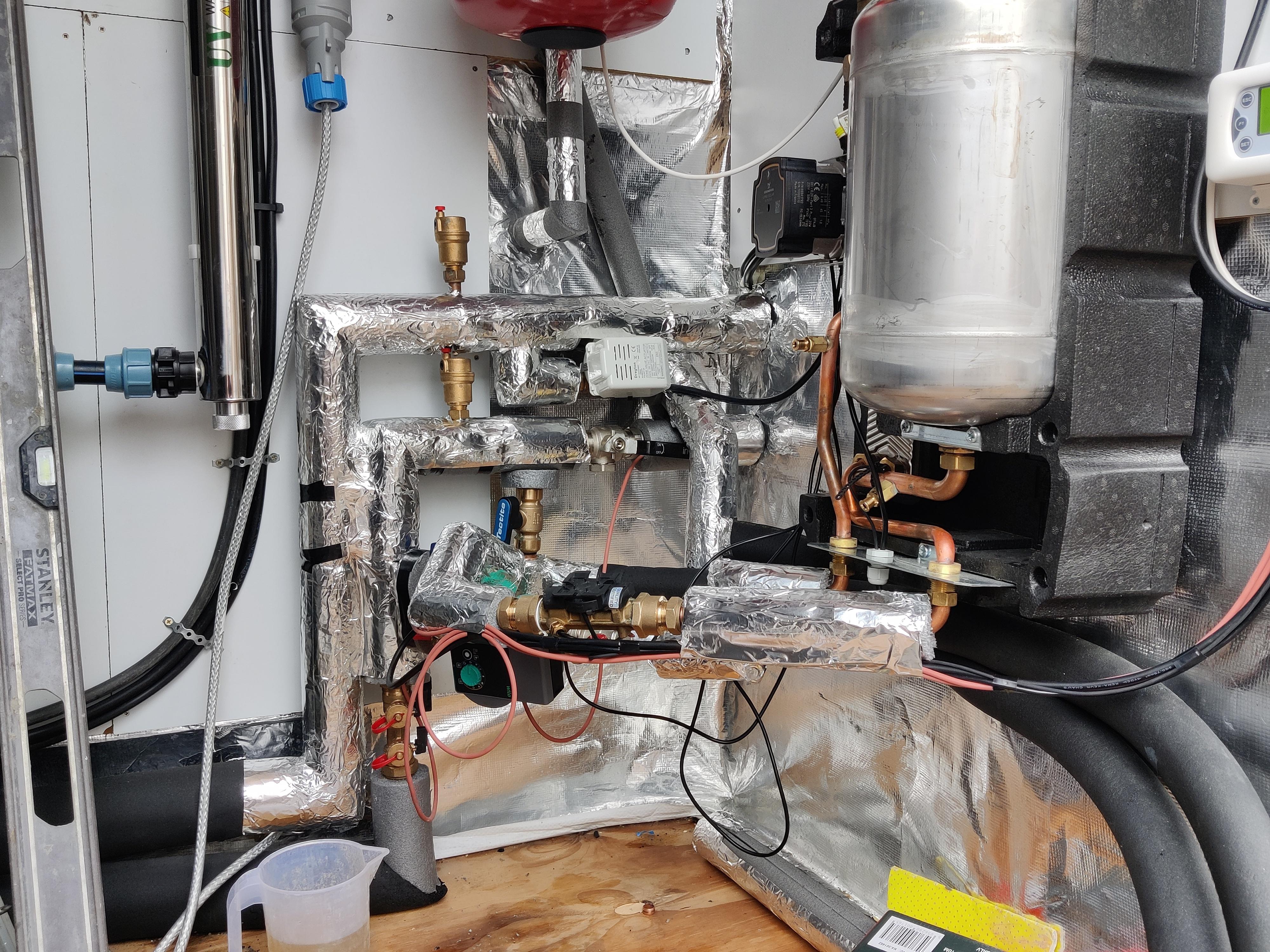

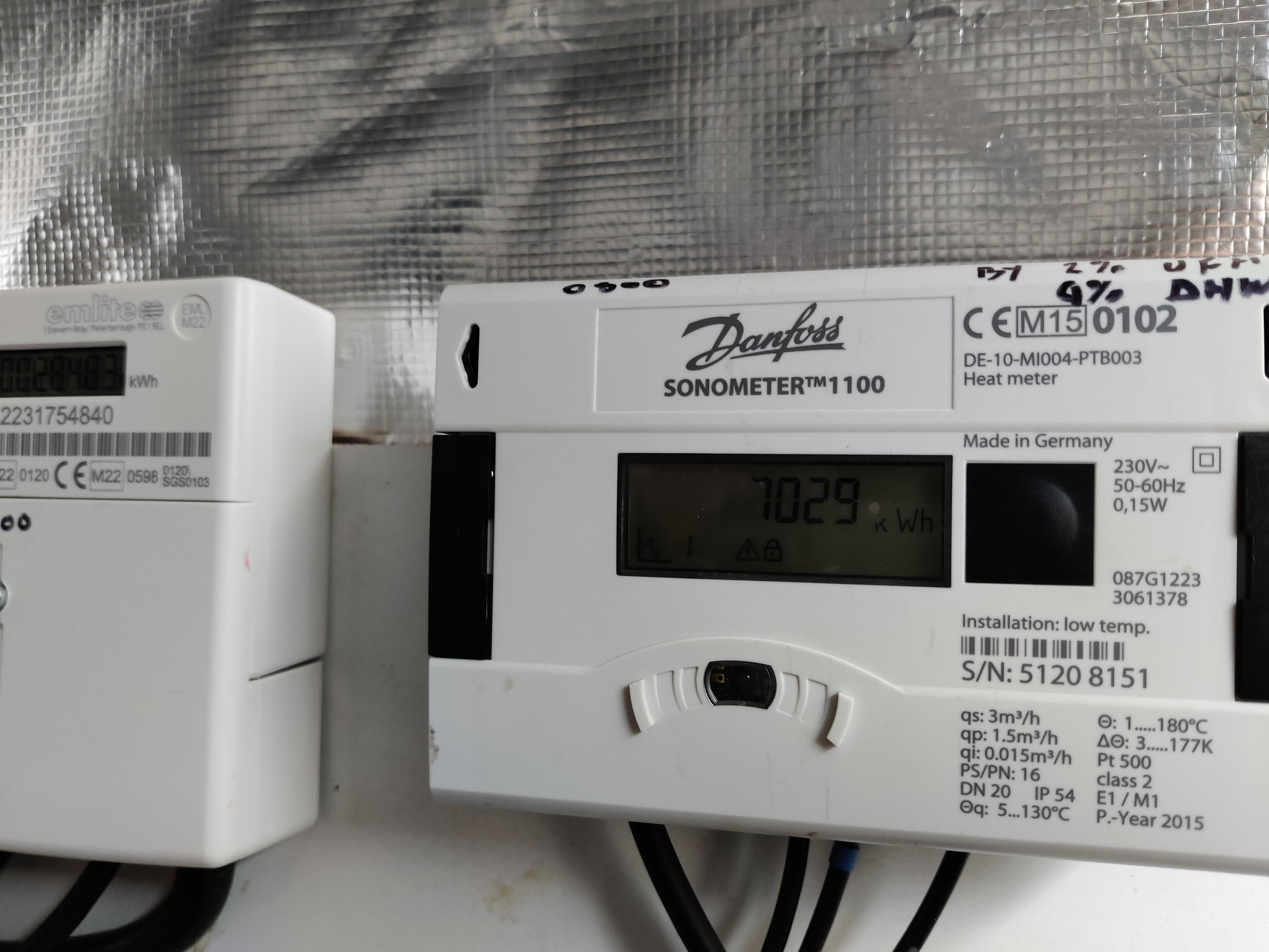

JohnMo Posted July 11, 2023 Author Posted July 11, 2023 Solar controller now installed. Still wires to tidy up. The control scheme has a PHE and two pumps, one each side of the PHE. To monitor heat given out by the thermal system, I will reconfigure the heat meter I had previously installed in the heating system. Will install in the pipe from the PHE to close coupled tee. I have glycol in the system and the heat meter will over read by circa 2%, which I can live with.
JohnMo Posted July 12, 2023 Author Posted July 12, 2023 Heat meter installed today, circulation pump run to get all air out of the system. Heat meter unit contains the flow meter and a hot water stream temperature probe, so is installed after the PHE. The cool water probe is installed downstream of the pump and upstream of the PHE. Solar controller has the cylinder bottom probe in the heating return line upstream of the close coupled tee. The top of cylinder probe is installed approx 0.5m after the close coupled tee. Need to get my head around the controller settings. Job for later. Had a play with pump flow rates. UFH flow is approx 1m3/h. Solar thermal pump can delivery the same flow though the close couple tee. But will have a proper test when solar panel is coupled up. Unistrut is being delivered tomorrow 3x 6m lengths of 41x41, £96 delivered. So a very good price. Will be moving to the framing next to hold the panel up.

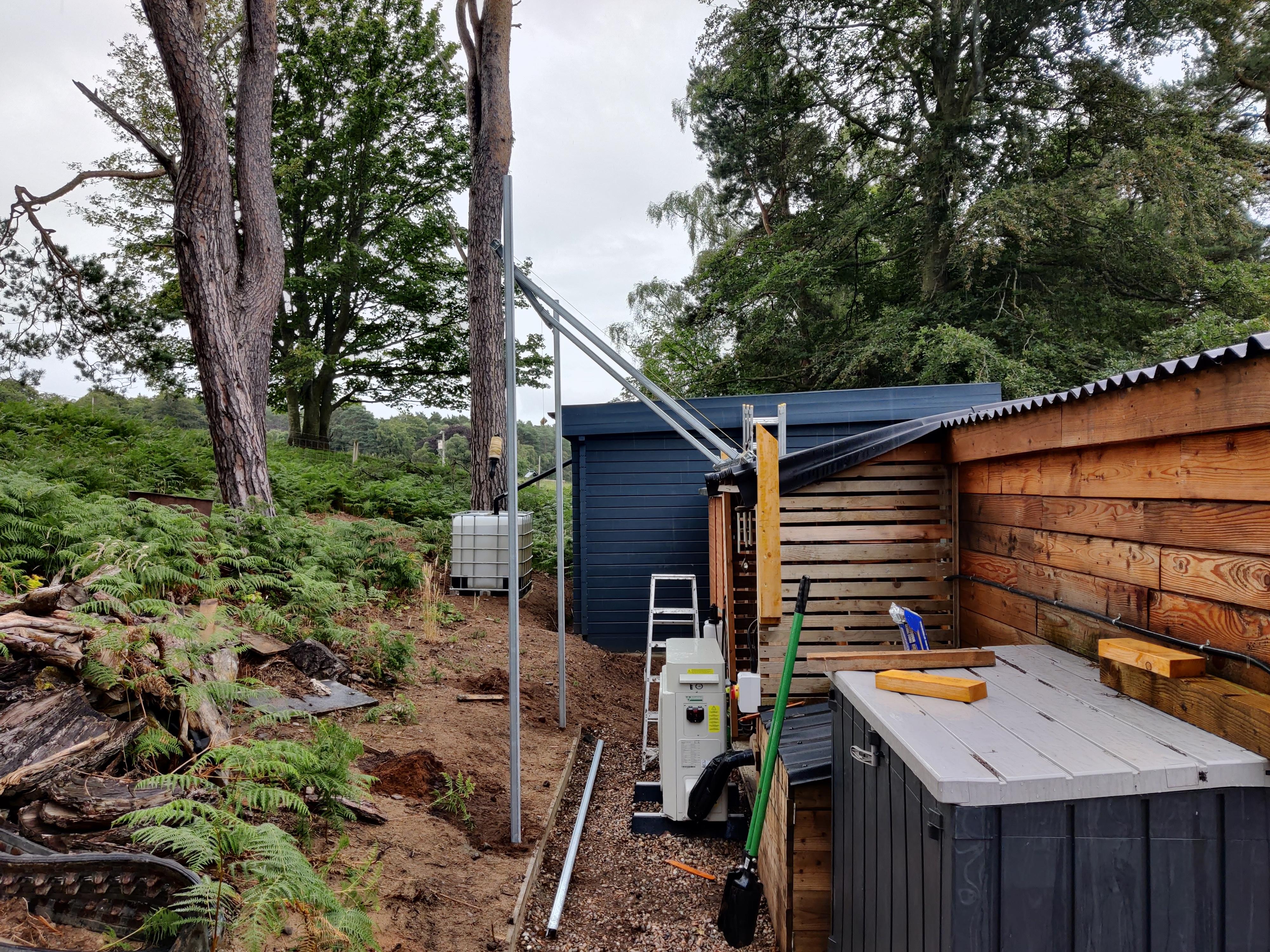

JohnMo Posted July 13, 2023 Author Posted July 13, 2023 Bit more progress today, support frame assembled, need to trim the ends off at top. Panel to mounted at 45 degs in landscape. All the frame materials cost £132, including panel mounts. Just got to figure out how to get the panel in place.
