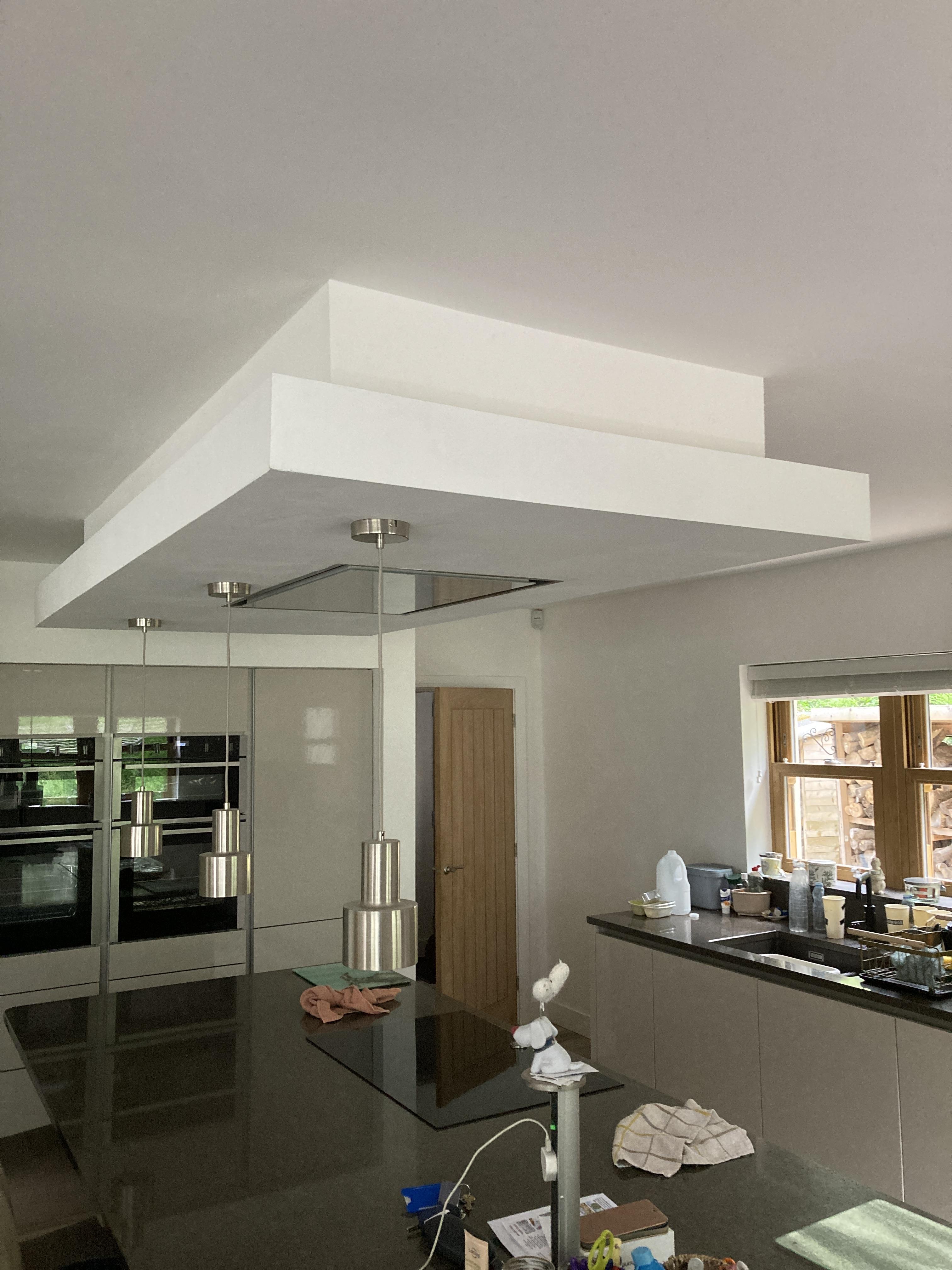

Owool12 Posted July 4, 2023 Share Posted July 4, 2023 Hi everyone! I’m wanting to build a dropped ceiling out of a wooden frame and attach to existing ceiling joists. However the ceiling joists are engineered I joists (with OSB web) and I’m struggling to identify the best way to hang the dropped ceiling from these. I understand attaching directly to the bottom flange is a big NO when it comes to I joists, does anyone have any suggestions of how to hang from these joists? Cheers Link to comment Share on other sites More sharing options...

Owool12 Posted July 5, 2023 Author Share Posted July 5, 2023 8 hours ago, Temp said: So how do you fix plasterboard to the underside of these for a normal ceiling? Sure that’s doable, but a dropped ceiling made of wooden studs, a 30kg extractor fan & plasterboard weighs a lot more than just ordinary plasterboard. I’ve heard about padding the OSB web with some plywoood & screwing through that with a joist hanger to hold a perpendicular joist… anyone any experience with doing that? Link to comment Share on other sites More sharing options...

Owool12 Posted July 5, 2023 Author Share Posted July 5, 2023 Thanks everyone for the insights. The extractor is 30kg so with the frame and other plasterboard it’s probably about 60kg at most. The load will only be spread across two joists, so that’s why I’m concerned at fixing directly to the bottom flange. I’m happy cutting out the ceiling plasterboard to access the web, but accessing it on both sides is a bit of a pain. Am I able to attach a wooden batten between the top and bottom flange then screw horizontally into the web perhaps? Link to comment Share on other sites More sharing options...

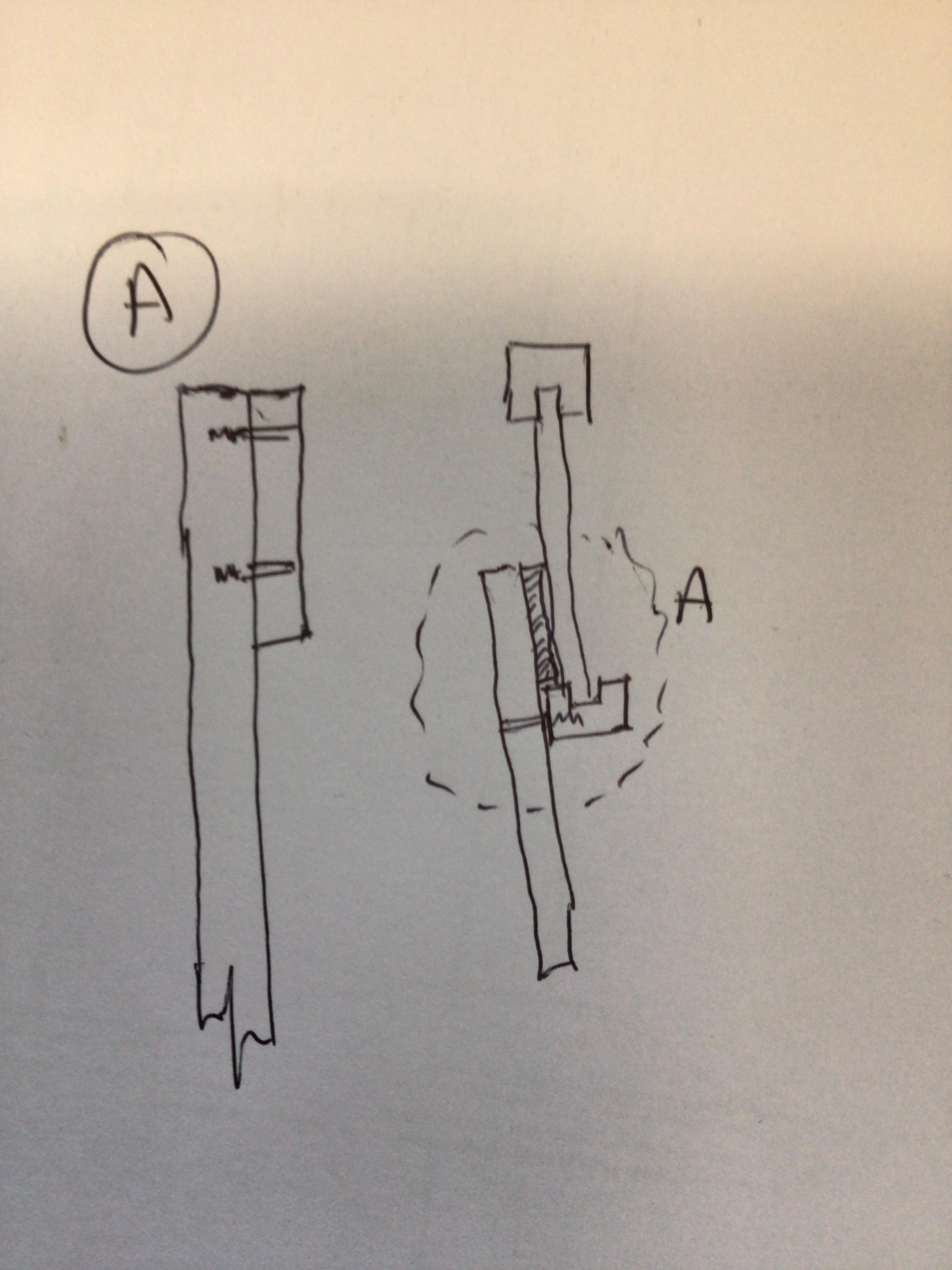

markc Posted July 5, 2023 Share Posted July 5, 2023 Overkill for the loads you are talking about but a hockey stick would mean you only need a small screw fix into bottom cord while the load is taken on the top face of the bottom cord. 2 Link to comment Share on other sites More sharing options...
Owool12 Posted July 5, 2023 Author Share Posted July 5, 2023 Cheers for the diagram, I agree I probably would get away with screwing into the bottom flange but I’m reluctant to do so just on the basis that it’s strongly advised against… ultimately damaging/splitting/cracking a joist is a huge problem I don’t want to encounter. I like both those ideas, keeps it relatively simple. Another approach I was considering was screwing some plywood to the inside of the OSB and then using a face fix joist hanger to run a 2x3 joist between: 2 Link to comment Share on other sites More sharing options...
joe90 Posted July 5, 2023 Share Posted July 5, 2023 Frankly you have to do what you feel comfortable with mate. That’s a good idea above with the hangers, just bring them lower so the 3x2 bottom edge is level with the bottom of the lower chord. 2 Link to comment Share on other sites More sharing options...
