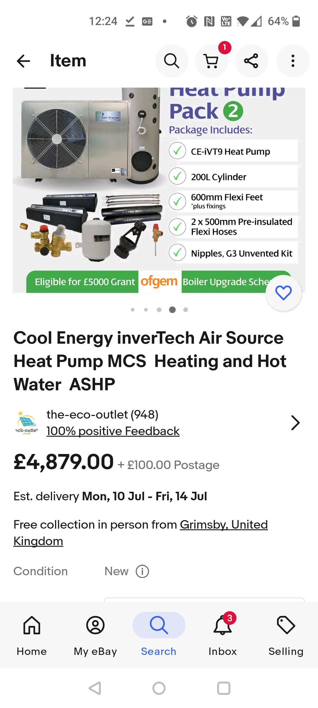

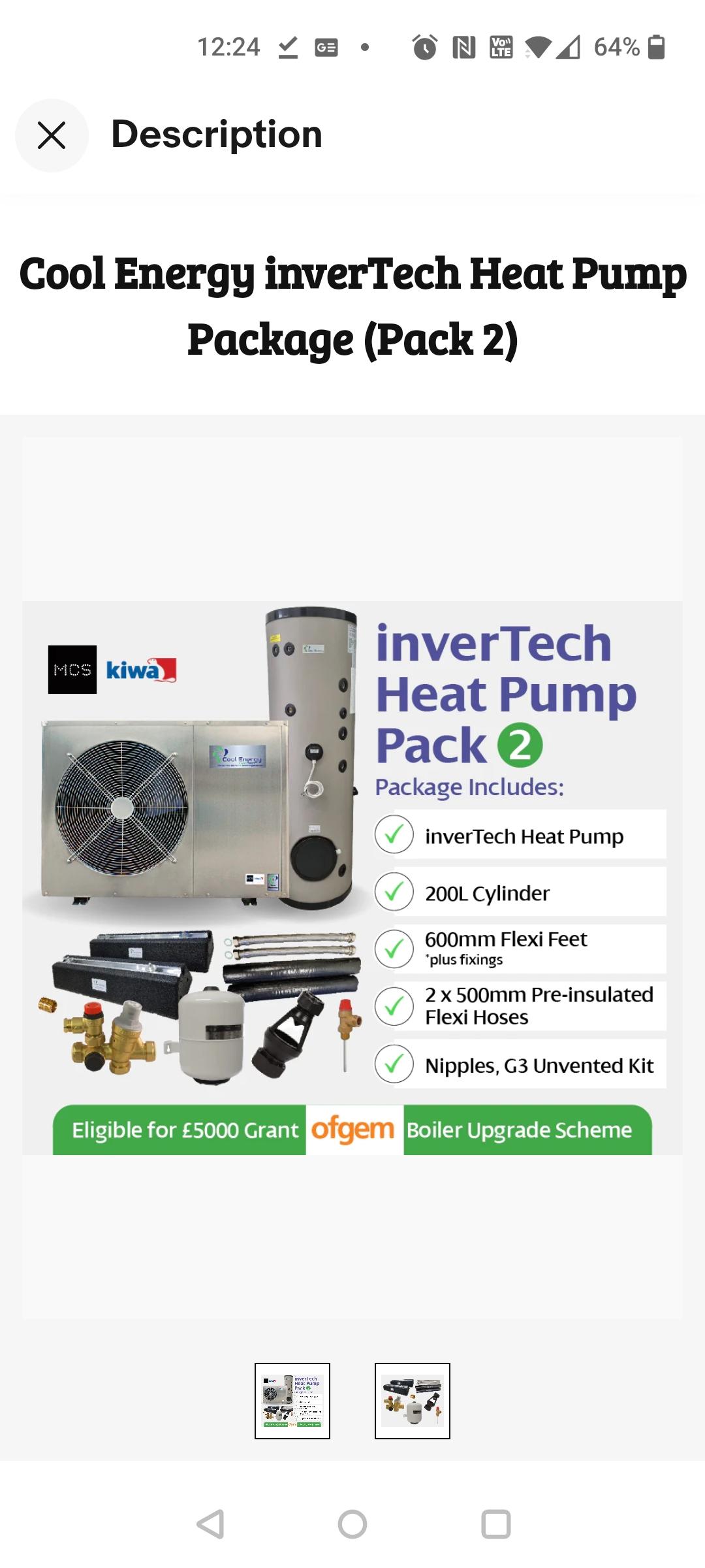

So just out curiosity had a look about for pricing. Quite a few members have and speak highly of Cool Energy ASHP.
So on eBay I spotted this package - this will be a vat included price, so you should be able to claim any Vat back as you are doing a new build. Everything you need except the piping and a 3 way valve. Run the whole ground floor as a single zone no buffer, minimal electrics if UFH and cylinder are close proximity to the pipes you pre installed not much plumbing either. You shouldn't even need a mixer and pump on the UFH manifold, just run on weather compensation for heat pump circulation pump.
Put an electric towel radiator in you ensuite, with a timer thermostat, that is your second zone for building control.
