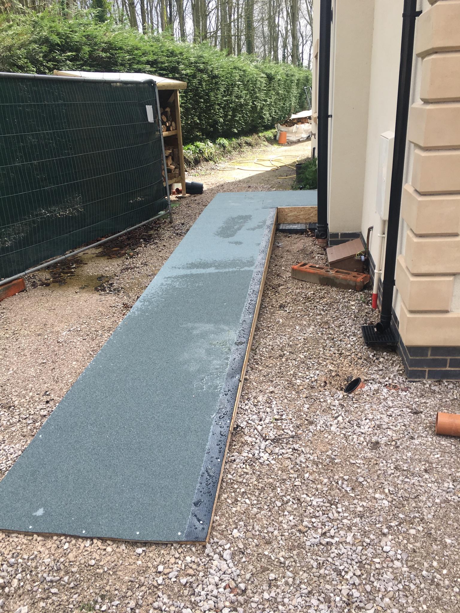

I made a temporary disabled access out of Osb and mineral felt

It was firewood a week after I took this
BC tried to tell me it needed to be concrete I pointed out the wording
Usually Tarmac or concrete
After a bit of pitch measuring and try to lift it off the ground He signed off

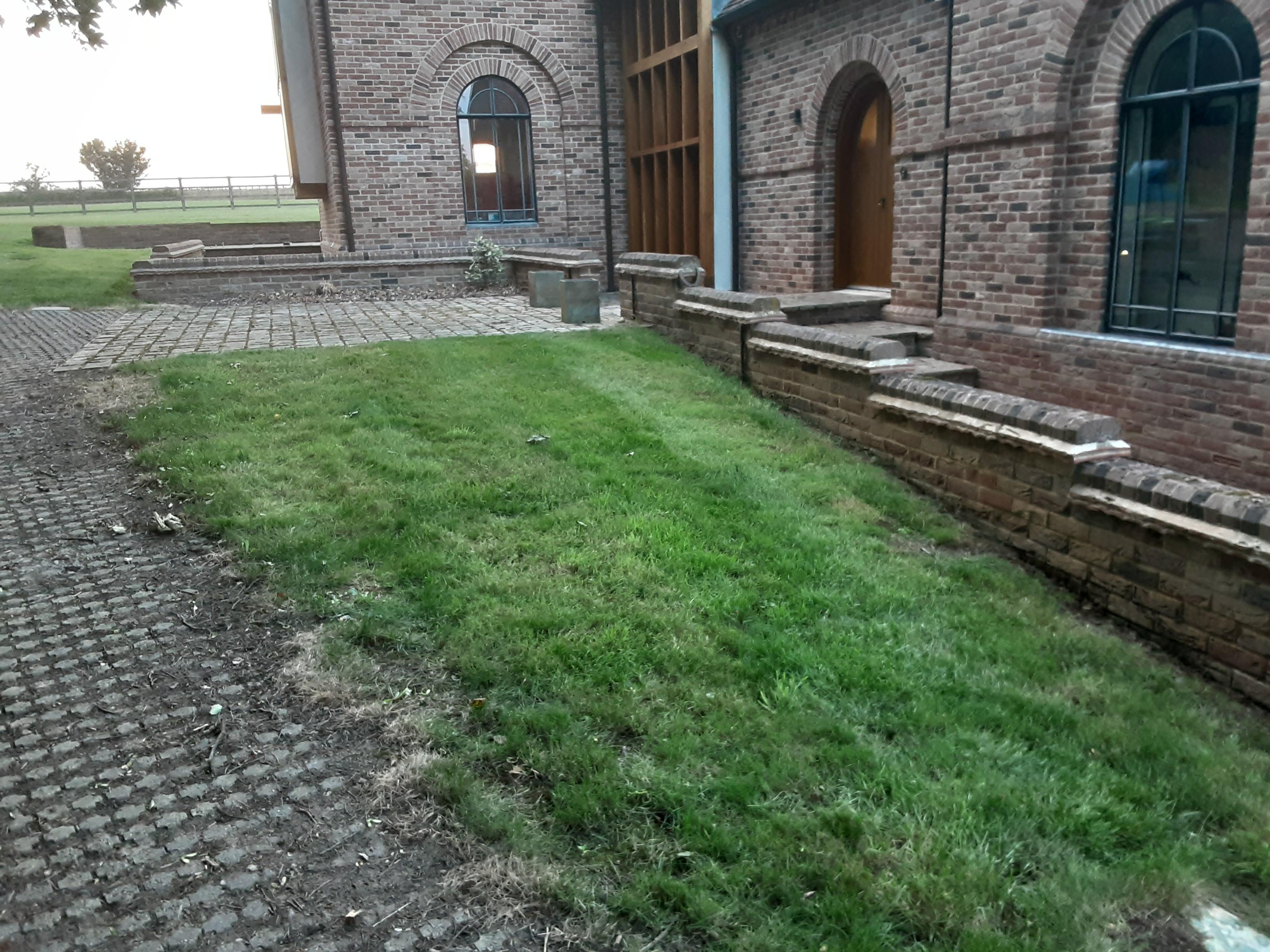

We're lucky in that we had a lot of space but a smaller variation on this would be possible. Eg path/ramp with steps up the side or front. Doesn't have to look like something you see at a hospital.
