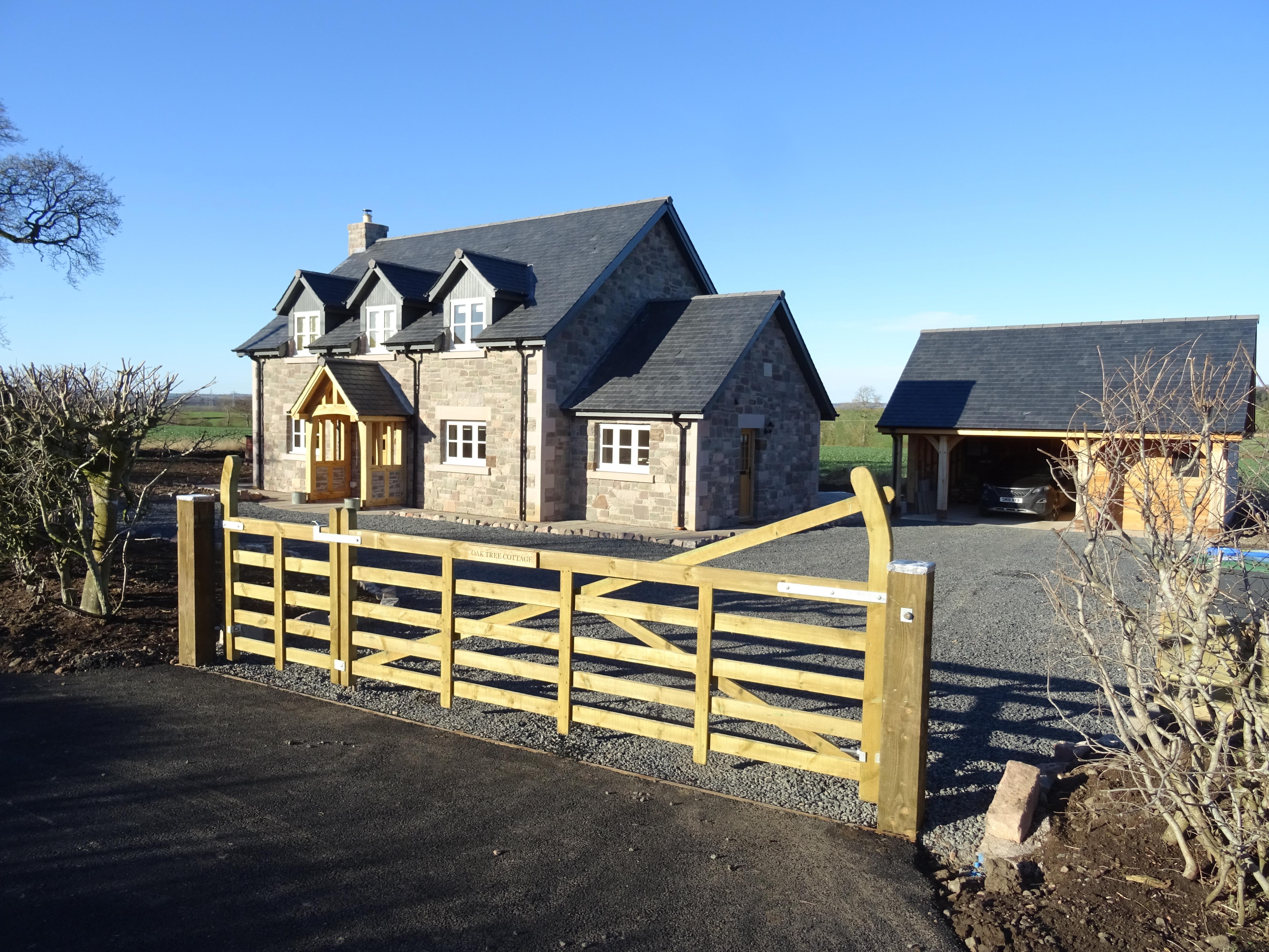

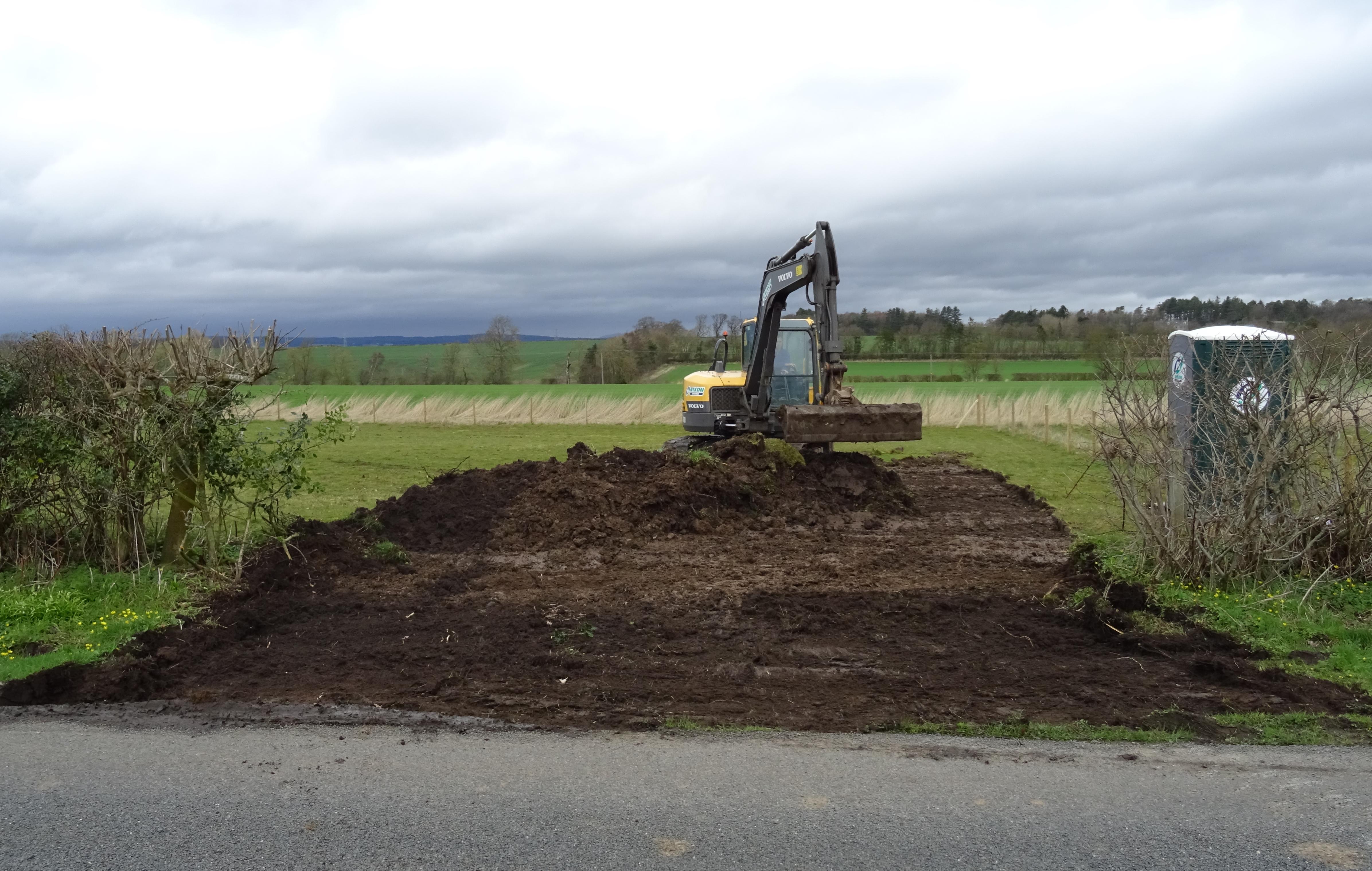

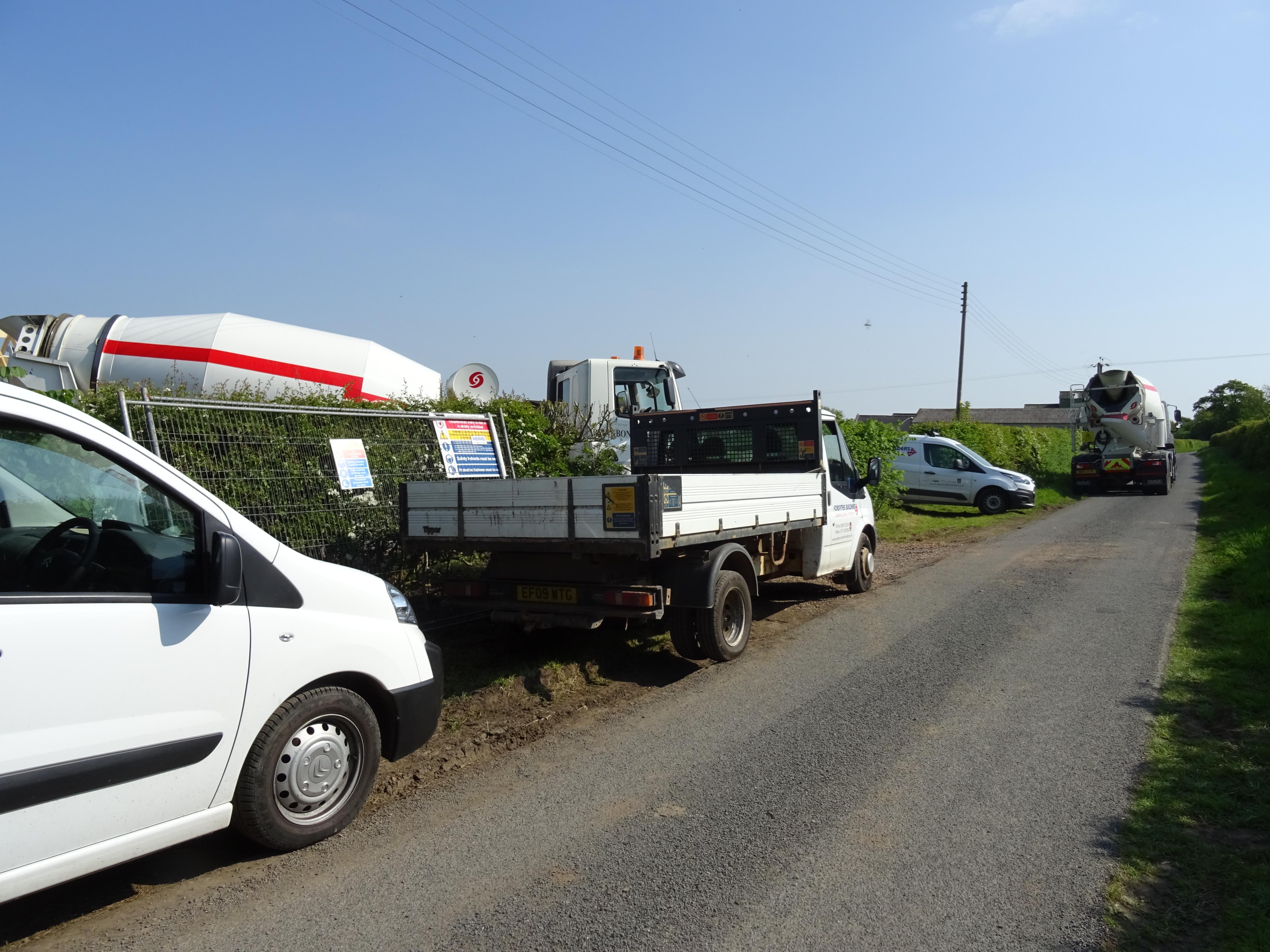

You will be surprised by what some of these drivers can manage in such tight spaces - We too are on a single track lane and the entrance to the plot was nothing more than a "farmers" entrance to his field - no gate at the time. As you will see from the photos - we removed a small section of the hedgerow to open up the gap when the time came. The gap remained the same width throughout the build thereafter. Not sure of the measurements but the finished gates, may give you an idea.

Our site had no space to turn so I instructed all the deliveries on large vehicles or heavy vehicles to come from east side of the road and reverse onto the site. I created a large off-loading area. This was big enough for everything bar artics. They had to park on the road and we used the tele-handler to off-load.

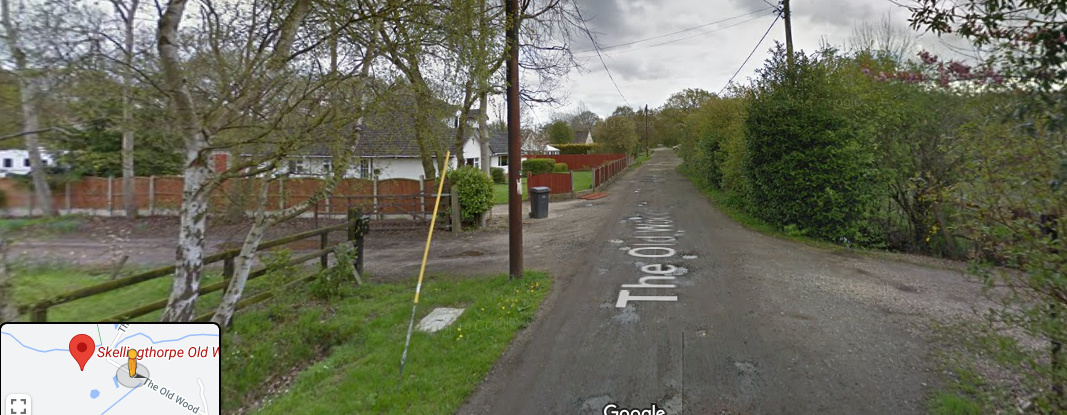

our driveway is 12-13ft, delivery drivers reversed in and drove out.  as long as there is room to swing the front round as they line up to reverse then jobs a goodun.  Our lane is single track too( really old pic for refence)  The only two I had issues with was insulation as that came on a curtainsider but they had a nifty little forklift gadget, and insulation from seconds and co, as that too came on a curtainsider, and handballed off.  Hope that helps.

This is exactly what we did. The carport and shed structure shown in above photos was built first. Therefore it was in situ before we started to take delivery of all other materials etc.
I have measured the distances for you in the hope that they will give you confidence that most trucks etc will get in and out, albeit reversing in and driving out - again as demonstrated in two of the photos above.

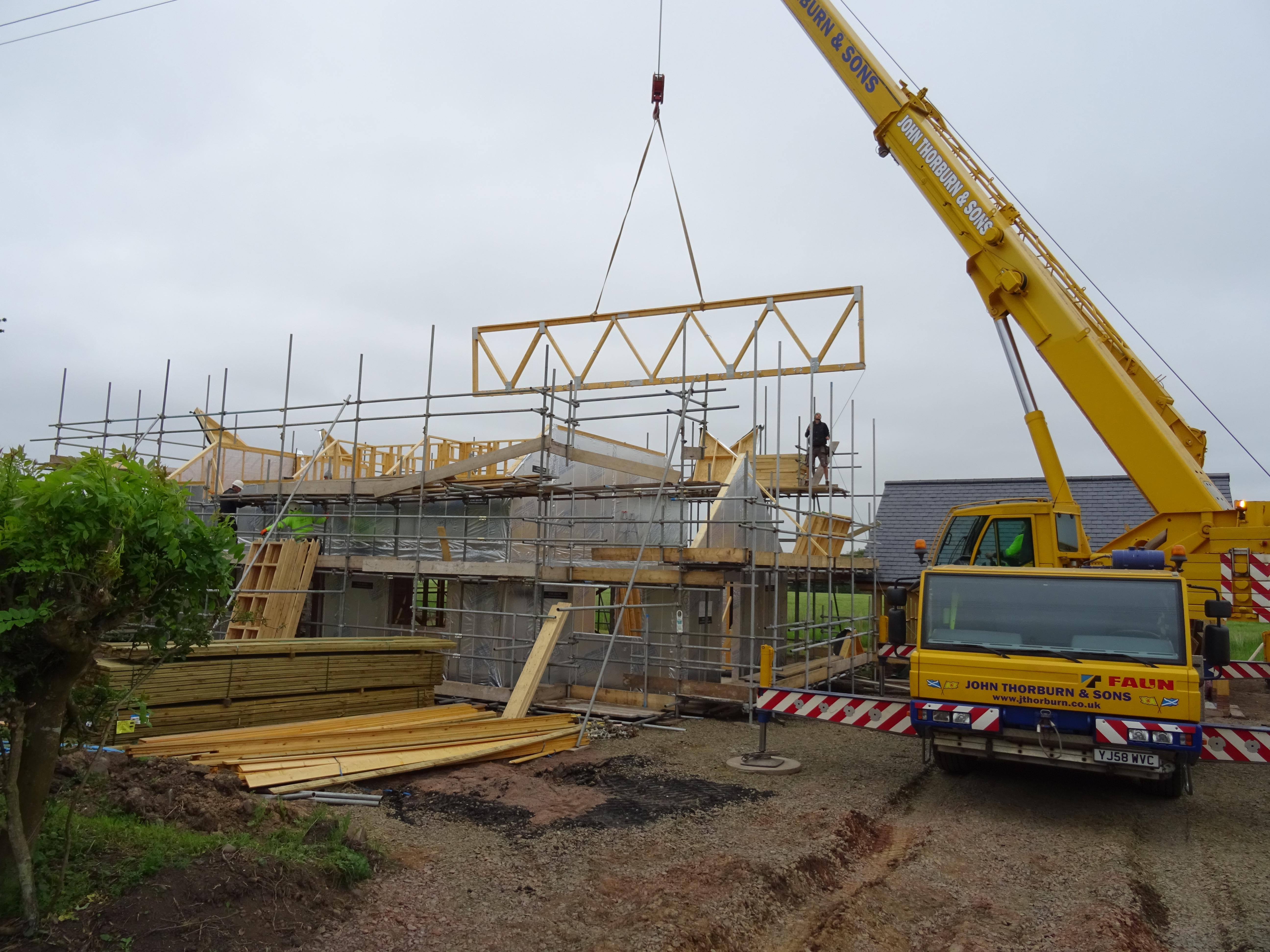

So the distance from the gate to the car port structure is 19 metres. If you were to include the bellmouth [driveway approach] and the width of single lane thereafter, the 19 metres becomes 25 metres. Honestly, more than enough room - the crane managed it as well as cement lorries.
Cranes have multiple axles, and put down jacks on sleepers.  They tend to be on the more relaxed side a drivers  being used to construction.
Ditto concrete wagons but both will refuse to enter at all if they fear getting stuck. Then you have problems.

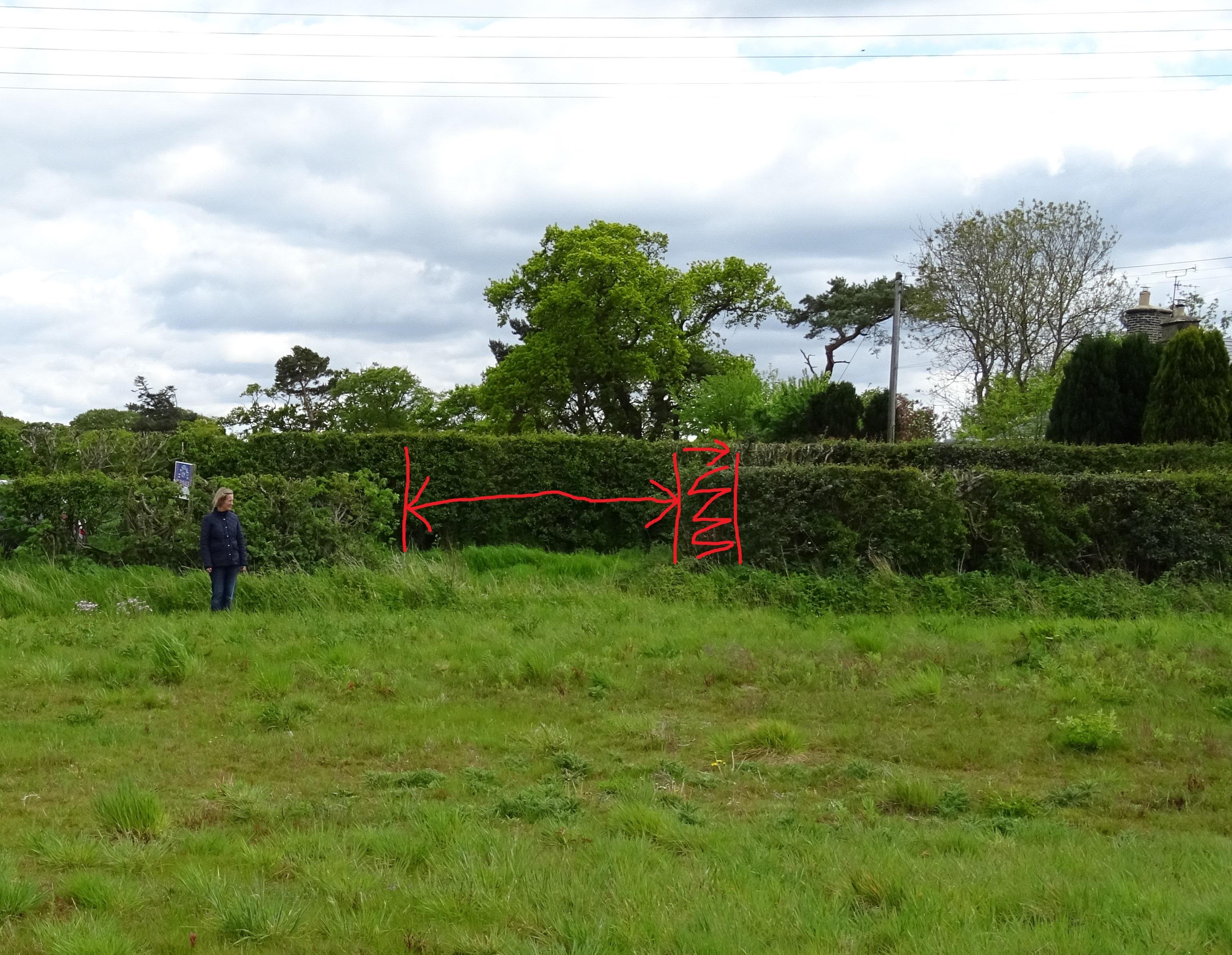

Let me lay that out on my plot and I'll report back.
