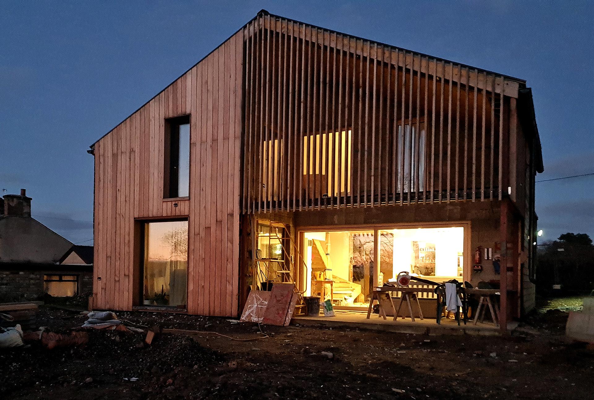

For us It did (does) because we wanted lots of glass.  And we love the noise made by hail and rain.  Yes, there's a bit of solar gain, yes it's a bit cooler in winter than optimal. On balance we're very happy with Gaulhofer : this is what it looks like .....
No comment on the windows but that's a great looking house.

ps. @ToughButterCup's house is definitely a great looking house!
Thanks both.
It's a Marmite house: some love it, others hate it. And I see every damn thing thats wrong with it.
And one day - one day - I'll stop working on it.
Its kind of you to comment so positively
