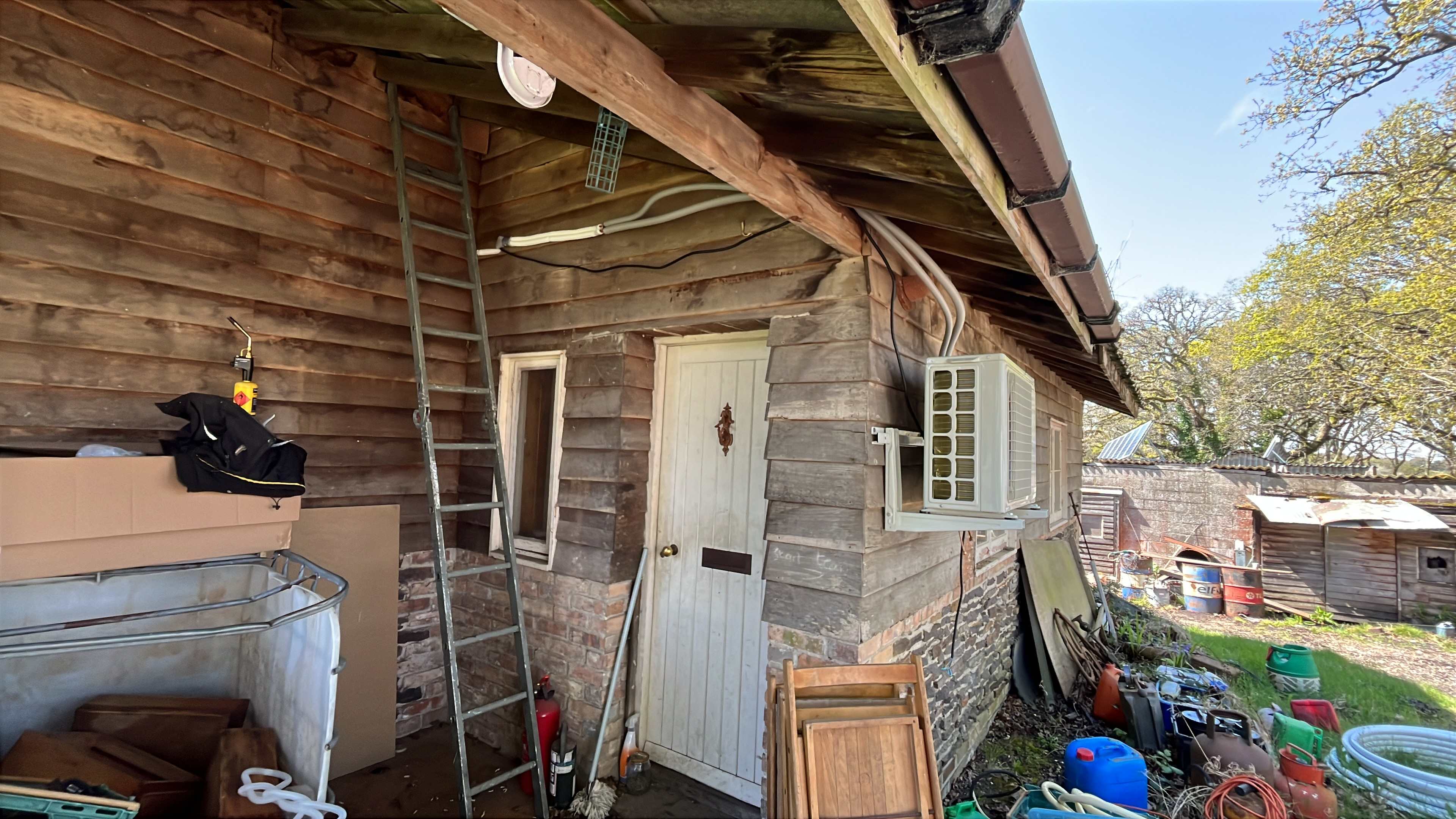

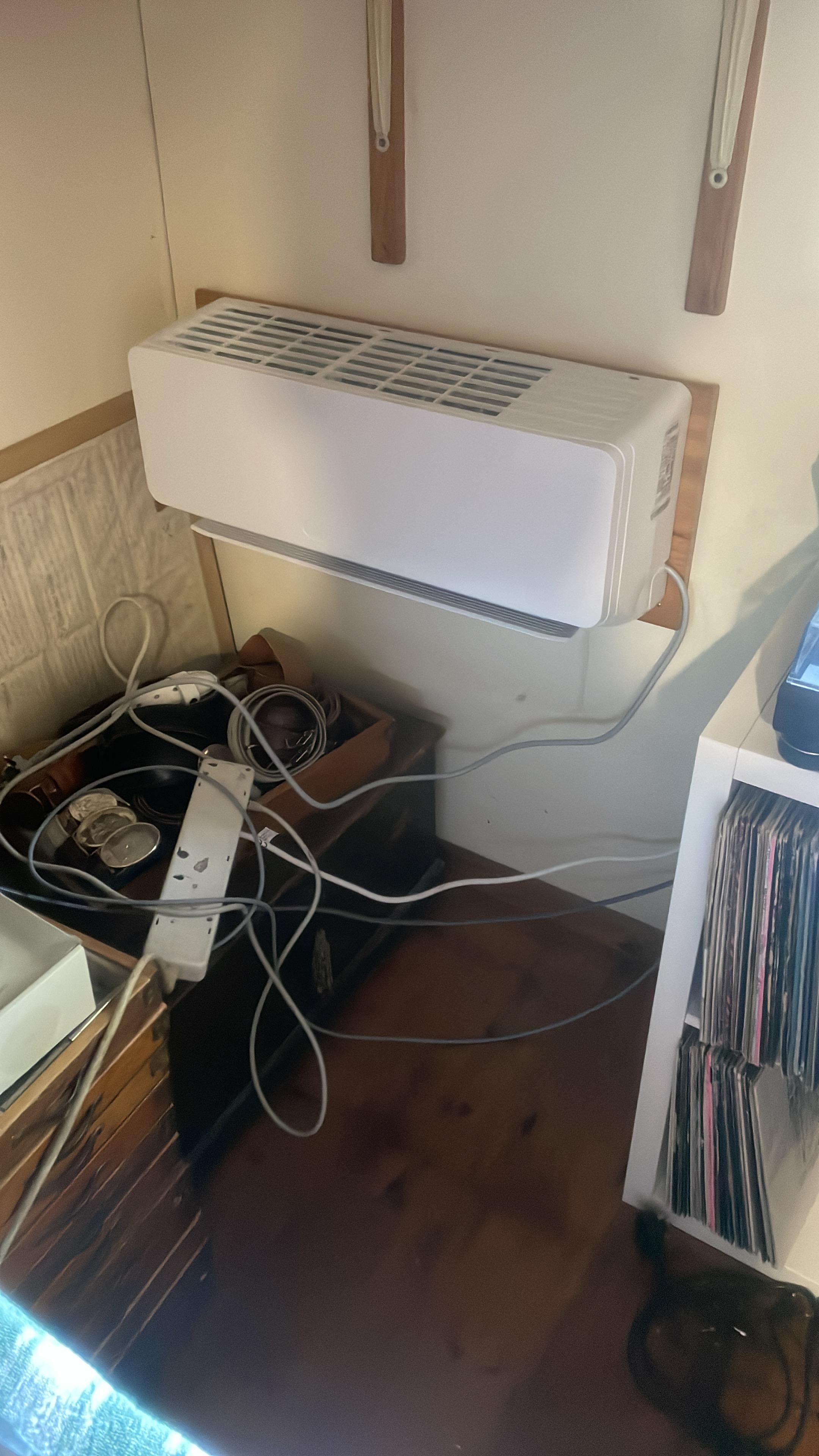

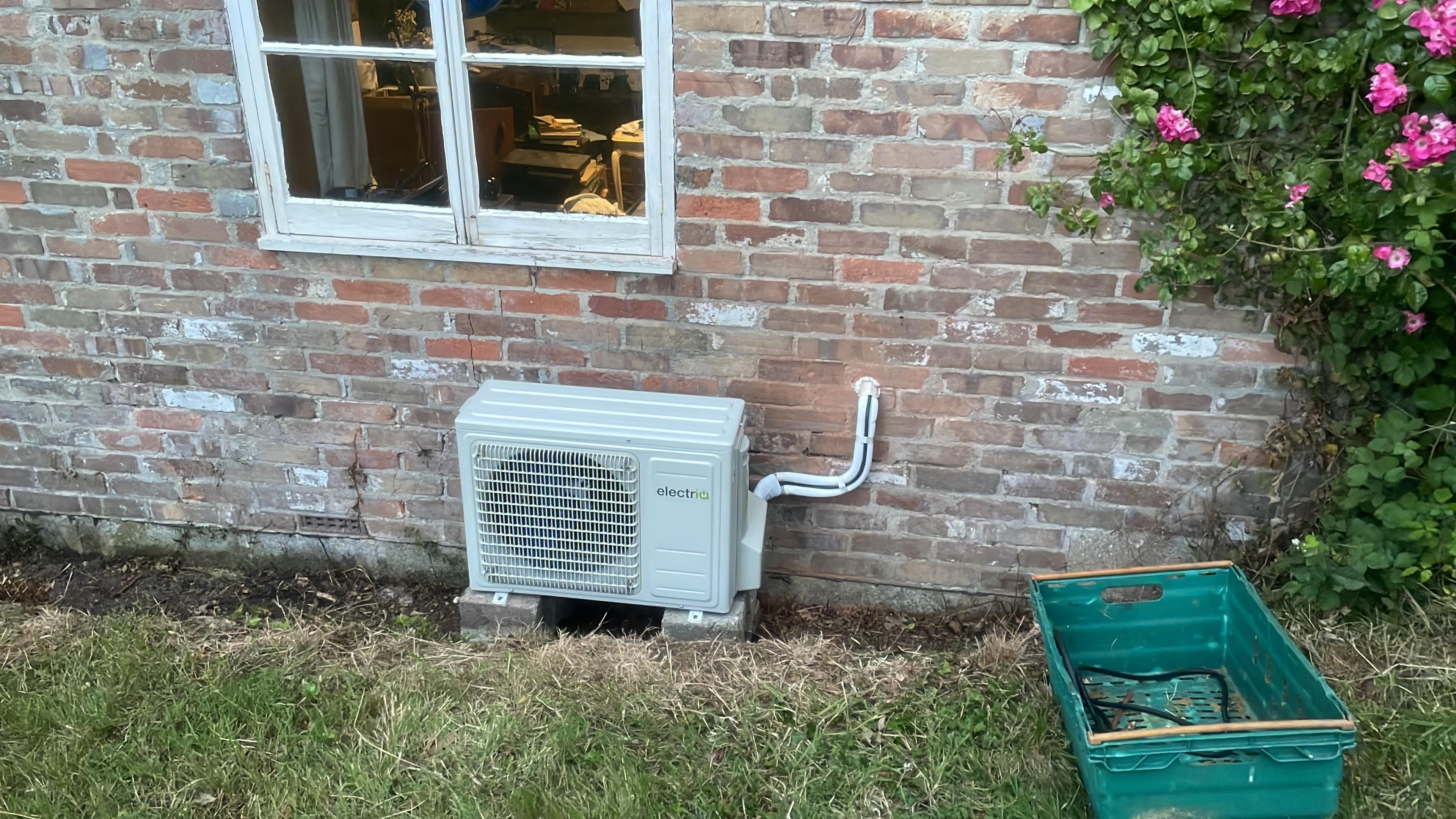

I just finished installing this last night, at my off-grid place in Dorset. This is to provide shoulder season heating (and possibly all winter heating) in a room that currently has a burnt-out woodburner as the only source of heat. We don't have any central heating at this property. The woodburner will be in the metal skip soon.

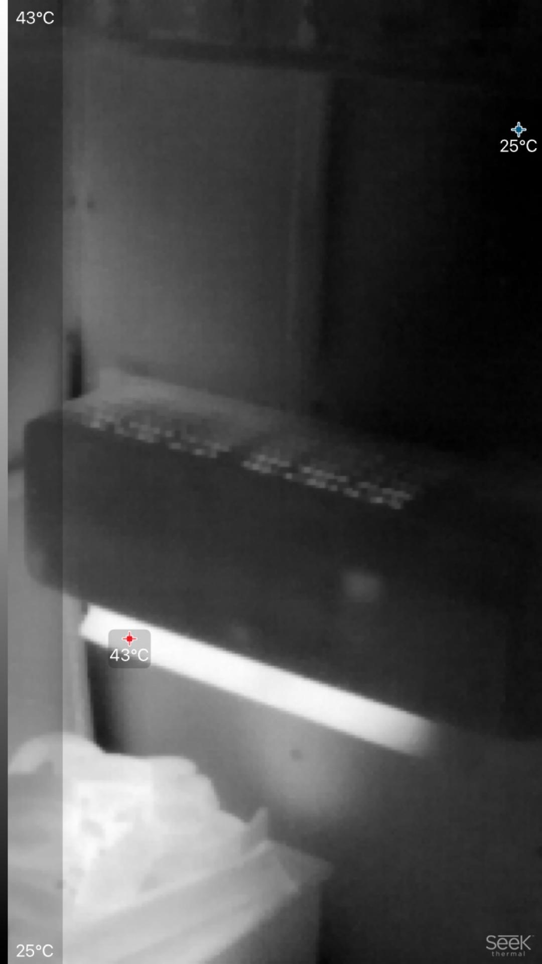

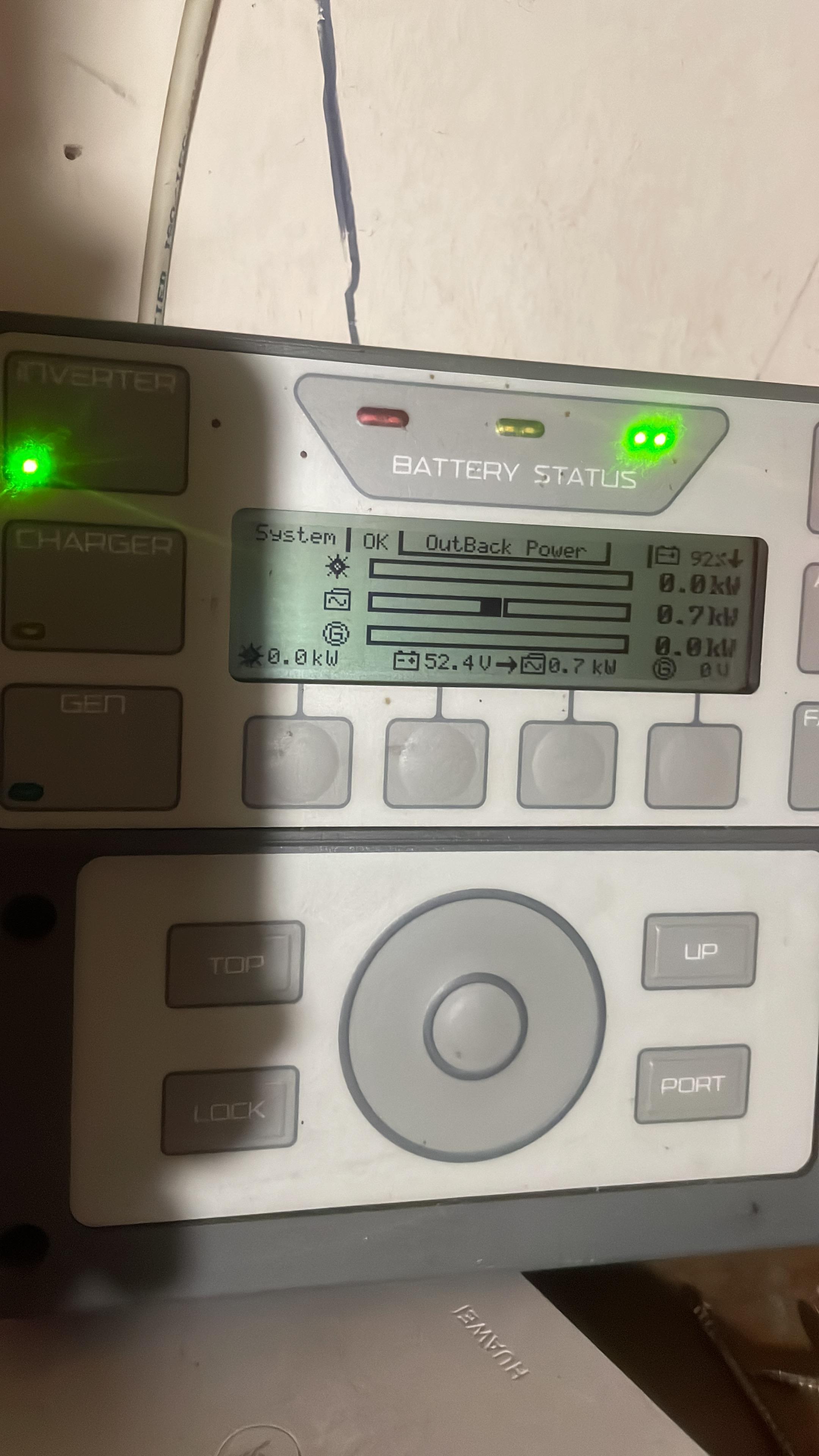

Easy install, and so far seems to heat and cool well. 700w when in heating mode.
In case you were wondering, yes, this came from appliances direct. It was about £550 or something.
I didn't use the supplied extension set, I simply re-flared the ends of the indoor unit pipework. Pressure tested it to 100psi with pure argon (I'm a welder, I have it in stock) then vacuumed down for 20 mins. Float the low-side gauge up to 20psi then remove the pump+adapter from the service port. Then crack the valves and back seat them.
Easy when you watch enough youtube.

It’s ‘okay’ at heating - it really struggles to heat my room in this cold snap, but that’s because I don’t have much in the way of insulation or air tightness. In a proper house (this is basically a shack) it would be fine. Defrosts a couple of times an hour, uses about 800-1000w most of the time and puts out warm air.
My a2w in Somerset is a far superior bit of kit, but it should be for the price.
Frosted up this much after running for about half an hour this morning.IMG_5891.thumb.jpeg.f1683303e3e0b8e18de97ecaf0bd4be3.jpeg

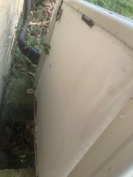

Darn it, pressure tested it, pulled it down to 500 microns, went to float the low side gauge to 20 psi (like I always do with these, fitted a few now) and the damn thing ain’t got no gas in it 😂
  • 3 weeks later...
That was a mistaken assumption on my part. Turns out there was gas in it, I just couldn’t get anything on the gauges till I powered it up. Not uncommon according to r/hvac
Working perfectly, although a little noisy being bolted to wall of the house. I’ll extend the lines and drop it down onto the ground.

In hindsight I would have fitted mine on the ground, there is a slight noise transfer through the wall after a few years. It's only used for aircon now though so not worth bothering changing it.
