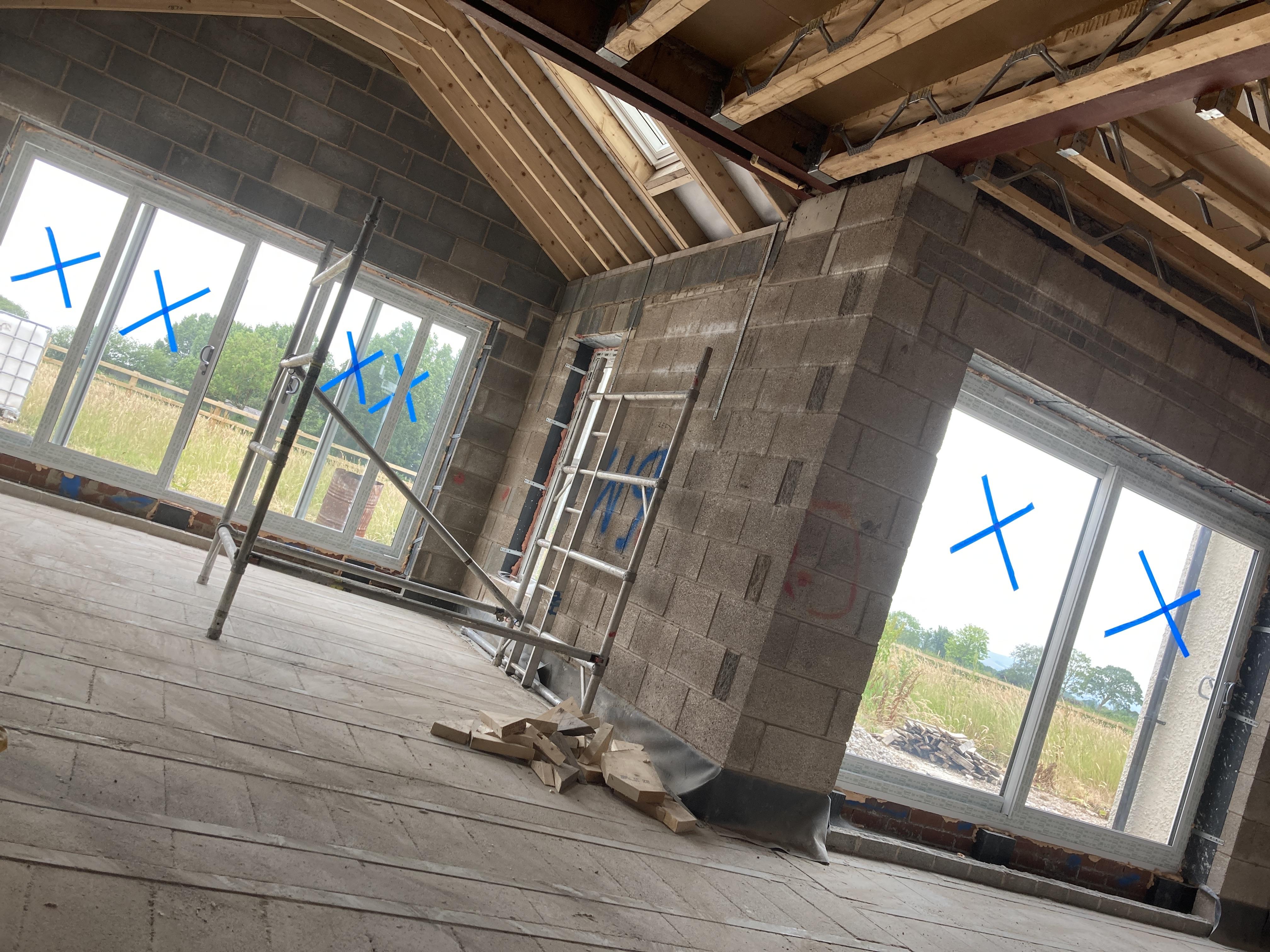

nod Posted June 18, 2023 Share Posted June 18, 2023 Window fitters are probably the least skilled that you will come across Plenty of foam and plenty of excuses When your measuring Do it twice Then cut a staff for each window Starting with the largest and working your way down As you say the fitting prices are crazy My wife and myself fitted 30 sash windows on our previous build in under two days and recently fitted three sets of sliders in an morning The heavy glass was the biggest challenge 1 1 Link to comment Share on other sites More sharing options...
Big Jimbo Posted June 18, 2023 Share Posted June 18, 2023 Nice high ceilings, even on the flat parts @nod Link to comment Share on other sites More sharing options...
nod Posted June 18, 2023 Share Posted June 18, 2023 2 hours ago, Big Jimbo said: Nice high ceilings, even on the flat parts @nod Yes 2700 once the floor is in 1 Link to comment Share on other sites More sharing options...
