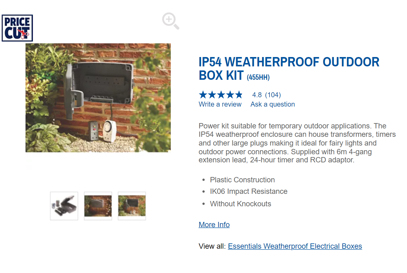

CalvinHobbes Posted June 18, 2023 Share Posted June 18, 2023 (edited) Sorry for all the questions. I am embarrassed to be asking you so much. So the builder said that they would charge us £75 per hole through the blocks to put in pipes/ducts whereas if we do the beforehand then it costs nowt. So trying to come up with a list of holes we will need to factor in and give them pipe or conduit? So the ashp will need a flow and return as will the MVHR? We will need a hockey stick (still unsure if single phase or 3 phase) exterior light . What other pipes/ducts should I be thinking of? I saw this, could the brickies insert it like they did the meter box? https://www.screwfix.com/p/ip54-weatherproof-outdoor-box-kit/455hh Edited June 18, 2023 by CalvinHobbes Link to comment Share on other sites More sharing options...
