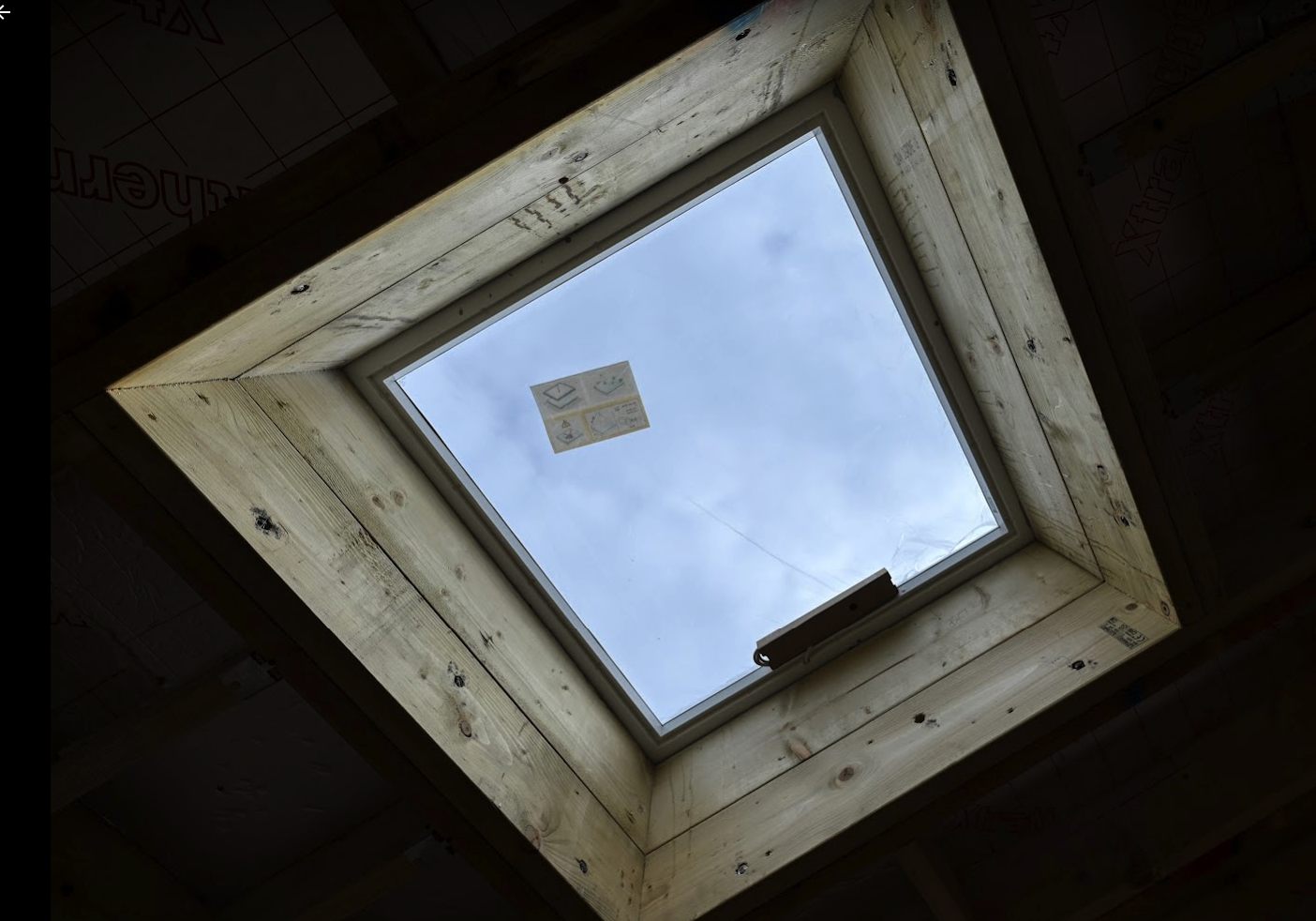

bmj1 Posted June 14, 2023 Share Posted June 14, 2023 Hi all, We've got some rooflights built like this: I'm not entirely sure on the insulation in the upstand (if any). Is there any reason not to use a insulated plasterboard here (17mm PIR + 9.5mm plasterboard), in order to reduce the thermal bridging ? (My concern is of creating interstitial condensation) Link to comment Share on other sites More sharing options...
Nickfromwales Posted June 15, 2023 Share Posted June 15, 2023 I always recommend Marmox boards and plaster directly to them. Link to comment Share on other sites More sharing options...
Dave Jones Posted June 15, 2023 Share Posted June 15, 2023 upstands should have the same level of insulation as the roof. 99.9% of chippies totally ignorant of this fact including yours. 2 Link to comment Share on other sites More sharing options...
Wumpus Posted June 15, 2023 Share Posted June 15, 2023 We used compacfoam to form the upstand. Robust and insulated. 1 Link to comment Share on other sites More sharing options...
nod Posted June 15, 2023 Share Posted June 15, 2023 99% are boarded withe 12.5 mil wallboard without any condensation issues Ideally there would be enough room for an insulation board But there rarely is Link to comment Share on other sites More sharing options...
Dave Jones Posted June 15, 2023 Share Posted June 15, 2023 3 hours ago, nod said: 99% are boarded withe 12.5 mil wallboard without any condensation issues Ideally there would be enough room for an insulation board But there rarely is make the upstand wider externally. still takes the same size light and has full level of insulation. Link to comment Share on other sites More sharing options...
bmj1 Posted June 15, 2023 Author Share Posted June 15, 2023 40 minutes ago, Dave Jones said: make the upstand wider externally. still takes the same size light and has full level of insulation. I've got space for insulated plasterboard internally, just wondering if a risk of condensation? Link to comment Share on other sites More sharing options...
Dave Jones Posted June 16, 2023 Share Posted June 16, 2023 15 hours ago, bmj1 said: I've got space for insulated plasterboard internally, just wondering if a risk of condensation? as long as the U value and depth are the same as the roof. e.g lower U value (more ££££) can be slimmer as long as end result is same. Link to comment Share on other sites More sharing options...
Nickfromwales Posted June 16, 2023 Share Posted June 16, 2023 25mm Marmox + skim. Almost 100% of the thickness is then insulation. Link to comment Share on other sites More sharing options...
