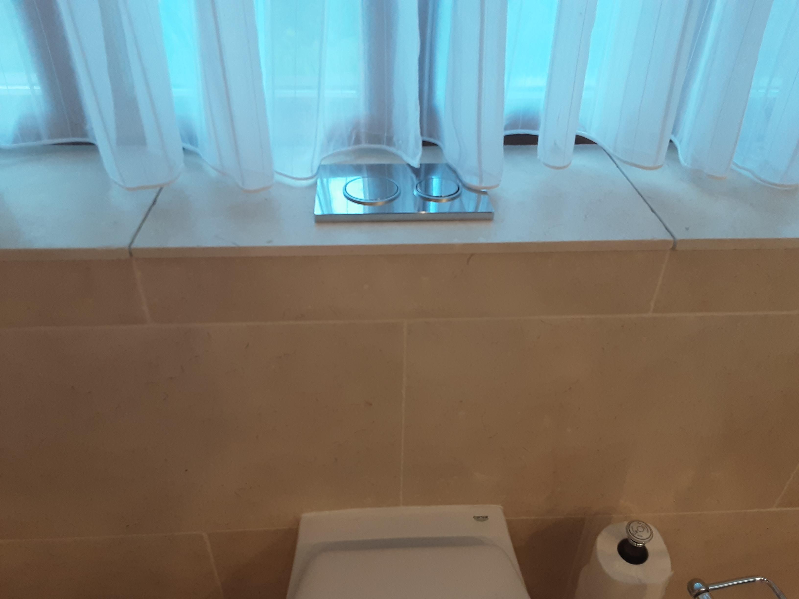

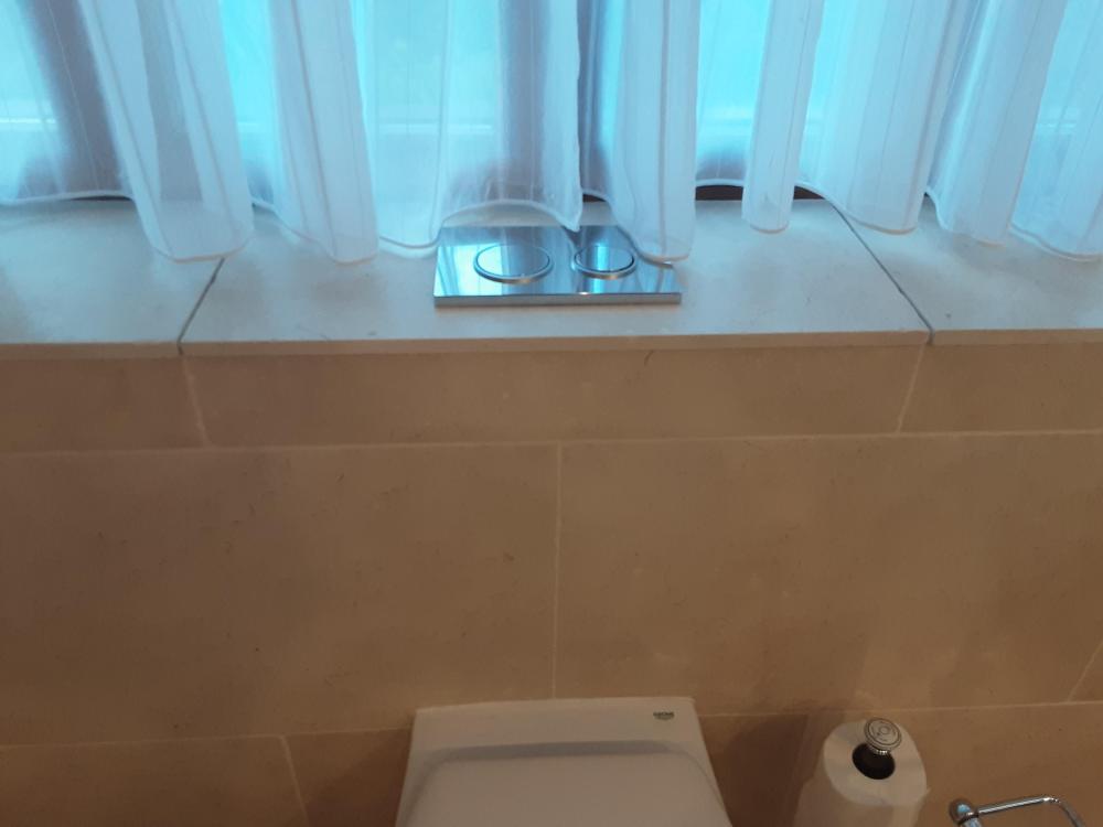

Temp Posted June 15, 2023 Share Posted June 15, 2023 On 13/06/2023 at 20:18, Big Jimbo said: I have always done the lift off shelf above. I have never fancied trying to get my big hands in through the hole in the front panel That's also what I did. Used stone in both our bathrooms and was careful just to centre a 600mm wide piece on the pan. Stuck the stone to the removable bit of hardi backer board. Didn't bother to grout the joints either side but could do. 1 Link to comment Share on other sites More sharing options...
Temp Posted June 15, 2023 Share Posted June 15, 2023 2 hours ago, DarrenP said: Thanks all, I was using the concealed cistern as its cheaper than the frames and was planning on doing the removable top and front panel... our priority is to make it child proof though so the top shelf will need to be fixed in some way probably silicone? and will look around to get a cut piece of granite. We used Hardie Backer board and stone photo above. Too heavy for young kids to lift and held down by the flush plate anyway. 1 Link to comment Share on other sites More sharing options...
