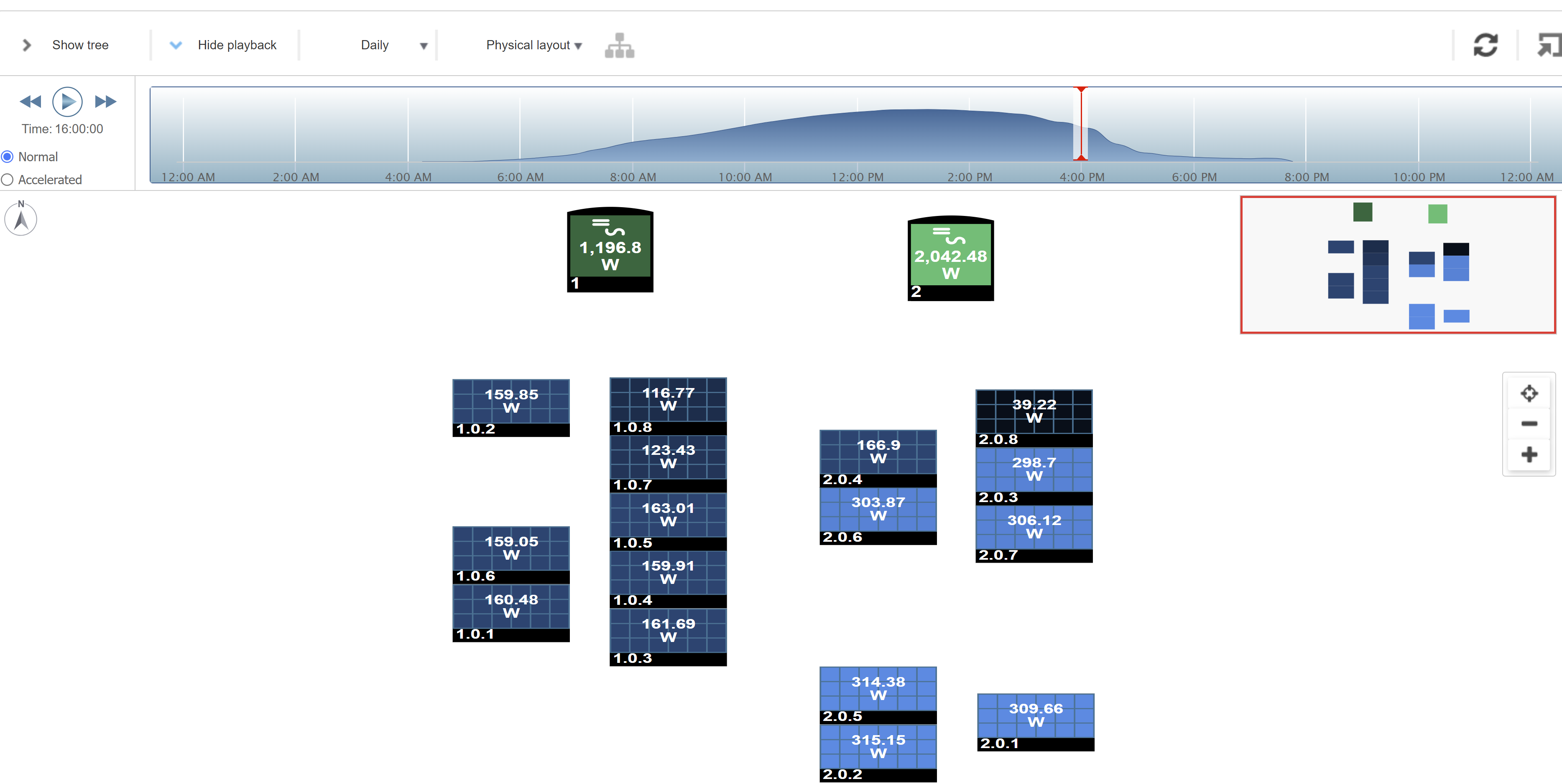

MrTWales Posted June 14, 2023 Author Posted June 14, 2023 3 hours ago, PhilT said: Was it worthwhile getting optimisers? Not sure. In this photo, taken yesterday late afternoon, the left panels where the vertical shade line is have dropped from 320W to 40W. Am I right in thinking that all 8 panels would fall to 40W without optimisers? If so, from the data playback function I worked out that this would have been worth c. 4kWh yesterday. I'm probaby the least expert person here but my understanding is as per what you say, but I did think that any array like that would be set up as two series ideally and all inverters seem to have two inputs. I guess if there is another direction also (ie three sets of panels) then this would explain it?
PhilT Posted June 14, 2023 Posted June 14, 2023 10 minutes ago, MrTWales said: I'm probaby the least expert person here but my understanding is as per what you say, but I did think that any array like that would be set up as two series ideally and all inverters seem to have two inputs. I guess if there is another direction also (ie three sets of panels) then this would explain it? My supplier quoted for one 6kW inverter but actually fitted two 3kW, so I could have split my roof and extension (the one in the photo) into 4 separate strings and therefore probably not needed optimisers. Hey ho hindsight
Rob99 Posted June 14, 2023 Posted June 14, 2023 7 hours ago, PhilT said: In this photo, taken yesterday late afternoon, the left panels where the vertical shade line is have dropped from 320W to 40W. Am I right in thinking that all 8 panels would fall to 40W without optimisers? I thought panels these days were very good at dealing with shading on their own so you would only lose around one third output from the partially shaded top left panel and probably all output from the partially shaded bottom left due to its landscape orientation. The other panels should be pretty much unaffected.
PhilT Posted June 14, 2023 Posted June 14, 2023 29 minutes ago, Rob99 said: I thought panels these days were very good at dealing with shading on their own so you would only lose around one third output from the partially shaded top left panel and probably all output from the partially shaded bottom left due to its landscape orientation. The other panels should be pretty much unaffected. so at the time of this photo here is the snapshot from the playback data. In this graphic the right string of 8 is actually horizontal on my extension roof so top right panel in this graphic (39.22W) is actually top left in the photo and panel showing 166.9W is bottom left landscape in photo
Rob99 Posted June 14, 2023 Posted June 14, 2023 (edited) So does seem like only the partially shaded panels are affected. Interesting that the landscape panel is doing better than the portrait one. Do you have shingle type panels? Do you have optimisers fitted? Edited June 14, 2023 by Rob99 missed bits

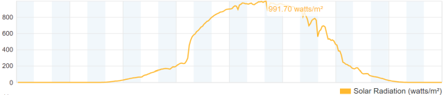

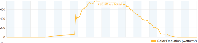

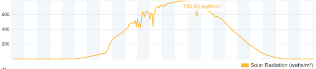

SteamyTea Posted June 16, 2023 Posted June 16, 2023 (edited) 49 minutes ago, Nickfromwales said: Move to Swansea mate Perpetual sunshine here 😎 Pah Cardiff on the 14th Swansea Paul 780.8W compared to my 991.7W Not even a need for Factor 10. Edited June 16, 2023 by SteamyTea
