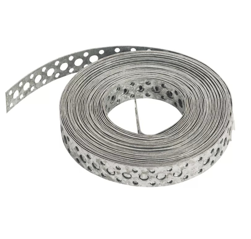

Super_Paulie Posted June 10, 2023 Share Posted June 10, 2023 Best practice, just lay water pipes on the soil from A-B or clip them to the underside of the joists? Seems a lot of effort for long runs... Link to comment Share on other sites More sharing options...
TonyT Posted June 10, 2023 Share Posted June 10, 2023 Clip the pipe, cable everything, laying on the ground is a bodge. Link to comment Share on other sites More sharing options...
Super_Paulie Posted June 10, 2023 Author Share Posted June 10, 2023 3 minutes ago, TonyT said: Clip the pipe, cable everything, laying on the ground is a bodge. Good man. When you say cable everything, what do you mean exactly? I could all use round band instead of clips, need to see how much room I have to swing a hammer. Link to comment Share on other sites More sharing options...
TonyT Posted June 10, 2023 Share Posted June 10, 2023 Sorry Meant pipes and cables all really designed to be clipped to a surface/supported at regular intervals depending on the diameter/material in question. all round band is a good choice when a clip isn’t easy to fit 1 Link to comment Share on other sites More sharing options...
Oz07 Posted June 10, 2023 Share Posted June 10, 2023 Depends on invert level surely? If existing low enough then a trench out the ground with the correct amount of pea gravel under and around. It's what happens under a block and beam Link to comment Share on other sites More sharing options...
Super_Paulie Posted June 10, 2023 Author Share Posted June 10, 2023 2 hours ago, Oz07 said: Depends on invert level surely? If existing low enough then a trench out the ground with the correct amount of pea gravel under and around. It's what happens under a block and beam Makes sense. But this is in my extension and it's a concrete subfloor, void then joists. I've enough room to get my impact in so I'll clip to the underside, seems fair. Link to comment Share on other sites More sharing options...
Oz07 Posted June 10, 2023 Share Posted June 10, 2023 Yeh ive done that before with void above concrete oversite. Sounds good 1 Link to comment Share on other sites More sharing options...
saveasteading Posted June 10, 2023 Share Posted June 10, 2023 Use this 1 Link to comment Share on other sites More sharing options...
Super_Paulie Posted June 11, 2023 Author Share Posted June 11, 2023 Thanks gents. The job is done. Combination of band and clips got me from A-B. The house was all just slung on the dirt originally, didn't think it was a classy way of doing business. Link to comment Share on other sites More sharing options...
