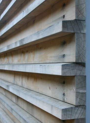

I wonder if face-edge-face-edge cladding or vertical on vertical as suggested above (like a hit and miss fence with no inside gap) would be preferable? The second pic below is the horizontal version of what I call face-edge-face-edge. I can see that a vertical version of that might be beneficial depending on your prevailing wind angle onto the wall.

Alternatively you could go horizontal and either detail carefully to disguise future staining, or do something interesting such as scorch your planks - if you are cash poor time rich you could DIY that finish. With all wood cladding, detailing is the most important thing after choosing the appropriate version for the context.

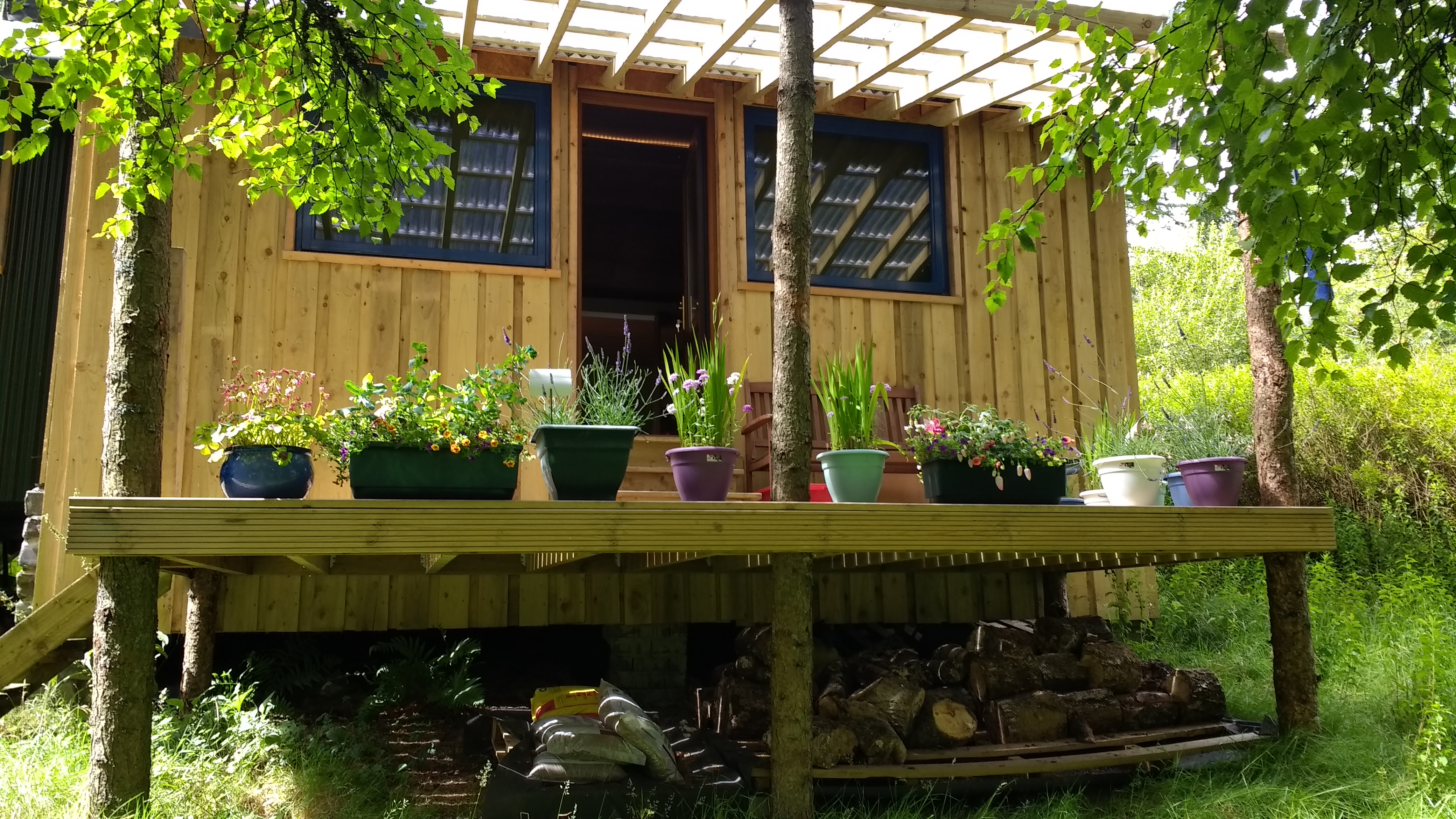

Here's a pic of board on board from my hut. You will have to counter batten to allow air movement behind the cladding.
This pic is of sarking board left untreated (can be as cheap as £6 per metre) and now two years old.

The sarking boards look good; are they really untreated with anything, how long do you anticipate them lasting?
