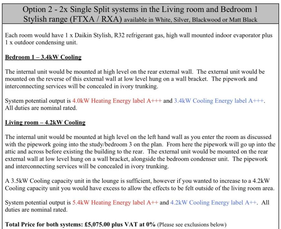

DougMLancs Posted June 4, 2023 Share Posted June 4, 2023 My brother has his detached 4 bed bungalow on just two A2A units and is very happy with it. Install costs were low and way more efficient than his old storage heaters. I would second retaining some control over any heating system and bear in mind if you go A2A then you’ll also have to manage/disable cooling. Link to comment Share on other sites More sharing options...

DougMLancs Posted June 9, 2023 Share Posted June 9, 2023 9 hours ago, Crofter said: Hi, I'd be interested to hear more about this. Try as I might I can't find basic costs for A2A units online anywhere. Here’s his quote- fitted Sept last year in the Midlands 1 Link to comment Share on other sites More sharing options...
Crofter Posted June 9, 2023 Share Posted June 9, 2023 1 hour ago, DougMLancs said: Here’s his quote- fitted Sept last year in the Midlands Thanks. How does the zero VAT rating work? Link to comment Share on other sites More sharing options...
DougMLancs Posted June 9, 2023 Share Posted June 9, 2023 (edited) Heat pumps are one of the energy-saving measures that are zero-rated for VAT. Installers shouldn’t be charging VAT on materials or installation. More info here https://www.gov.uk/tax-on-shopping/energy-saving-products I think it has to be professionally installed to qualify for the zero rating though. If you went the DIY route then VAT would apply. Others will correct me if I’m wrong. Edited June 9, 2023 by DougMLancs 1 Link to comment Share on other sites More sharing options...
JohnMo Posted June 9, 2023 Share Posted June 9, 2023 The install and supply needs to be the same company on the same invoice to be zero vat. Link to comment Share on other sites More sharing options...
