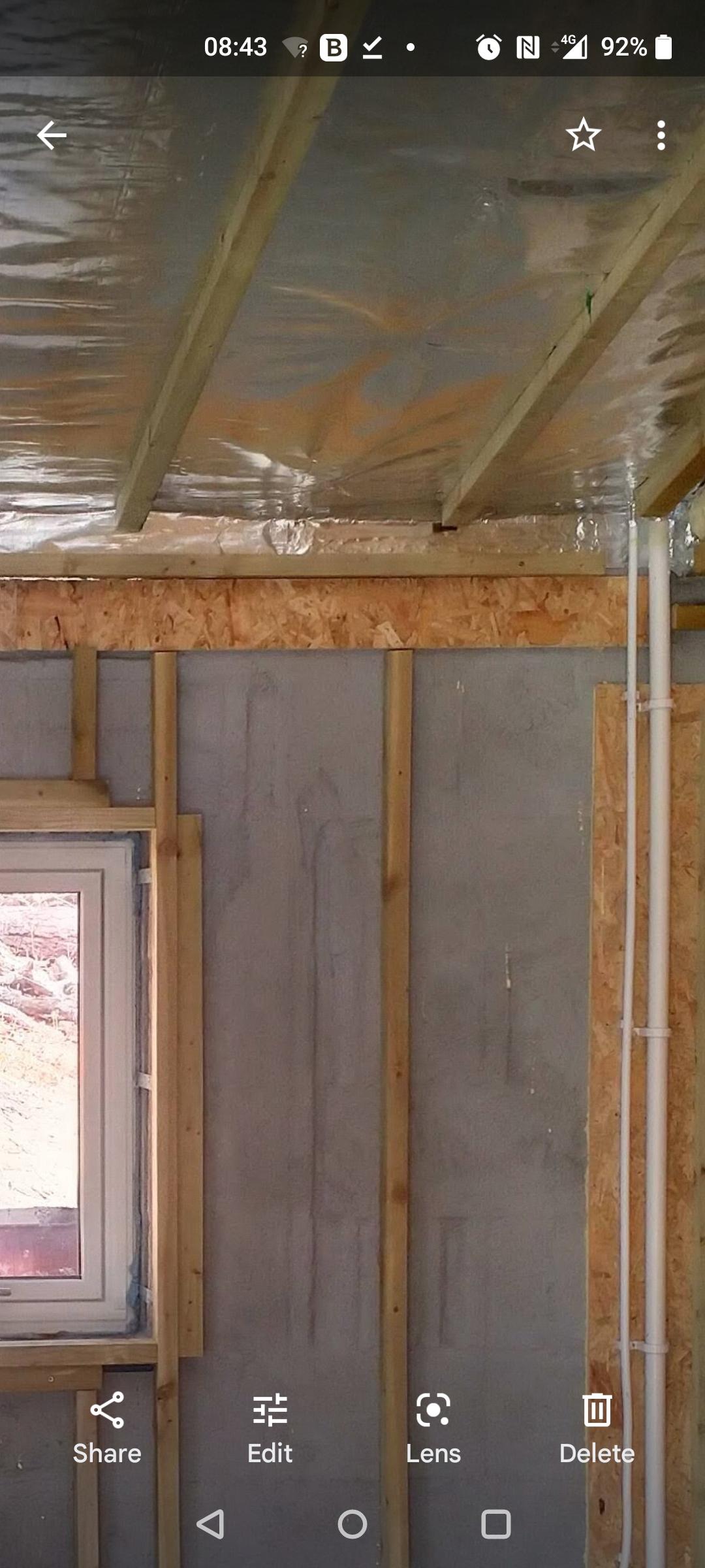

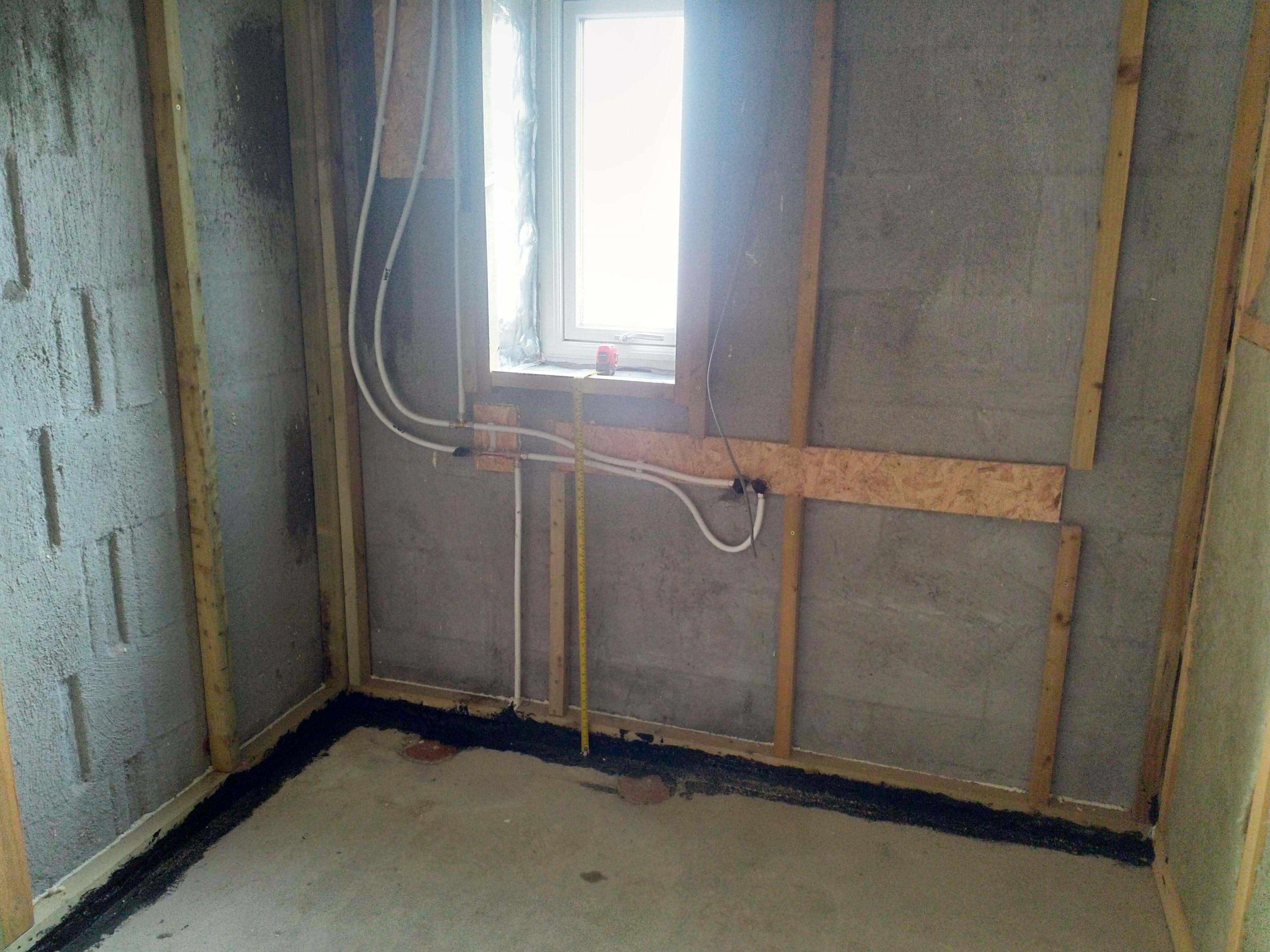

JohnMo Posted June 4, 2023 Share Posted June 4, 2023 2 hours ago, Nic said: would be interested if you could expand on this a bit more with details of how you made it airtight with the details of what was used . Also did you do a service void on all walls was that just a batten and plastic board what size voids did you go for and did you fill it with anything? cheers Parge coat was a double cream consistency mix of cement, lime and soft building sand. Mix was applied with a soft broom, just enough to fill the gaps in the block surface. I used 50mm square battens, screwed through the parge coat into Durisol block. I used a CT1 sealant at the point where the screw broke through the batten to help seal. I used airtight paint at the floor wall junction. On the wall to roof junction I draped the avcl membrane down the wall 150mm and used airtight sealant to seal to wall. Some photos Link to comment Share on other sites More sharing options...
Nic Posted June 4, 2023 Author Share Posted June 4, 2023 @JohnMo this is really helpful thank you. I take it you just plasterboarded after ? Did you use any additional insulation for 50mm void ? Was this a warm roof design? thanks. Again Link to comment Share on other sites More sharing options...
