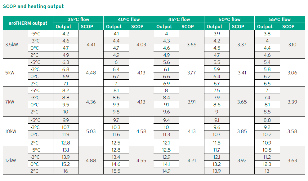

sharpener Posted June 3, 2023 Share Posted June 3, 2023 So I read that SCoP is formally defined as total heat output over a year divided by total electrical energy input. As the instantaneous CoP is a function of Flow Temperature and Outside Air Temperature this leads to performance tables like this: Are the OAT figures in the table then the design minimum figures, and so already take account of the variation through the seasons of the actual OAT. If so, what is the source of the OAT probability tables used for this (e.g. CIBSE?), which will vary from region to region? Furthermore, with Weather Compensation (which is mandatory under MCS rules) the flow temperature is itself an inverse function of OAT. So do these tables already take that into account as well? If not then they will underestimate the year-round average CoP as the flow temp needed to achieve a constant ambient temp inside the house will also vary with the seasons so will be less that the figure in the table. Thanks for any enlightenment! Link to comment Share on other sites More sharing options...
S2D2 Posted June 3, 2023 Share Posted June 3, 2023 I could be wrong, but I think you're looking for EN 14825. There's a decent explanation here: https://www.varmepumpsforum.com/vpforum/index.php?action=dlattach;ts=1505933467;topic=65119.0;attach=49952 An average year is binned into temperatures which gives a good agreement with lab test data, I was pleasantly surprised with how accurate it should be. There are quite sweeping climate classifications (average, cold, warm) but it seems to do the job. It's calculated from lab testing points, so I believe it would be performing weather compensation in those conditions yes. Caveat this entire post with I've never actually read EN 14825, I just thought it was interesting when looking at A2A manufacturer claims. 1 Link to comment Share on other sites More sharing options...
JohnMo Posted June 3, 2023 Share Posted June 3, 2023 OAT are just the output kW at different outside temperatures. SCoP is just taken as a function of flow temperature. It does not take account if WC, just the flow temp stated. Biggest thing is get an ASHP good SCoP at the flow temp nearest what you expect to flow. Then the biggest change after that, is the install. Things like small buffers piped as a 4 pipe, will kill CoP anyway. 1 Link to comment Share on other sites More sharing options...
sharpener Posted June 3, 2023 Author Share Posted June 3, 2023 2 hours ago, JohnMo said: Biggest thing is get an ASHP good SCoP at the flow temp nearest what you expect to flow. My point exactly, what is it I "expect"? If I design for 99% worst case OAT (-0.2C for the SW) then using weather comp I expect the flow temp to vary from say 30C in spring and early autumn to say 55C in the depths of winter. I don't anticipate spending a high proportion of the time at 55C but I think it is a reasonable corner case to design for. At this temp the Vaillant Arotherm + 12 is still producing more than the nominal 12kW output and the claimed SCoP (whatever that turns out to mean) of 3.63 is enough to beat the price I am currently paying for oil. Problem is that the Vaillant installer I spoke to recently won't under any circumstances design for flow higher than 45, which seems not to take advantage of the machine's capbility on the limited number of days it might be needed. And chose a -3.0C worst case OAT which increases the required emitter sizes even further. IMO it should be my choice how to trade operating efficiency in extreme conditions against investment in 12 new radiators. Link to comment Share on other sites More sharing options...

Nickfromwales Posted June 3, 2023 Share Posted June 3, 2023 33 minutes ago, sharpener said: If I design for 99% worst case OAT (-0.2C for the SW) then using weather comp I expect the flow temp to vary from say 30C in spring and early autumn to say 55C in the depths of winter. I don't anticipate spending a high proportion of the time at 55C but I think it is a reasonable corner case to design for. At this temp the Vaillant Arotherm + 12 is still producing more than the nominal 12kW output and the claimed SCoP (whatever that turns out to mean) of 3.63 is enough to beat the price I am currently paying for oil. If you are on oil, what improvements have you made to make a move to an ASHP sensible? You can pretty much forget calculations including maths from an assumed flow of 30oC?! If you have not nearly doubled the size of the radiators, increased the size of all of the primary pipework, improved the insulation / 3G glazing, and more, then I think you are being VERY optimistic of an SCoP of over 3.5! Retro-fit of an ASHP is often done poorly, or badly, or worse. Increasing the size of you roil tank x2 and strategizing when you buy oil (when it is at it's cheapest) may be a better solution for the next 3/5/7 years or so. Costs of electricity (increases of) must be inclusive of your overall decision making here per the same 3/5/7 year period . What standard is the dwelling at for airtightness and insulation / overall fabric quality, currently? If it's a passive house I'll stand down. Link to comment Share on other sites More sharing options...
sharpener Posted June 3, 2023 Author Share Posted June 3, 2023 Purpose of this thread is to try and understand how SCoP is arrived at short of buying and wading through the whole of BS EN 14825. In particular it seems to me that the averaging process might not/does not take account of weather comp. It appears to be some kind of weighted average of the test points at -7, -2, +2 and +7 for two cases, low temperature operation and high temperature, which is not (now) really a high temperature anyway. Maybe using the performance tables here https://www.vaillant.cz/downloads/projek-n-podklady/kl-06-e2-verze-01-18012023-2564719.pdf and weather statistics from e.g. CIBSE I can build a more appropriate model but was hoping to avoid this. Yes from Table 6.3.11 in this link the CoP is about 2.2 at A0/W55C but these conditions will prevail for a small part of daily cycle over a very small fraction of the year. As mentioned elsethread we have a s/h barn conversion, it has D/G and MVHR but scope for wall insulation is virtually nil. The building is long and thin so zoning works well in it. Of course I am canny with oil purhasing, belong to a local buying group and buy nearly all I need in the summer, but the boiler is over 25yrs old and I would rather replace it at a time of my own choosing, ideally with an HP because of the 7kW of PV. Have considered Veritherm assessment of heat loss coefficient but they cannot do it until August or September when the nights are again long and cool enough, and given the lead time for P/P that will be too late for W23/24. There is a lot of free PV in the shoulder seasons so outright efficiency is not the main driver however and as always in these matters there is a balance to be struck between capital outlay and running costs. Here the best is the enemy of the good and as @JamesPa has also discovered installers are extremely conservative and are wont to overdesign to avoid callouts e.g. chooosing -3C as a starting point in coastal Devon. Whereas I have a taste for elegance in design, have years of experience in engineering projects, and can afford to take some risks because I have an AGA and WBS as supplementary means of heating even if the benighted MCS process will take no account of them. So all-in-all and with due thanks for the contributions so far I am still after a good explanation of how the SCoP figures are arrived at in the first place! Link to comment Share on other sites More sharing options...

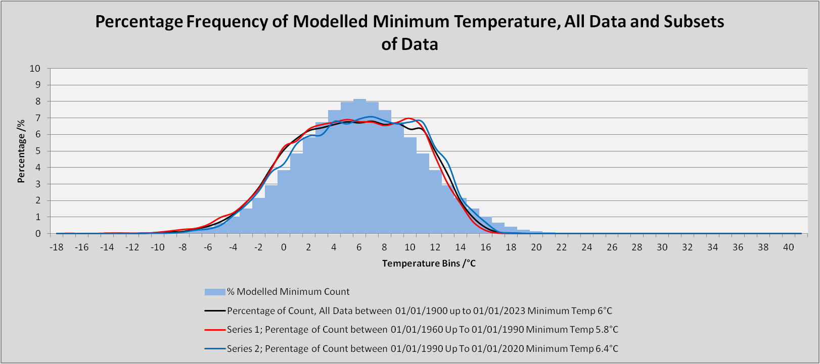

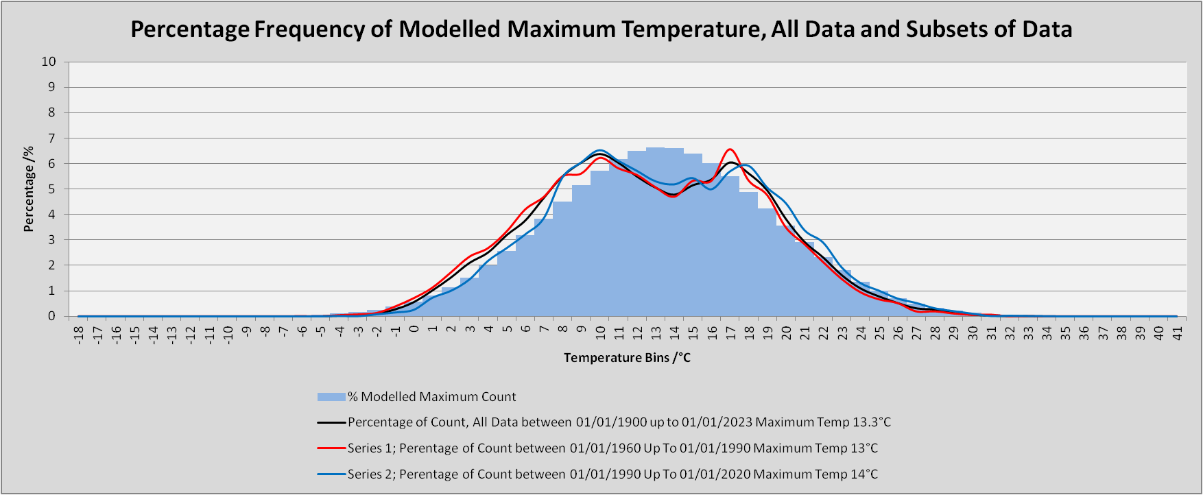

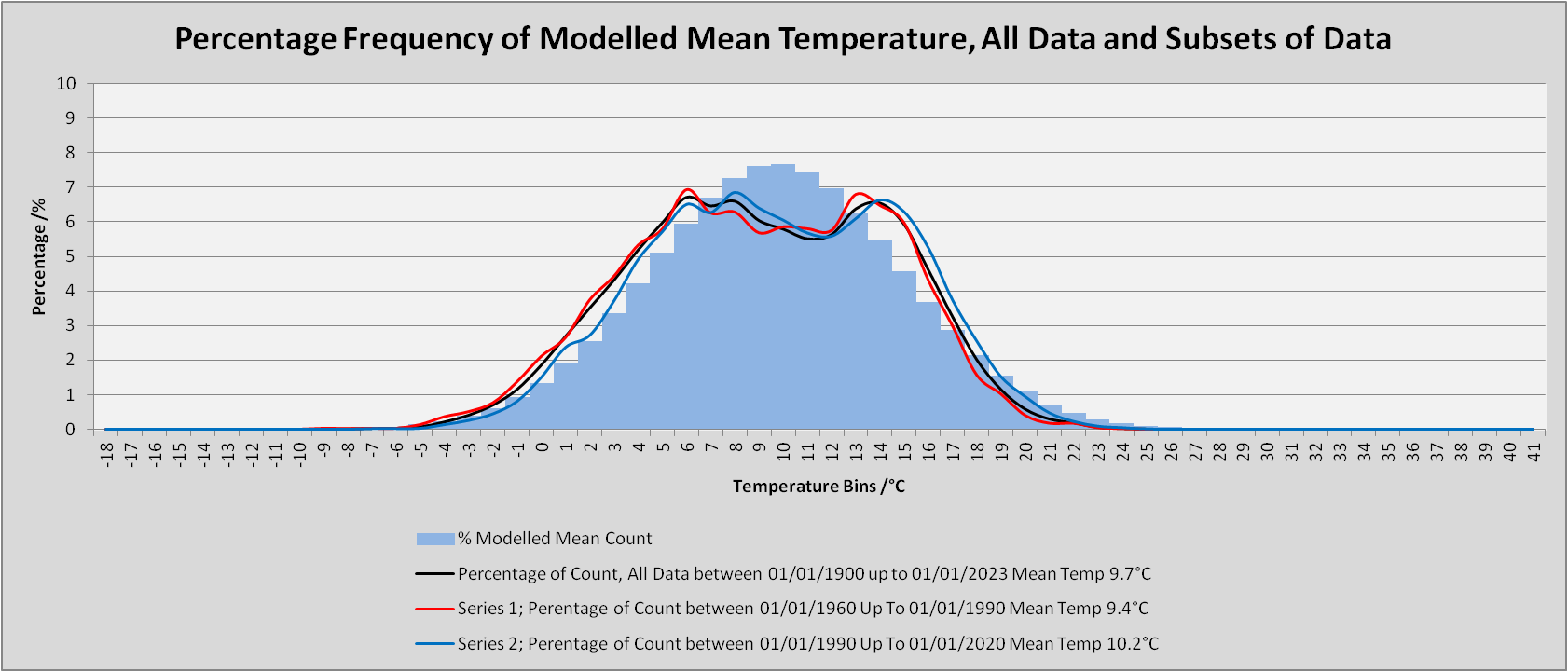

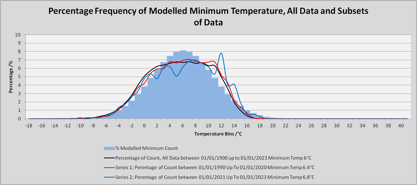

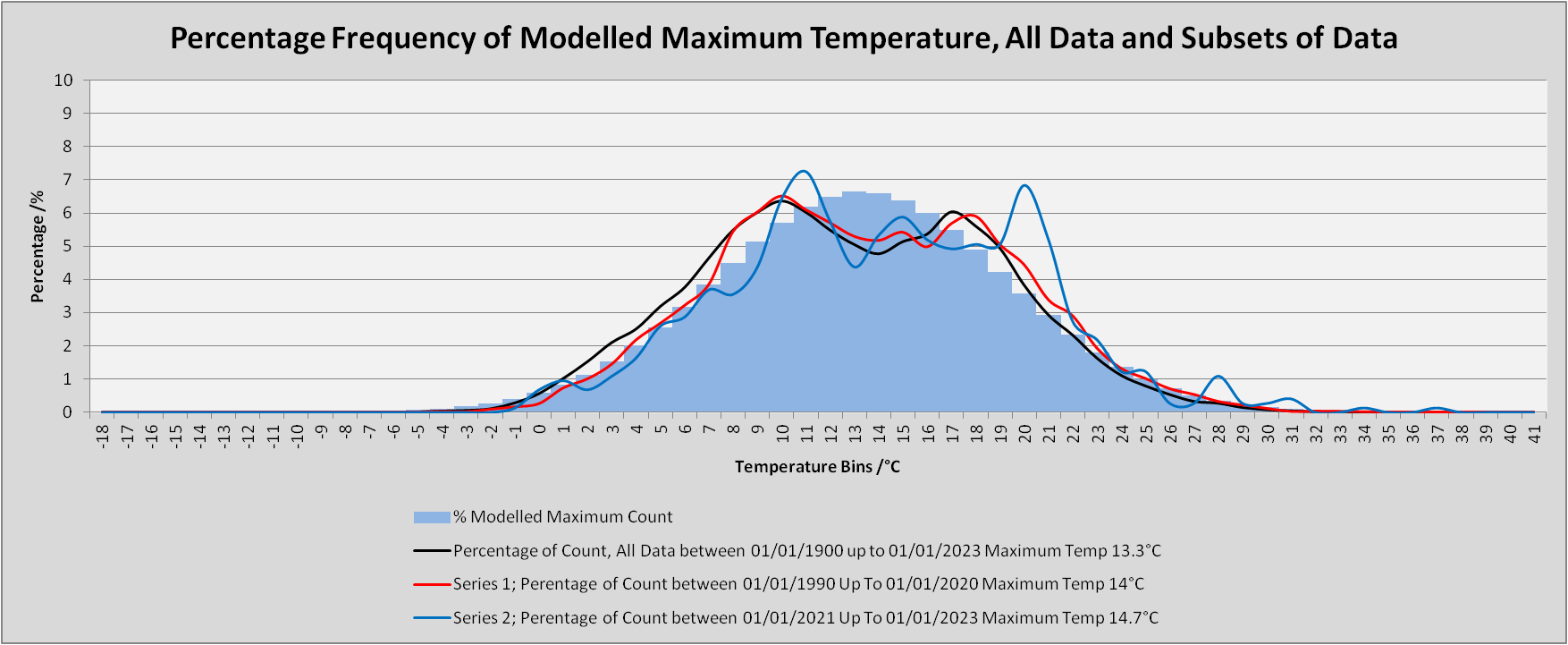

sharpener Posted June 7, 2023 Author Share Posted June 7, 2023 @SteamyTea / @JamesPa can either of you suggest a ready source for temperature distribution by # of days in 1 deg bins for Plymouth? I have found some data in the CIBSE Guide A but it is concentrated around and below freezing and does not cover the warmer days where the HP will I hope spend most of its time. Link to comment Share on other sites More sharing options...
SteamyTea Posted June 8, 2023 Share Posted June 8, 2023 (edited) 7 hours ago, sharpener said: @SteamyTea / @JamesPa can either of you suggest a ready source for temperature distribution by # of days in 1 deg bins for Plymouth? I have found some data in the CIBSE Guide A but it is concentrated around and below freezing and does not cover the warmer days where the HP will I hope spend most of its time The Met Office has some historical data. The nearest station will be close enough. There is also Degreedays https://www.degreedays.net/ Edited June 8, 2023 by SteamyTea Link to comment Share on other sites More sharing options...
JamesPa Posted June 8, 2023 Share Posted June 8, 2023 7 hours ago, sharpener said: @SteamyTea / @JamesPa can either of you suggest a ready source for temperature distribution by # of days in 1 deg bins for Plymouth? I have found some data in the CIBSE Guide A but it is concentrated around and below freezing and does not cover the warmer days where the HP will I hope spend most of its time. This is where it gets difficult. I used daily average temperature for the nearest weather station, this data is freely available. This is going to introduce some error in the calculation the magnitude of which depends on how quickly your house reacts to external temperature changes. Mine is quite slow to react, taking a day or thereabouts to 'stabilise' so I was happy that average temperature was good enough for what I was trying to explore. Degree days are good for some purposes, but probably not this one. Hourly data is available by following links from the met office to another site (I can't recall where exactly). You have to register and can then download about a month's worth for free, any more you have to pay. Im not sure if this is a daily or all time limit. Link to comment Share on other sites More sharing options...
S2D2 Posted June 8, 2023 Share Posted June 8, 2023 https://www.visualcrossing.com/ is quite good, also has hourly data. There's a daily limit to the amount of data downloadable for free accounts. Link to comment Share on other sites More sharing options...
sharpener Posted June 8, 2023 Author Share Posted June 8, 2023 9 hours ago, S2D2 said: https://www.visualcrossing.com/ is quite good, also has hourly data. There's a daily limit to the amount of data downloadable for free accounts. It's potentially all there, but AFAICS I would need to download the average temp for a whole year (ideally 5 years) and then sort the numbers into 1 degree bins to fit into @JamesPa's spreadsheet, is there a better way? Link to comment Share on other sites More sharing options...
JamesPa Posted June 8, 2023 Share Posted June 8, 2023 (edited) 5 minutes ago, sharpener said: It's potentially all there, but AFAICS I would need to download the average temp for a whole year (ideally 5 years) and then sort the numbers into 1 degree bins to fit into @JamesPa's spreadsheet, is there a better way? That's what I did (I think for only 2 years). Sorting into bins is easy. I cant remember exactly how I did it but round(t+0.5,0) rounds to the nearest whole number and then a pivot table on the result (to count) is one method, or you could use a series of countif's Edited June 8, 2023 by JamesPa Link to comment Share on other sites More sharing options...
SteamyTea Posted June 8, 2023 Share Posted June 8, 2023 2 hours ago, sharpener said: is there a better way If you know the mean temperature, and the standard deviation (use 6⁰C if you don't) that will be close enough. Link to comment Share on other sites More sharing options...
