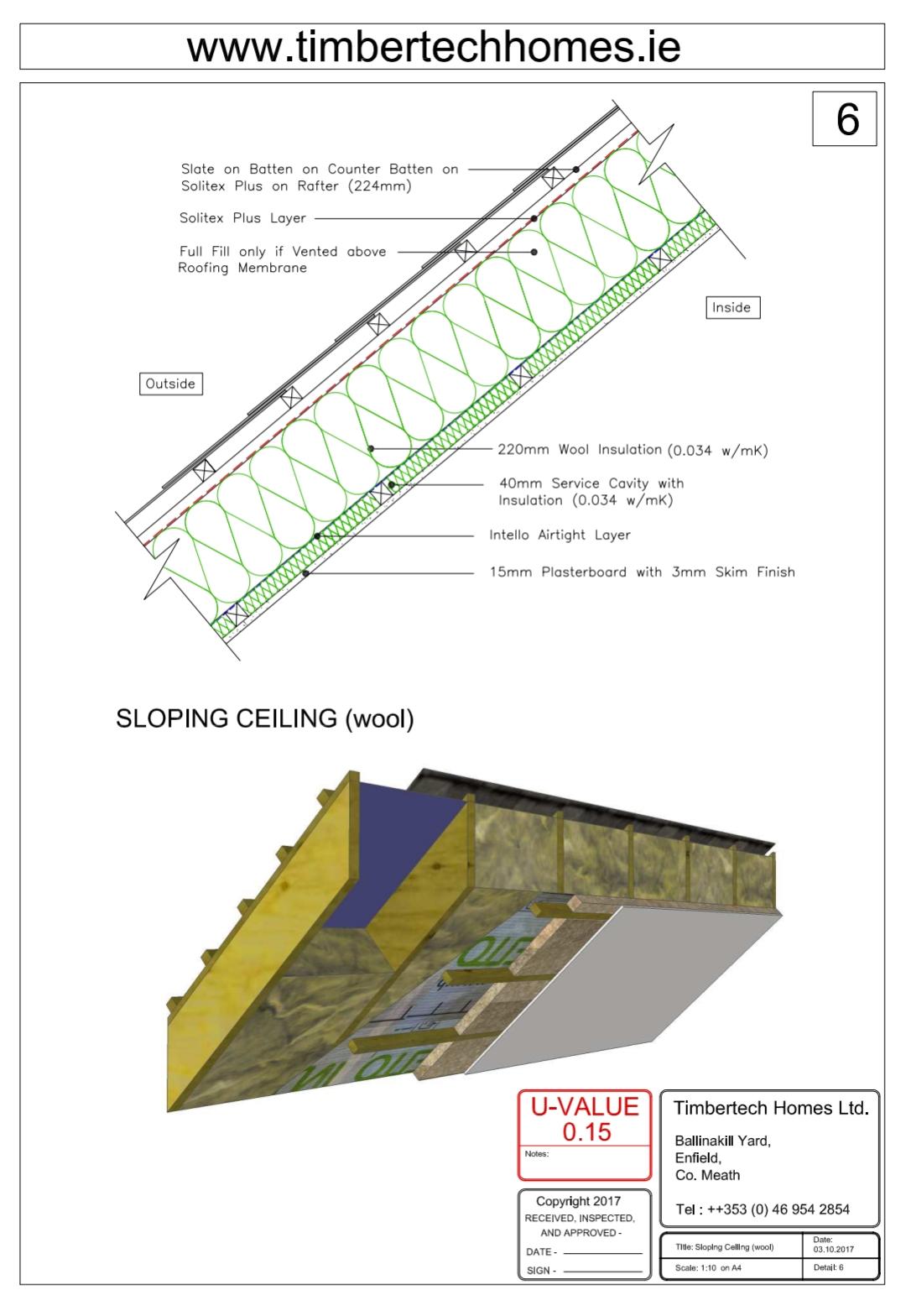

1 hour ago, Sophiae said:
I would preferably something like this for a pitched roof.
Screenshot_2023-07-12-15-45-31-048_com.google.android_apps.docs-edit.thumb.jpg.d28eba58ab8a9f27f38b929f63bc315e.jpg
Much less wasteful of labour and  material and cheaper by my calcs too.
Better for airtightness and windtightness and heat protection also if done properly.
