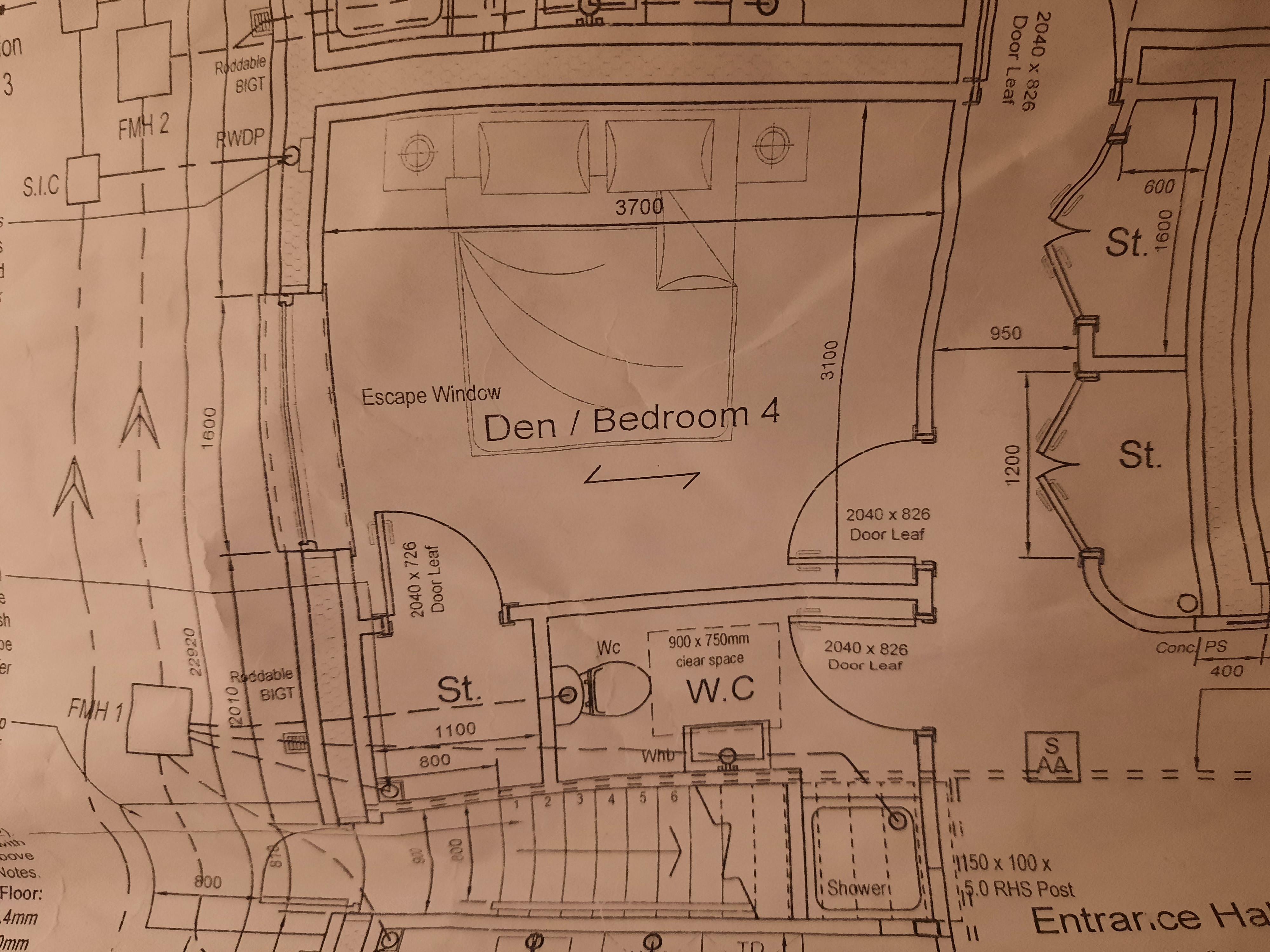

CalvinHobbes Posted June 1, 2023 Share Posted June 1, 2023 (edited) This will be the main loo for downstairs so I need to keep the door in from the hall. I just would love there to be a sliding door from the bedroom. Is that mad? Like the blockwork could be going up there tomorrow...it just bugs me. Edited June 1, 2023 by CalvinHobbes Link to comment Share on other sites More sharing options...
Dave Jones Posted June 2, 2023 Share Posted June 2, 2023 bit weird shower in a downstairs loo ? Why dont you get rid of it and put a bog in its place then you can have a separate ensuite for the bedroom, lose the cupboard for a shower. Link to comment Share on other sites More sharing options...
ProDave Posted June 2, 2023 Share Posted June 2, 2023 I would at least put the door opening in the wall if being built out of block. I would make it a normal hinged door opening into the bedroom. You would be creating a Jack & Jill bathroom, nothing wrong with that. Don't forget light switch wiring so the light can be turned on from either entrance. 3 Link to comment Share on other sites More sharing options...
CalvinHobbes Posted June 3, 2023 Author Share Posted June 3, 2023 16 hours ago, ProDave said: I would at least put the door opening in the wall if being built out of block. I would make it a normal hinged door opening into the bedroom. You would be creating a Jack & Jill bathroom, nothing wrong with that. Don't forget light switch wiring so the light can be turned on from either entrance. Thanks - it's happening. Good point to re wiring. Link to comment Share on other sites More sharing options...
