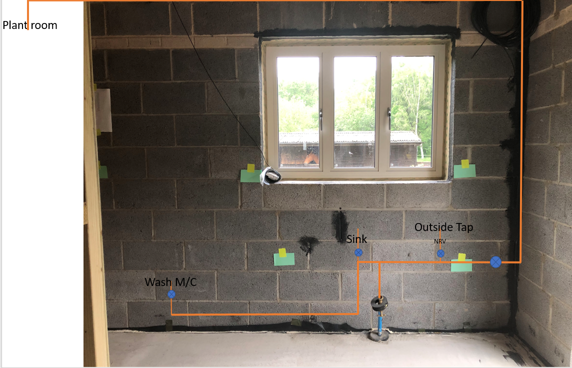

crispy_wafer Posted May 31, 2023 Share Posted May 31, 2023 I'm procrastinating again! This time over how I ought to plumb the incoming mains to the plant room. Originally I was thinking copper 22mm, take off a couple of reducing T's for Sink and outside tap, up the wall, through the web joists and down into the plant room, which then got me onto thinking about chasing the wall out so the dot and dab will go over the pipe nicely, then what about covering/protecting the pipe from the adhesive blah blah blah I'm heading down a rabbit hole. Or should I just HEP20 it, same route plan, just add metalized tape over the pipe where it will be behind plasterboard? Link to comment Share on other sites More sharing options...

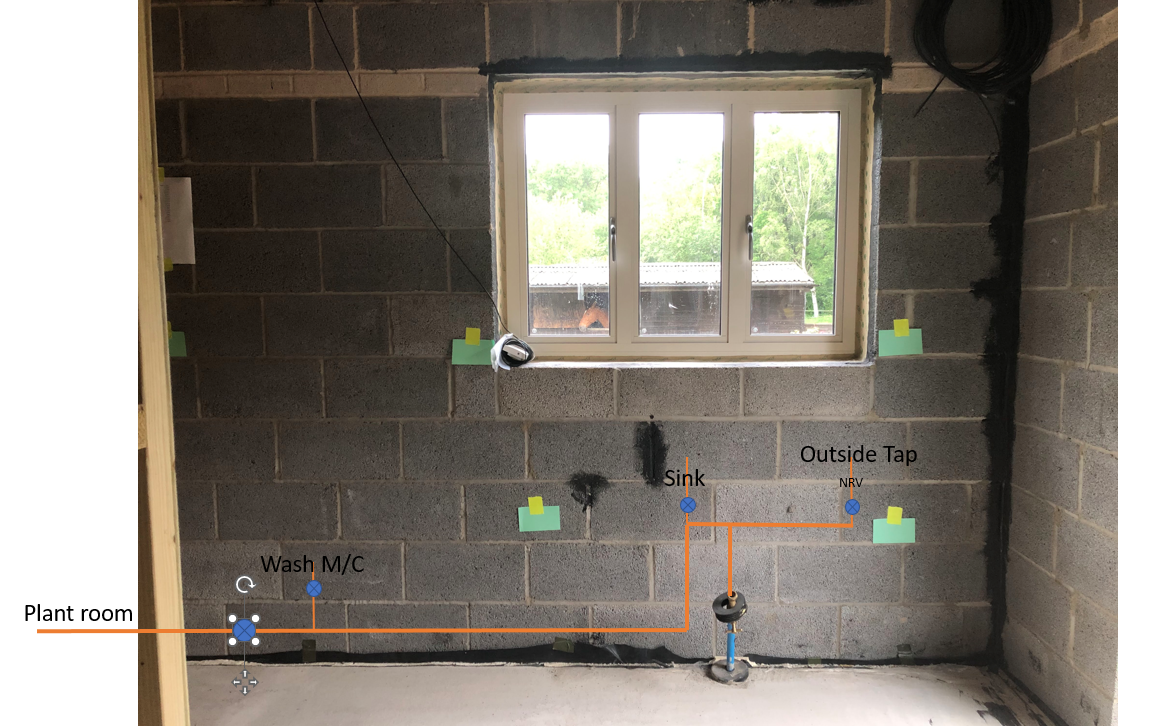

crispy_wafer Posted June 1, 2023 Author Share Posted June 1, 2023 Adding a few for decisions into the mix... I could do this A or B There is a likelyhood there will be cabinets covering the bulk of the pipework, except for in pic 1 where pipe goes past the wash m/c feed. Pic 2 I'm looking at concealing the pipe in a chase, And/Or behind D&D What do you reckon, Route A, or Route B? leaning towards A as its's simpler and less pipework Link to comment Share on other sites More sharing options...

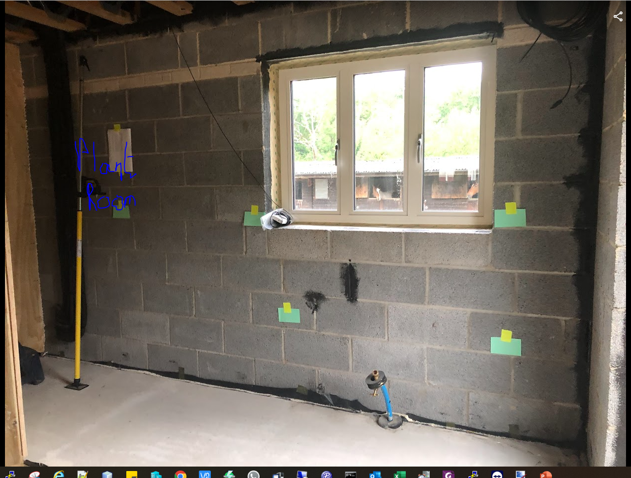

Dave Jones Posted June 1, 2023 Share Posted June 1, 2023 more incorrectly installed windows failing building regs. They need to be set back into the cavity so 70% of the frame is overlapping the insulation. Straps to fit. Not too late! Link to comment Share on other sites More sharing options...
crispy_wafer Posted June 1, 2023 Author Share Posted June 1, 2023 Cheers @Dave Jones is this 2022 regs or the older regs? Link to comment Share on other sites More sharing options...
Dave Jones Posted June 1, 2023 Share Posted June 1, 2023 i believe since 2020, doesnt matter though you dont want a crap job on your own place right ? Link to comment Share on other sites More sharing options...

Super_Paulie Posted June 2, 2023 Share Posted June 2, 2023 I'm in a similar situation, going to chase a wall this weekend. It does mean a transition from plastic to copper under the floor which I'm not keen on and I've decided to have my check valve at the manifold end instead of buried in a wall. I was planning on a flat metal bar to cover the chase incase I drill into it in the future. Which I will when I forget its there. I'm aware that's no help at all to you, but just to say that we are both gunna be chasing block, so good luck to ya. 1 Link to comment Share on other sites More sharing options...
Big Jimbo Posted June 2, 2023 Share Posted June 2, 2023 what ever you do don't put the washing machine valve behind the actual machine. Better behind a cupboard next to it with an access hatch. 1 Link to comment Share on other sites More sharing options...

Nickfromwales Posted June 2, 2023 Share Posted June 2, 2023 On 01/06/2023 at 08:37, crispy_wafer said: Cheers @Dave Jones is this 2022 regs or the older regs? As long as the material that lines the reveals doesn't contact the outer leaf, the detail that you have there will be perfectly fine. Oh, and option A defo not B (minus picking up the appliance). Link to comment Share on other sites More sharing options...
