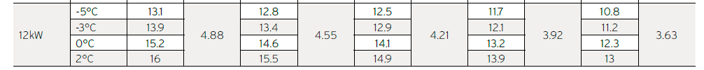

sharpener Posted June 1, 2023 Share Posted June 1, 2023 On 25/05/2023 at 16:43, billt said: I think you need to look at it more closely. Our house is a hotchpotch of additions carried out at different times with different construction methods and it is possible to model that in the heat punk calculator. You can enter fabric losses for each element in each room separately as well as air changes for each room. It should come up with a pretty accurate heat loss figure. In my case, very closely indeed(!) I have now done a more comprehensive heatpunk model including internal walls and individual rooms, which showed that for some reason the previous shell model was only half my house [it is two barns end-to-end]. Now it has been fixed, the total MCS heat requirement is a shade under 15kW. Since the Vaillant A+ 12 is very generously specced (unlike the Samsung HT 14 which is positively mendacious) I think that will suffice. There is MVHR and additional heating in the form of an AGA and a WBS which of course MCS won't allow for. Result is remarkably close to the central figure from the Heat Geek cheat sheet, 75 W/m^2. And reasonably consistent with the parsimonious 6kW average oil consumption required to heat only the zones I am using at any one time (kitchen plus two bedrooms or the living room). Still nothing heard from the two installers who came a week ago. A third contacted me courtesy of the Vaillant "find an installer" scheme, Daikin seem to have given up completely. Link to comment Share on other sites More sharing options...
JamesPa Posted June 1, 2023 Author Share Posted June 1, 2023 26 minutes ago, sharpener said: I have now done a more comprehensive heatpunk model including internal walls and individual rooms, which showed that for some reason the previous shell model was only half my house [it is two barns end-to-end]. Now it has been fixed, the total MCS heat requirement is a shade under 15kW. Since the Vaillant A+ 12 is very generously specced (unlike the Samsung HT 14 which is positively mendacious) I think that will suffice. There is MVHR and additional heating in the form of an AGA and a WBS which of course MCS won't allow for. I don't know if the vaillant 12kW stretches to 15 but you might need to lie a bit about the construction if it doesn't. MCS as you know requires that the system heat the whole house unless not reasonably practical so if the MCS calculation says 15 they might feel obliged to fit 15+. Obviously this is very installer dependent, hopefully you find a reasonable one. I'm sure you have worked this out yourself by now anyway. Link to comment Share on other sites More sharing options...
sharpener Posted June 1, 2023 Share Posted June 1, 2023 Yes, it will. This is what I meant by generously specced (columns are 35/40/45/50/55C flow), the superiority of the R290 is obvious cf the Samsung R32 offering: One issue is the design OAT, the heatpunk s/w gives -1.3 for my postcode whereas the MCS table has -0.2. Another is making sure they do not apply any uplift for near a river (should be an advantage IMO), or intermittency. Fortunately the EPC surveyor was generous in assessing the loft insulation thickness to avoid disqualification for BUS. (Makes damn all difference to the overall picture, payback for adding more is ~10years if DIY, awful job, ?twice that if contracted). Have just spotted I can reduce the U value of the walls from 2.27 to 1.86 by selecting the stock "610mm solid stone" instead of 600mm "sandstone". But it only reduces the heat loss by a few 100 W, further investigation of this required methinks! Link to comment Share on other sites More sharing options...
