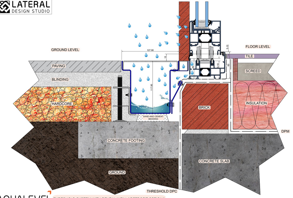

LSB Posted May 12, 2023 Share Posted May 12, 2023 (edited) I've had a bad night stressing about DPM, level threshold and BC. In our family room to the garden I want 2 level threshold doors, that's the easy bit. When I say level, I don't want to go to a slope or ramp, I want it to be level to the whole outside patio / garden for a wheelchair user to be able to go from inside to out without rolling away and then struggling to get back in. Terrible drawing below. The bit going down is the drain, the bit going up is the door. But, the DPM must be 150 above GGL ???? So, do we just do this which doesn't have the DPM 150 up, or is that covered by the drain. I've looked at our SE drawings, books, interweb and nothing explains how it meets the latest building regs. All our drawings were pre the BC change. I have a drawing which shows it from side on, but that doesn't cover the above question. I don't have any level thresh-hold in our current house and all the doors are steps to get in, too old for ramps or anything. We spoke to a guy last week who sells level thresh-hold drains and bizarrely he said, you can't do this in the UK, so why did he have a stand at an exhibition !!! We haven't finalised on our window / door supplier yet, we know the sizes, positions etc just not the finer details. By the way, this is French doors, not sliding or bifold, just 2 pairs of opening doors. Edited May 12, 2023 by LSB Link to comment Share on other sites More sharing options...
The Reverend Posted May 12, 2023 Share Posted May 12, 2023 The difficulty you will have is pooling, creep and wind driven rain. A common practice is to use a ramp up to a plateau and then cross the thresh-hold, see your local council flats entrance. I'm going to face the same issue but hoping a french drain in front of the doors will solve the 150mm issue. Link to comment Share on other sites More sharing options...
The Reverend Posted May 12, 2023 Share Posted May 12, 2023 This may help https://www.labcwarranty.co.uk/technical-blog/a-step-by-step-guide-to-level-thresholds Link to comment Share on other sites More sharing options...

LSB Posted May 12, 2023 Author Share Posted May 12, 2023 1 minute ago, The Reverend said: This may help https://www.labcwarranty.co.uk/technical-blog/a-step-by-step-guide-to-level-thresholds thanks, I've got a few of these drawings, but none of them cover what you do with the DPM which runs along the top of the foundation blocks. This is as per my 2nd terrible drawing. Link to comment Share on other sites More sharing options...
The Reverend Posted May 12, 2023 Share Posted May 12, 2023 For the UK it would be 150mm I think but LABC says 125mm 1 Link to comment Share on other sites More sharing options...
joe90 Posted May 12, 2023 Share Posted May 12, 2023 @LSB I did exactly as your lower drawing, (DPM dips under door frame) the patio slopes slightly to help rain run off and prevent puddling, and no drain, even with driving rain no problem. 1 1 Link to comment Share on other sites More sharing options...
Temp Posted May 12, 2023 Share Posted May 12, 2023 (edited) The DPM/DPC is meant to be 150mm above ground level to prevent rain splashing up above it. If you find another way to prevent it splashing it should be OK. Some people put a channel filled with gravel. Lots of example photos in here.. https://www.pavingexpert.com/splash_strips Edited May 12, 2023 by Temp 1 Link to comment Share on other sites More sharing options...

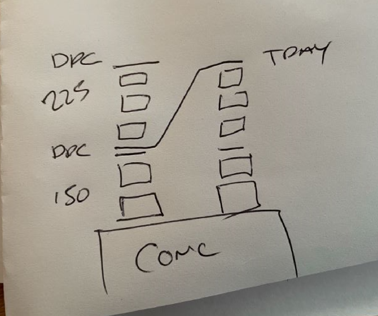

Dave Jones Posted May 13, 2023 Share Posted May 13, 2023 what you need is a vertical DPC. This is a cavity tray that allows you to 'move' the dpc higher up the wall. This allows a fully level threshold (with a suitable cill) and not having to worry about the normal 150mm limit. Same is used where you are building against sloping ground and need to protect the 'upslope' wall. Unless of course its a front door and they are automatically immune to the 150mm rule !! We have done this for every build as it costs peanuts and gives total flexibility. The example here moves DPC 225mm higher than normal. 1 Link to comment Share on other sites More sharing options...

Dave Jones Posted May 14, 2023 Share Posted May 14, 2023 need to make sure you have the vertical tray installed first on the walls. Link to comment Share on other sites More sharing options...
LSB Posted May 14, 2023 Author Share Posted May 14, 2023 9 minutes ago, Dave Jones said: need to make sure you have the vertical tray installed first on the walls. what is one of those - help Link to comment Share on other sites More sharing options...
Dave Jones Posted May 14, 2023 Share Posted May 14, 2023 drew you a picture 2 posts up Link to comment Share on other sites More sharing options...
LSB Posted May 14, 2023 Author Share Posted May 14, 2023 4 minutes ago, Dave Jones said: drew you a picture 2 posts up of course, thanks, head exploding with all the questions I have to answer. Link to comment Share on other sites More sharing options...
