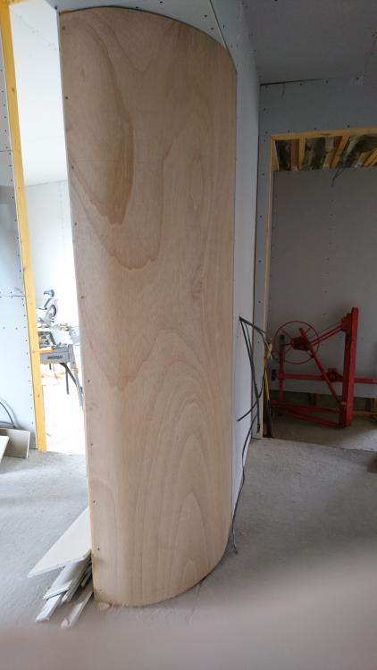

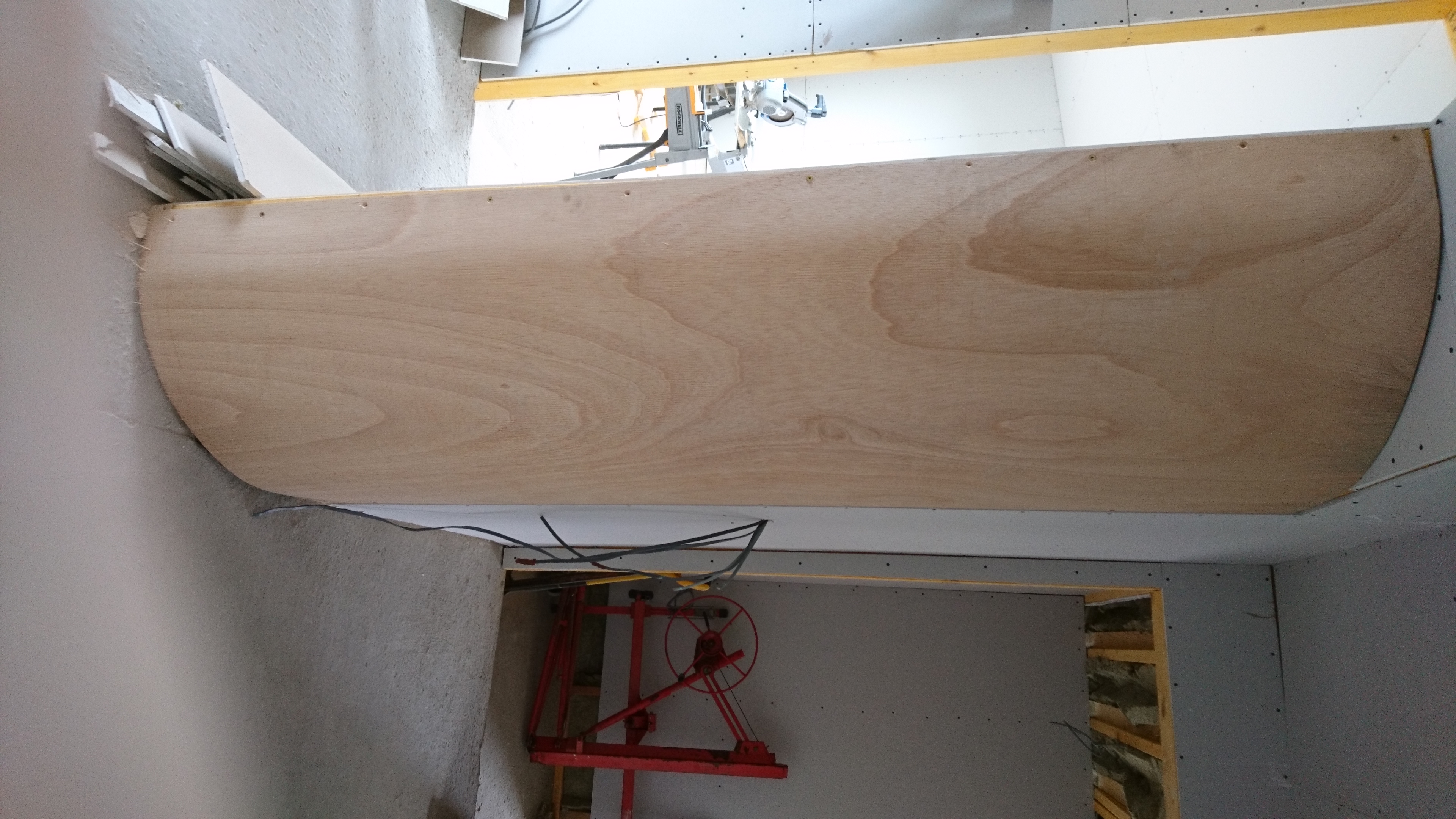

Hi folks,
For our curved wall sections, many people here and that have visited have commented on the lovely grain pattern on the ply I used for the curved wall.
I don't want to varnish but willing to do a lacquered paint finish if the grain will show through - any recommendations on a lacquer? Not really sure what I doing be buying or best way to apply?
I saw a staircase at a show where it was lacquered blur with the grain showing and it was lovely.

OSMO opaque colours works well although the sheen level is a little higher than you might want for internals.
Available in a range of colours or any colour to order. I.e. http://www.wood-finishes-direct.com/product/osmo-country-colour?gclid=EAIaIQobChMI-7Poyb3E1QIVbb7tCh2XYgeXEAQYASABEgKbbPD_BwE
It does need to be applied carefully though it doesn't like being applied thickly and will look glossy if over applied and you'll loose the wood grain you're wanting to achieve.
Practice on a scrap piece first.
Do you only have screw fixing vertically at each end? If so, don't forget to cover these with a matching wood product to define the start / stop points and provide a good break between the plaster / wood finishes. They'll need to be on before starting any final finishing work, plus you'll ideally want to bond those strips on so there's no surface fixings to fill. Laquers etc behave differently on wood fillers so, as said, practice on a sacrificial piece first.

No. Not without a stain first. There are various options but I wouldn't be brush or rag applying any wood stain to an area that large. Spraying is the only option really for the level of finish that I think you'll want. Clear lacquers can be tinted but again I wouldn't DIY that route.
In my reply I had assumed you wanted an opaque paint finish. If you actually want a tinted timber finish then there are a lot more options. If you're going down the DIY route then I would personally stick to oil/wax based products. They are much more forgiving. E.g. 3067 Light Grey or 3074 Graphite Osmo Tints. http://www.osmouk.com/sitechapter.cfm?chapter=82&page=250

Sorry. My post probably wasn't the clearest . The example I saw was a timber cabinet that was solid blue or green I think - but the grain was fully visible. The chap said is was lacquered rather than painted. I really liked the look but didn't know how easy it was to do.

Any thin coat product should allow the grain to show but its very timber dependent. If you ply is super smooth then don't expect the grain to suddenly appear through a solid coating.
Don't be confused by the term "lacquer". He will be referring to a "pre-catalysed" or "acid-catalysed" lacquer. i.e Morrells http://www.morrells.co.uk/pre-catalyst-lacquers-fastmatch-colours/ Both are available in clear or solid colours. Solid colours are "paint". He's just referring to a trade term. The advantage is that you can get great coverage thinly (using spray equipment) which preserves any grain.
You can also create a raised grain but it will be very dependent on the ply top layer. I wouldn't risk it.
A translucent colour will show the grain for obvious reasons.
