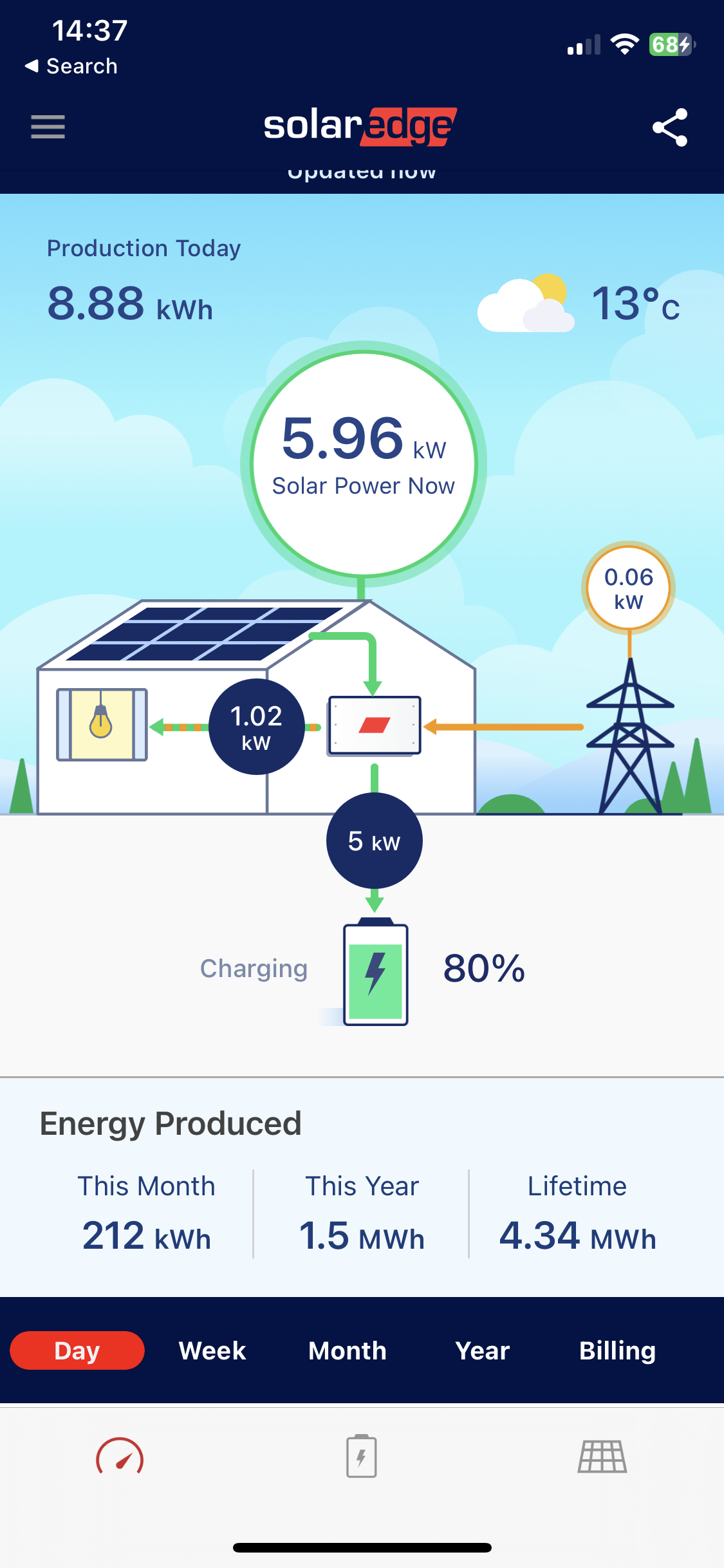

Pocster Posted May 10, 2023 Author Share Posted May 10, 2023 My installer has confirmed it ( with 1 inverter ) would be a 5kw charge limit ( as expected ) with excess going to the 2nd battery . It does reduce the chance of ‘missing’ pv generation of over 3.68 on full dc batteries …. Got nearly 6 today Link to comment Share on other sites More sharing options...
