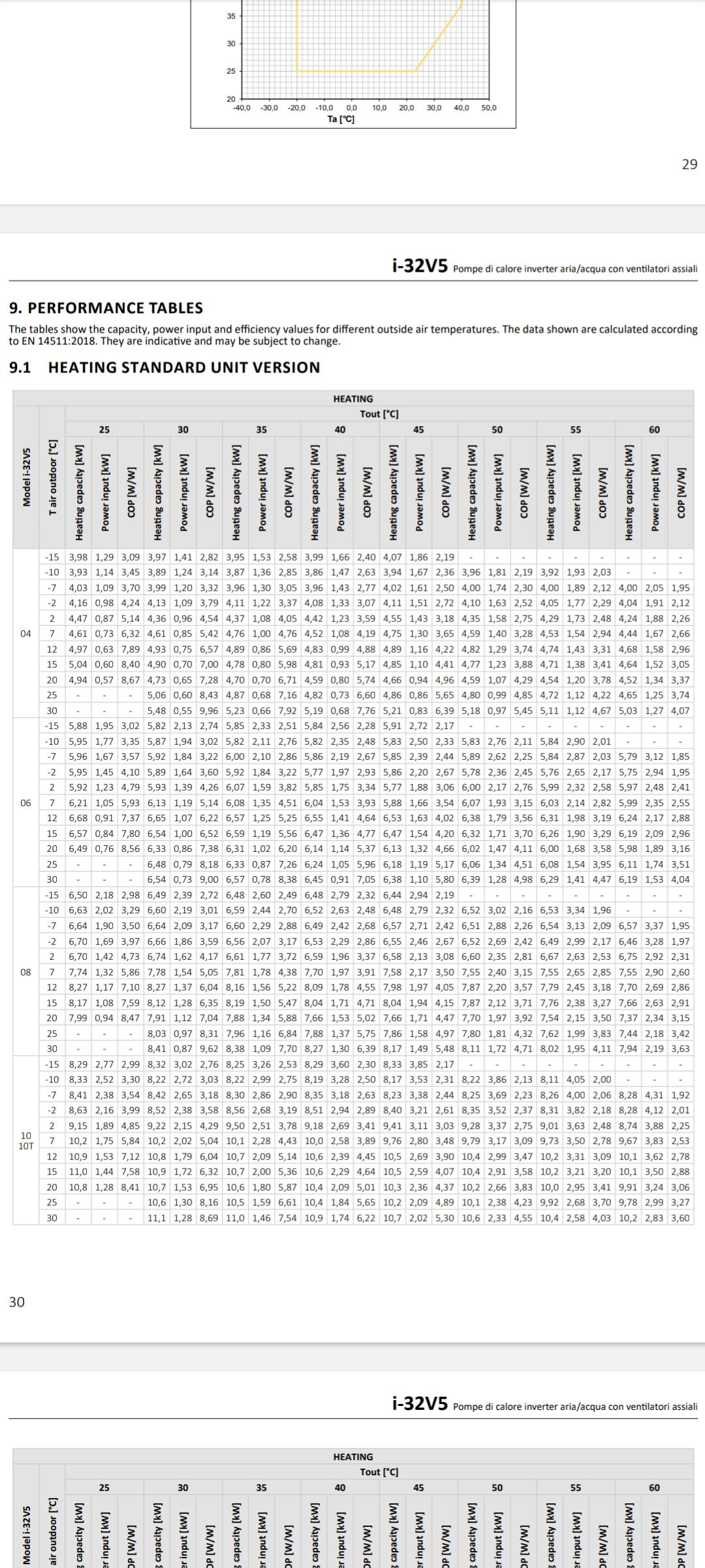

John Carroll Posted October 13, 2023 Posted October 13, 2023 On 07/05/2023 at 22:24, JohnMo said: Running UFH from an ASHP shouldn't be expensive in fact it's possibly one of the cheapest forms of heating when coupled to UFH. Low flow temperature leads to very good CoP. Attached is section out of our technical manual which gives, flow temperature, heating power and CoP, for reference. By the way you should be adding way more insulation, I doubt you even meet building regs minimum requirement, with 100mm. For UFH you ideally need around 150mm or more. Could you please post the above with Tout extending to its max, say ~ 60/65C. Thanks. John
JohnMo Posted October 13, 2023 Posted October 13, 2023 1 hour ago, John Carroll said: Could you please post the above with Tout extending to its max, say ~ 60/65C. Thanks. John 1
