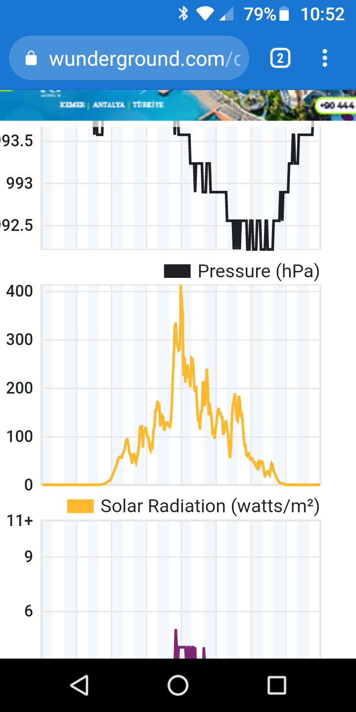

SteamyTea Posted May 8, 2023 Share Posted May 8, 2023 18 minutes ago, Marvin said: will us as an example Banbury UK to explain why I find it hard to believe that the panels are the reason: The peak of the height of the sun 2 days ago in Banbury We may be talking about different things. But here is a chart of horizontal plain solar power from Banbury on Saturday. Not a very impressive day, quite peaky. Link to comment Share on other sites More sharing options...
Marvin Posted May 8, 2023 Share Posted May 8, 2023 Yes I was using Banbury as an example. I do not know what part of the world @S2D2 lives in. I was using an example where IF Banbury was the location and had a completely sunny day what the suggested outcome would be IF the panels were over producing. M Link to comment Share on other sites More sharing options...
SteamyTea Posted May 8, 2023 Share Posted May 8, 2023 6 minutes ago, Marvin said: I was using Banbury as an example I generally use Leicester as my generic England PV spot. It is about halfway up, and halfway across the country, and reasonably flat. I have been to Banbury, made me cross. Link to comment Share on other sites More sharing options...
