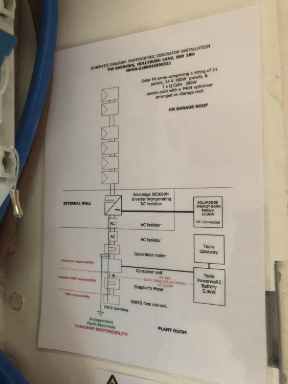

joth Posted May 4, 2023 Share Posted May 4, 2023 OK @pocster is too lazy find his prior post asking exact same question, so I did it for you. The schematic was eventually beaten out of him on page 6, here: The answer is your PV inverter is an SE3680H so can output 3.68kW MAXIMUM (sum across internal use, AC coupled battery charging and grid export). So if the AC coupled Tesla powerwall is charging at 3.68kW that will consume all of your PV generation and none will go to grid or other AC loads. As you were. 1 1 Link to comment Share on other sites More sharing options...
S2D2 Posted May 4, 2023 Share Posted May 4, 2023 6 minutes ago, joth said: OK @pocster is too lazy find his prior post asking exact same question, so I did it for you. The schematic was eventually beaten out of him on page 6, here: The answer is your PV inverter is an SE3680H so can output 3.68kW MAXIMUM (sum across internal use, AC coupled battery charging and grid export). So if the AC coupled Tesla powerwall is charging at 3.68kW that will consume all of your PV generation and none will go to grid or other AC loads. As you were. Max DC 5.7kW also, so if the inverter is pulling around 3.9kW DC side before losses for AC that leaves only 1.8kW headroom for charging the SE. 1 Link to comment Share on other sites More sharing options...

Pocster Posted May 4, 2023 Author Share Posted May 4, 2023 1 minute ago, S2D2 said: Max DC 5.7kW also, so if the inverter is pulling around 3.9kW DC side before losses for AC that leaves only 1.8kW headroom for charging the SE. But shouldn’t SE charge before Tesla - as it’s dc ?? Link to comment Share on other sites More sharing options...
joth Posted May 4, 2023 Share Posted May 4, 2023 13 minutes ago, pocster said: But shouldn’t SE charge before Tesla - as it’s dc ?? Depends how it is configured, but the default is maximize self use which would be yes. Up to 5kW PV generation, above that you hit the charge limit of the energy bank (it will only charge or discharge at 5kW) so your 7kW array could have 2kW spare that would go via the inverter and off to AC and hence to the PW, if it needs it. Also, LOL at your PV installer getting kW vs kWh wrong on both the batteries. They're a match for you made in heaven. There really is no hope. 1 Link to comment Share on other sites More sharing options...
Pocster Posted May 4, 2023 Author Share Posted May 4, 2023 (edited) 6 minutes ago, joth said: Depends how it is configured, but the default is maximize self use which would be yes. Up to 5kW PV generation, above that you hit the charge limit of the energy bank (it will only charge or discharge at 5kW) so your 7kW array could have 2kW spare that would go via the inverter and off to AC and hence to the PW, if it needs it. Also, LOL at your PV installer getting kW vs kWh wrong on both the batteries. They're a match for you made in heaven. There really is no hope. SE battery never set for “ self consumption “ because it can in certain circumstances steal from PowerWall ( that was the main problem in that original thread you linked too ) . So ! I do wonder why the installer didn’t put a larger ( thru put ) inverter in ? . I’m guessing cost wise ( for me ! ) not a great deal of difference? But as you say - as long as SE isn’t fully charged it can suck on 5k and potentially 2k to pw/home/grid Edited May 4, 2023 by pocster Installer in a lazy twat also Link to comment Share on other sites More sharing options...
S2D2 Posted May 4, 2023 Share Posted May 4, 2023 4 minutes ago, pocster said: SE battery never set for “ self consumption “ because it can in certain circumstances steal from PowerWall ( that was the main problem in that original thread you linked too ) . So ! I do wonder why the installer didn’t put a larger ( thru put ) inverter in ? . I’m guessing cost wise ( for me ! ) not a great deal of difference? But as you say - as long as SE isn’t fully charged it can suck on 5k and potentially 2k to pw/home/grid If the SE is pulling 5kW you will only have 0.7kW left to go to AC due to the DC limit. It was probably a fast track G99 or something, which was limited to 2x3.68kW devices. 1 Link to comment Share on other sites More sharing options...
Pocster Posted May 4, 2023 Author Share Posted May 4, 2023 1 minute ago, S2D2 said: If the SE is pulling 5kW you will only have 0.7kW left to go to AC due to the DC limit. It was probably a fast track G99 or something, which was limited to 2x3.68kW devices. Is it worth changing the inverter ? I guess the real question is how often ( if ever ) will I get 5.7kw of pv ( as that’s the limit as you suggest ) . My pv array is split across 2 roofs ; so the array limit of 7kw would only ever be theoretical . Link to comment Share on other sites More sharing options...
S2D2 Posted May 4, 2023 Share Posted May 4, 2023 8 minutes ago, pocster said: Is it worth changing the inverter ? I guess the real question is how often ( if ever ) will I get 5.7kw of pv ( as that’s the limit as you suggest ) . My pv array is split across 2 roofs ; so the array limit of 7kw would only ever be theoretical . Yes it depends how long you spend generating more than 5.7kW PV. The answer is probably no but depends on the install. PVGIS hourly data gives an inaccurate estimate of this or you can review the data in your online account for the inverter to see if you've had much clipping. Link to comment Share on other sites More sharing options...

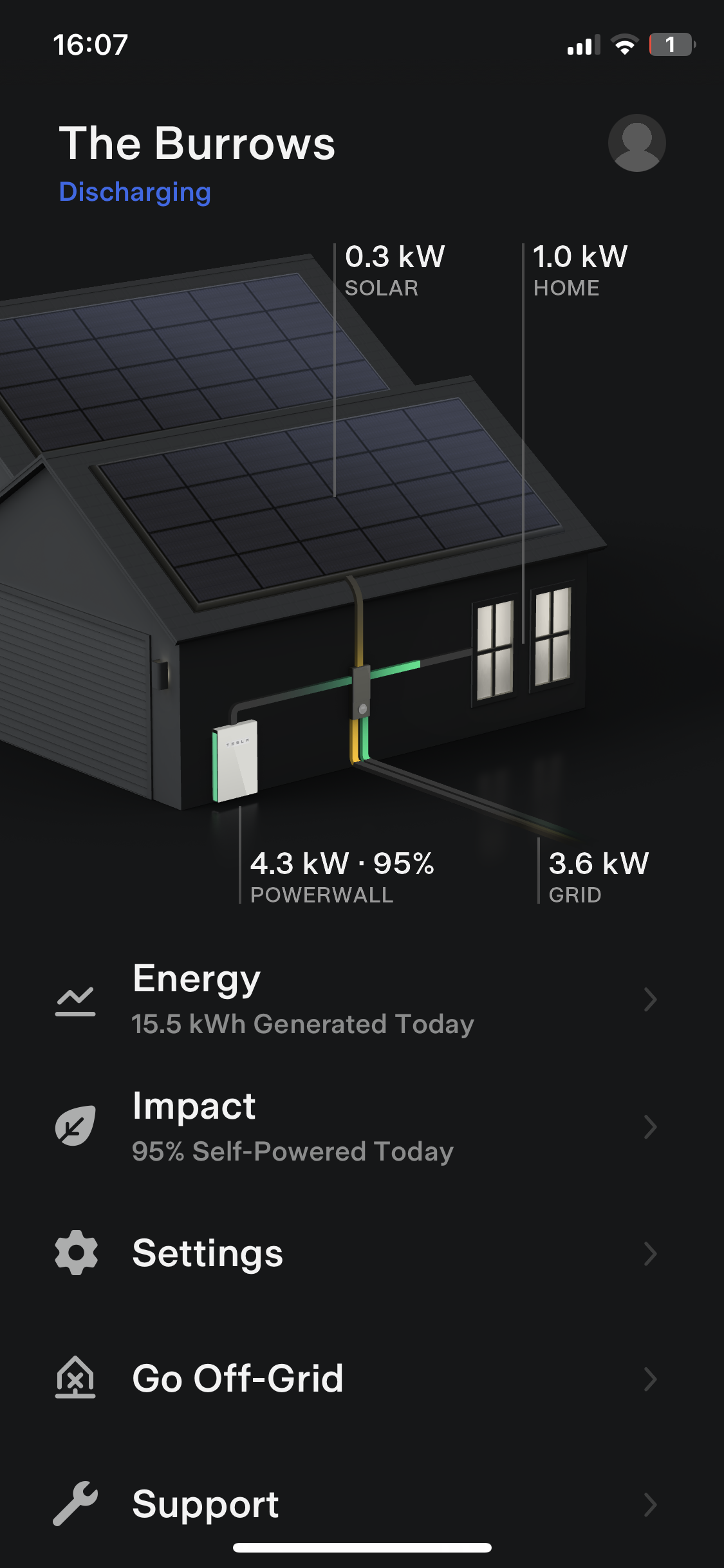

Pocster Posted May 4, 2023 Author Share Posted May 4, 2023 Hmmm Dno says my max export is 8.6kw I take that as 3.6 pv + 5 pw Yet I’ve never got PW to export over 3.7 ! . I know the gateway effectively has a limiter ) - wonder if that’s set incorrectly ?? Link to comment Share on other sites More sharing options...
joth Posted May 4, 2023 Share Posted May 4, 2023 2 minutes ago, pocster said: So ! I do wonder why the installer didn’t put a larger ( thru put ) inverter in ? . I’m guessing cost wise ( for me ! ) not a great deal of difference? Because you originally had 14 x 300W panels, i.e. 4.2kWp so a 3.68kW inverter was a fairly sensible choice and avoided G99 admin, but when you added the 7x 390W panels this started to look a worse idea. In the thread I linked before I asked you why such an undersized inverter and you said you were too tight to replace it. A cookie for whoever can be arsed to dig out the citation - I can't 🤣 Looking through photos it seems the SE is also setup for export limitation, which presumably is in the case PW is exporting (would it ever be?) it shuts off SE to keep the sum within $whatever limit it was set to. Link to comment Share on other sites More sharing options...
Pocster Posted May 4, 2023 Author Share Posted May 4, 2023 10 minutes ago, joth said: Because you originally had 14 x 300W panels, i.e. 4.2kWp so a 3.68kW inverter was a fairly sensible choice and avoided G99 admin, but when you added the 7x 390W panels this started to look a worse idea. In the thread I linked before I asked you why such an undersized inverter and you said you were too tight to replace it. A cookie for whoever can be arsed to dig out the citation - I can't 🤣 Looking through photos it seems the SE is also setup for export limitation, which presumably is in the case PW is exporting (would it ever be?) it shuts off SE to keep the sum within $whatever limit it was set to. Original install was pw and 4kw pv and *whatever* inverter Additions by different company added SE battery , additional PV and changed the inverter . I can’t be held accountable for what I said in the past . Lifetime of anything I post being valid is around 3 minutes ( like the film memento - though having said that I don’t really remember it all ) 1 Link to comment Share on other sites More sharing options...

Dillsue Posted May 5, 2023 Share Posted May 5, 2023 21 hours ago, pocster said: Hmmm Dno says my max export is 8.6kw I take that as 3.6 pv + 5 pw Yet I’ve never got PW to export over 3.7 ! . I know the gateway effectively has a limiter ) - wonder if that’s set incorrectly ?? AFAIK PW2 can be set to 0kw, 3.68kw(for G98 compliance) or 5kw export. Your SE3680 is limited to 3.68kw as it is without any other export limitation. If youre only see max 3.68kw from your PW then that seems set wrong. Maybe needs upping to 5kw if youve got DNO approval for that. Not sure that photo of your schematic from your other thread is correct as the Gateway doesnt seem in the right place?? 1 Link to comment Share on other sites More sharing options...
