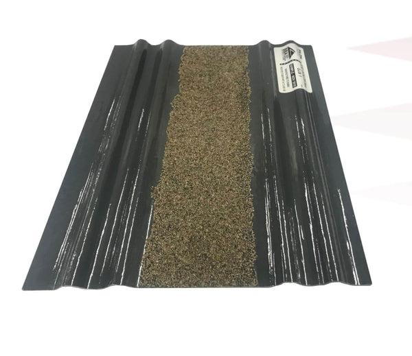

DaveAF Posted April 30, 2023 Share Posted April 30, 2023 Hello We live in a 1930s terraced house. Our new neighbours just retiled their roof and the roofers used a bonding gutter where the roofs tiles meet. They have left a 3 inch space between the 2 roofs and tiles on both roofs are kicking up where they sit on the bonding gutter. I'm concerned about water getting under the raised up tile edges on our side because we do not have felt under our tiles and the roofers haven't bedded our edge tiles in mortar. See the 2 attached pictures. Our roof is the orange tile. Do I have anything to worry about? All thoughts welcome. Regards David Link to comment Share on other sites More sharing options...
Big Jimbo Posted April 30, 2023 Share Posted April 30, 2023 The neighbours new roof is going to leak. That cut tile nearest the guttering is tipping up to the point that any water ingress is never going to reach the gutter. The neighbours new roof does not look like it has been done by a propper roofer. More like somebody chancing it. I am not a roofer, so i dont know if your tiles should have been mucked in. 1 1 Link to comment Share on other sites More sharing options...
Temp Posted April 30, 2023 Share Posted April 30, 2023 (edited) Installation instructions.. See cross section bottom right of last page. There shouldn't even be a gap.. https://www.europeanplastics.co.uk/_files/ugd/a1adc3_ae879888910049cb93079fa54eb2232b.pdf?index=true The sanded strip down the middle is to provide a key for the mortar to stick to. Edited April 30, 2023 by Temp 1 1 Link to comment Share on other sites More sharing options...

DaveAF Posted May 1, 2023 Author Share Posted May 1, 2023 15 hours ago, Temp said: Installation instructions.. See cross section bottom right of last page. There shouldn't even be a gap.. https://www.europeanplastics.co.uk/_files/ugd/a1adc3_ae879888910049cb93079fa54eb2232b.pdf?index=true The sanded strip down the middle is to provide a key for the mortar to stick to. Yeah as I feared its a total cowboy job. They've even cut tiles in half on both roofs. Link to comment Share on other sites More sharing options...
Big Jimbo Posted May 1, 2023 Share Posted May 1, 2023 Only thing to do now, is to tell your neighbour you want it sorted by a proper roofer. Get a couple of quotes yourself, and advise your neighbour that they will be paying. Link to comment Share on other sites More sharing options...
