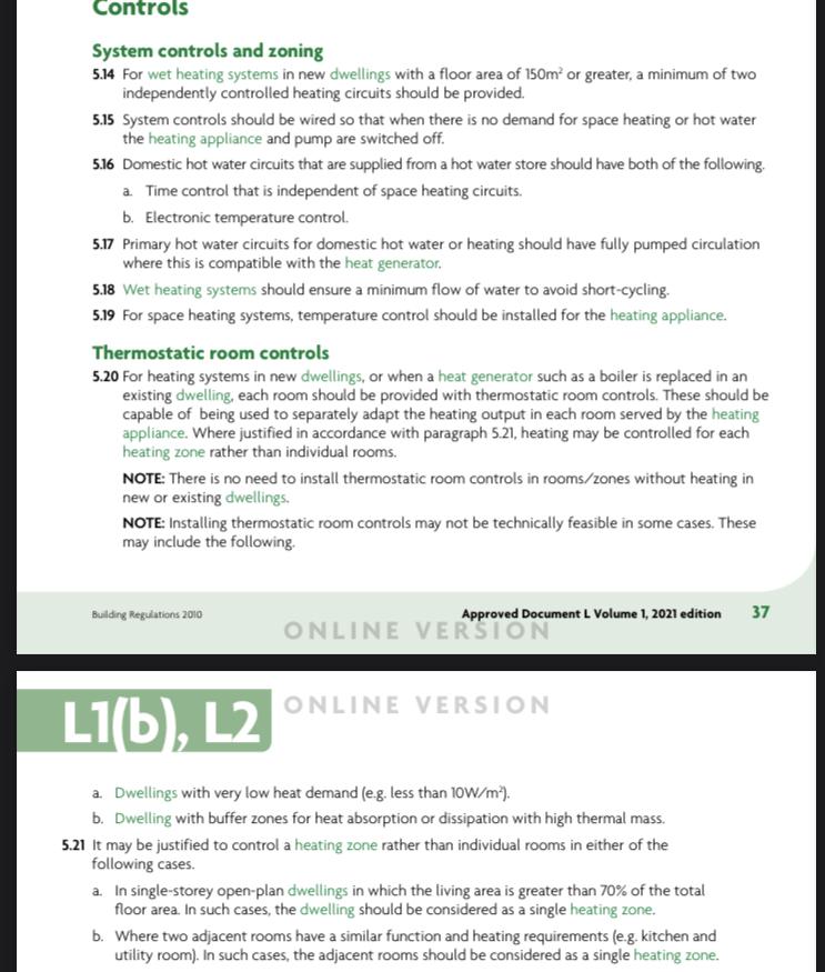

joth Posted July 3, 2023 Share Posted July 3, 2023 3 hours ago, JohnMo said: Also while I'm on a roll all new cylinders should by law only be able to be sold if they are heat pump ready i.e. 3m2 coil installed, even in a direct cylinder. Right, and while you're on that roll, can you go ahead and re-write Approved Document L section 6.51? That's the part that requires each room to have it's own thermostat with per-room schedule, adjustable by the home owner, and that will ruin the system designer's attempt to run a carefully balanced whole-house heating strategy. For a self-builder this is moot (you can skip the controls and chance it, or install the controls and not use them - so just some wasted capital cost) but for the target of this conservation, it's installing an "energy saving feature" that the more the home owner uses it, the worse the system performs. Link to comment Share on other sites More sharing options...
DanDee Posted July 3, 2023 Share Posted July 3, 2023 (edited) 26 minutes ago, joth said: Right, and while you're on that roll, can you go ahead and re-write Approved Document L section 6.51? That's the part that requires each room to have it's own thermostat with per-room schedule, adjustable by the home owner, and that will ruin the system designer's attempt to run a carefully balanced whole-house heating strategy. For a self-builder this is moot (you can skip the controls and chance it, or install the controls and not use them - so just some wasted capital cost) but for the target of this conservation, it's installing an "energy saving feature" that the more the home owner uses it, the worse the system performs. Are you referring to this? Edited July 3, 2023 by DanDee Link to comment Share on other sites More sharing options...

joth Posted July 3, 2023 Share Posted July 3, 2023 2 hours ago, DanDee said: Are you referring to this? LOL yes that section is clearly for cooling only. I'm sure there was a requirement for heating controls to have room by room schedule but I can't find it now... nearest I can find now is this table. Anyway yeah I agree the point has to be a set of room-wise controls designed and installed for the combi aren't going to be a automatically re-applicable for an ASHP without some redesign / reconfig, which is what the OP was asking for, but this will need adding to the BOM on any retrofit (in place of the buffer and other stuffs) Link to comment Share on other sites More sharing options...

DougMLancs Posted July 4, 2023 Share Posted July 4, 2023 It’s this part for heating. Link to comment Share on other sites More sharing options...
JamesPa Posted July 4, 2023 Share Posted July 4, 2023 9 hours ago, joth said: LOL yes that section is clearly for cooling only. I'm sure there was a requirement for heating controls to have room by room schedule but I can't find it now... nearest I can find now is this table. Anyway yeah I agree the point has to be a set of room-wise controls designed and installed for the combi aren't going to be a automatically re-applicable for an ASHP without some redesign / reconfig, which is what the OP was asking for, but this will need adding to the BOM on any retrofit (in place of the buffer and other stuffs) 1 hour ago, DougMLancs said: It’s this part for heating. So taking these together I suppose that 'time and temperature zone control' is one time and temperature controller per zone (or house) and then the second bit mandates TRVs in each (or most) rooms. At least TRVs are cheap, but it does mean that the customer has to be educated to use them sensibly and begs the question, how do you ensure that a minimum number are left open to ensure sufficient system volume if they don't use them sensibly? If you conclude you can't then the only option, because of the regulations, appears to be to add a volumizer/2 port buffer the volume of which is just a shade less than the minimum system volume required by the unit (because, at least in in theory, every TRV bar one could be closed and the system still running, or wore still the master temp setting could be set high, the rads completely unbalanced and installers rely on the TRVs to sort it out). Two control systems working independently against each other, never good engineering, yet mandated by regulation! Hmm, there is a system design/customer education problem to solve here. Minimum system volume, as I understand it, solves two problems namely a) it reduces short cycling and b) it preserves a reserve of heat for defrost. Interestingly a) is more likely at elevated OATs and b) occurs at low, but not lowest, OATs. I wonder what the ASHP manufacturers themselves are thinking is the direction of travel with this one. Link to comment Share on other sites More sharing options...
