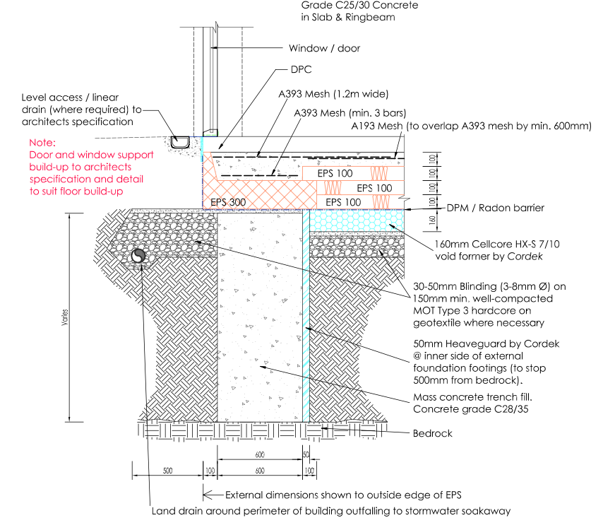

Thorfun Posted April 24, 2023 Share Posted April 24, 2023 morning all. I'm pretty sure I know the answer to this one but I'm just after confirmation before I do something stupid. our ground floor rooms not above our basement have this makeup below ground. so the entire insulated slab is wrapped in a layer of DPM. Do I still need to put a DPM below the internal insulation that I'm putting down before the liquid screed. (obviously, I know about the layer of DPM above the insulation before the screed). from my search I've seen other posts where a layer of DPM is done under the insulation but that's because it's direct on the ground so not sure that is relevant in my situation. Link to comment Share on other sites More sharing options...

saveasteading Posted April 24, 2023 Share Posted April 24, 2023 Excuse me going way back on this. Building on bedrock. Why do you need the cordek, which is for the severe expansion of clay? 1 Link to comment Share on other sites More sharing options...
Thorfun Posted April 24, 2023 Author Share Posted April 24, 2023 3 minutes ago, saveasteading said: Excuse me going way back on this. Building on bedrock. Why do you need the cordek, which is for the severe expansion of clay? coz the SE said so!? 😉 1 1 Link to comment Share on other sites More sharing options...
Thorfun Posted April 24, 2023 Author Share Posted April 24, 2023 1 hour ago, nod said: Yes dmp below and a fly sheet on the top but even if my structural reinforced insulated slab is already wrapped in DPM below ground? seems superfluous to then DPM on top of that already wrapped in DPM slab. 😕 Link to comment Share on other sites More sharing options...
saveasteading Posted April 24, 2023 Share Posted April 24, 2023 1 hour ago, Thorfun said: the SE said so!? 😉 Ok. I was wondering if this was a design borrowed from somewhere else or standard design by a kit building company. SE presumably knows you site. Still, it all looks rather over cautious. I don't know the circumstances of course. You have rock at a "variable" depth which the footings sit straight on....great. Then an insitu reinforced suspended slab. Presumably the ground is really poor quality? But if it is stronger than eps then it should be usable. Up to you of course but it is trebling your floor cost, and making it specialist. Perhaps for good reason. Ask again why? Link to comment Share on other sites More sharing options...
Thorfun Posted April 24, 2023 Author Share Posted April 24, 2023 32 minutes ago, saveasteading said: Ok. I was wondering if this was a design borrowed from somewhere else or standard design by a kit building company. SE presumably knows you site. Still, it all looks rather over cautious. I don't know the circumstances of course. You have rock at a "variable" depth which the footings sit straight on....great. Then an insitu reinforced suspended slab. Presumably the ground is really poor quality? But if it is stronger than eps then it should be usable. Up to you of course but it is trebling your floor cost, and making it specialist. Perhaps for good reason. Ask again why? well, it's all a bit moot now anyway as the superstructure is up and all the foundations were finished and paid for about 18 months ago! but we have clay here and are surrounded by woodland and we have a basement which these above ground 'arms' of our building are against. so it's quite complicated but i asked the SE for an insulated slab under the basement and 'arms' and that's what they gave me. if it's overly cautious then i'm ok with that. better safe than sorry. 1 Link to comment Share on other sites More sharing options...

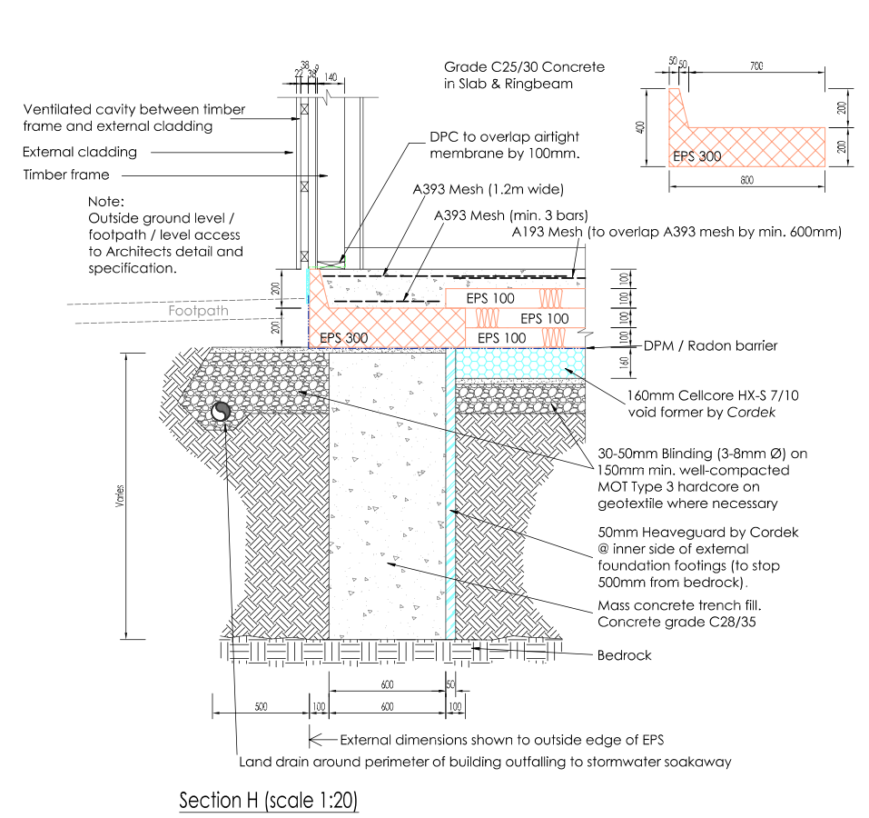

Thorfun Posted April 24, 2023 Author Share Posted April 24, 2023 9 minutes ago, nod said: I don’t make the rules If you put any studs on top of the screed BC will still want a strip of dpc under them I think we're getting our wires crossed here @nod! our external walls have a strip of DPC under the sole plate. I apologise that the original image doesn't show that detail but here's one that does. so this is already built as is shown. we have a DPM under the insulation and structural slab with DPC strip below the sole plate and TF attached to sole plate. so all good so far. above the slab I am having a screed to cover the UFH pipes. below this liquid screed I am adding 50mm EPS100 to build up the depth (which reduces the thickness of the screed) and also to fix the UFH pipes to. do I still need a DPM under that insulation? it is internal and sitting on a structural slab that is wrapped in DPM externally. hope that makes sense! Link to comment Share on other sites More sharing options...

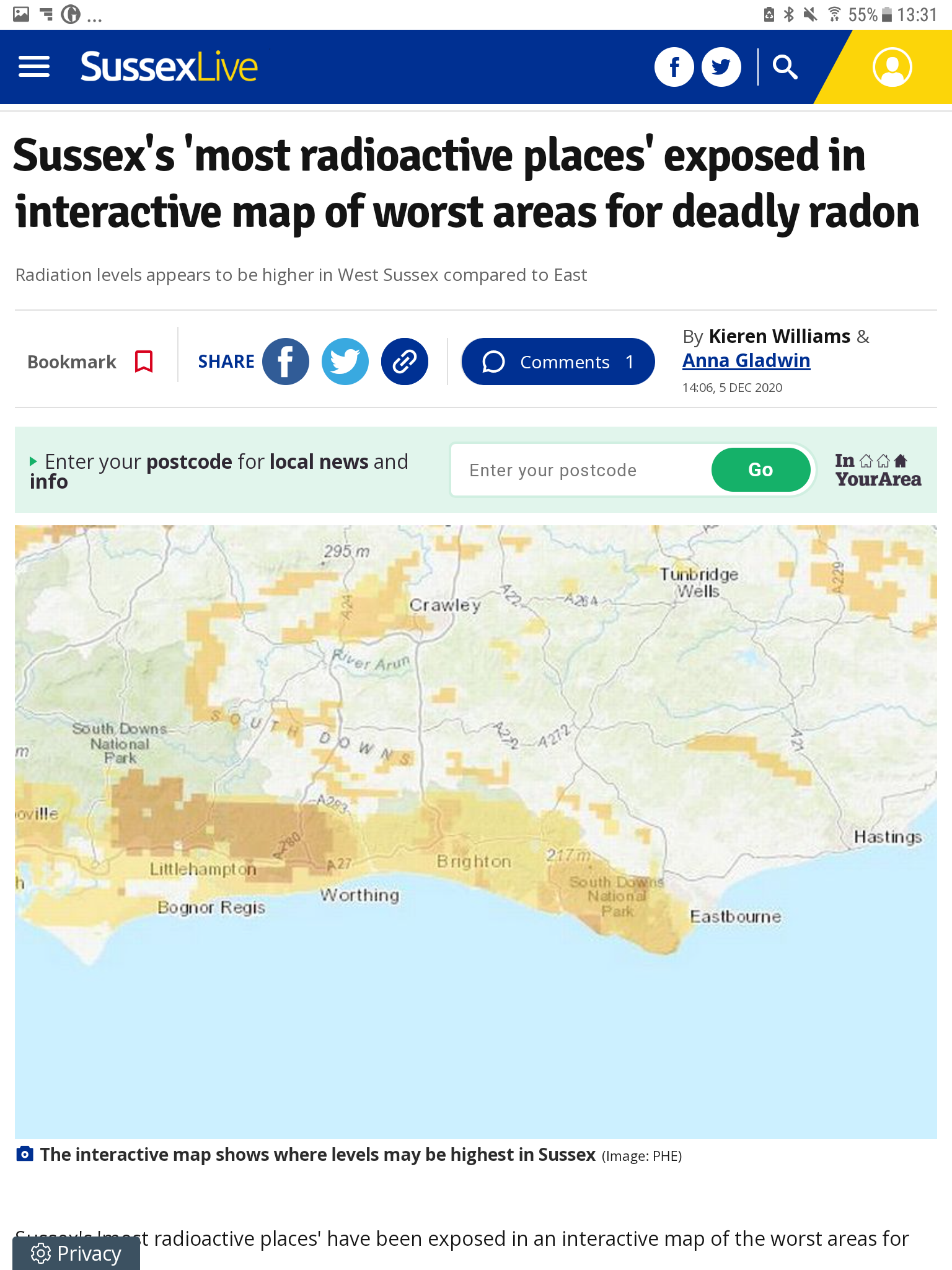

saveasteading Posted April 24, 2023 Share Posted April 24, 2023 23 minutes ago, Thorfun said: GI didn't show any so we just used basic DPM. See map here. If you are on the yellow then i would upgrade to radon quality. If it is marginal then there is a more precise map. Link to comment Share on other sites More sharing options...

Thorfun Posted April 24, 2023 Author Share Posted April 24, 2023 18 minutes ago, saveasteading said: See map here. If you are on the yellow then i would upgrade to radon quality. If it is marginal then there is a more precise map. no yellow where we are. 🙂 1 Link to comment Share on other sites More sharing options...
Thorfun Posted April 24, 2023 Author Share Posted April 24, 2023 15 minutes ago, saveasteading said: I'm just thinking that there seem to be lots of changes since this drawing. Keeps the bco happy for £30 of unnecessary plastic. Slip layers are often helpful too. no changes, it's just that the SE drawing didn't have the insulation under the screed and is missing the sole plate but the architect's BR drawings that went to BCO did and BCO didn't say anything. Link to comment Share on other sites More sharing options...
saveasteading Posted April 24, 2023 Share Posted April 24, 2023 36 minutes ago, Thorfun said: No yellow where we are. 🙂 Good. Shouldn't have been on the drawing though. Are you getting the drawings revised to 'as built'. While on the subject , if you ever needed proof of no radon requirement, it comes up on that map as a postcode search , and a formal certificate costs £5. Link to comment Share on other sites More sharing options...
