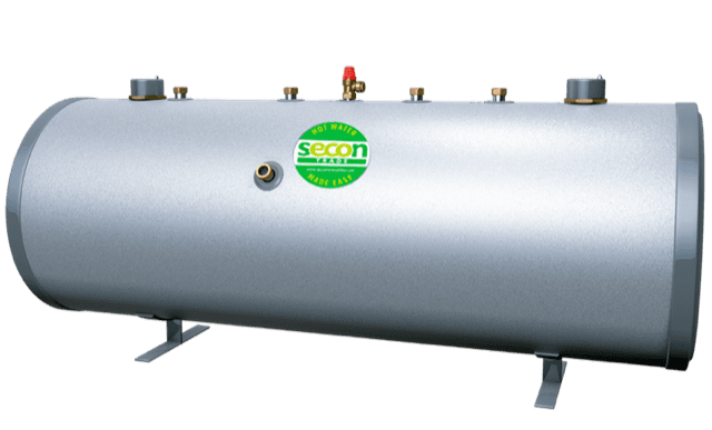

lakelandfolk Posted April 28, 2023 Author Share Posted April 28, 2023 The attached image is for a Seconrenewables trade Horizontal ASHP 200L cylinder which would fit our space. Our existing cylinder is 210L and more than adequate so capacity would be fine. It has 2 x immersion heaters so I am hoping it would allow me to connect my existing PV Solar IBoost. ie one heater to surplus solar and one heater to off peak grid. 1. Would that cause any problems with the functions of the pump? Presumably the IBoost would take care of the legionnaire cycle. I want to present this option to Octopus when they come back to do a second survey Link to comment Share on other sites More sharing options...
ProDave Posted April 28, 2023 Share Posted April 28, 2023 3 minutes ago, lakelandfolk said: The attached image is for a Seconrenewables trade Horizontal ASHP 200L cylinder which would fit our space. Our existing cylinder is 210L and more than adequate so capacity would be fine. It has 2 x immersion heaters so I am hoping it would allow me to connect my existing PV Solar IBoost. The water from an ASHP is usually heated to a lower temperature, so while a 210L tank heated from a boiler may be adequate, a 200L tank heated to a lower temperature from an ASHP might not be. Top mounted immersion heaters are a poor relation, as another recent thread has shown. Is there no way you can get a vertical tank in? 1 Link to comment Share on other sites More sharing options...
lakelandfolk Posted April 28, 2023 Author Share Posted April 28, 2023 Yes, I think we might have space in the boot room for e vertical 200/250L version, but again could we make use of the Solar IBoost? Does anyone manufacture a vertical with 2 x immersion bosses? Link to comment Share on other sites More sharing options...
JohnMo Posted April 28, 2023 Share Posted April 28, 2023 Cylinders2go, will make configuration you want, I believe, so will most UK manufacturers. 1 Link to comment Share on other sites More sharing options...
sharpener Posted April 28, 2023 Share Posted April 28, 2023 1 hour ago, lakelandfolk said: It has 2 x immersion heaters so I am hoping it would allow me to connect my existing PV Solar IBoost. ie one heater to surplus solar and one heater to off peak grid. 1. Would that cause any problems with the functions of the pump? Presumably the IBoost would take care of the legionnaire cycle. It will be more efficient to heat the water with the HP while the temp is low enough. You might need to arrange a timer and/or a tank stat so that you close the valve from the HP to the coil and switch on the iBoost or off-peak when the tank gets as hot as the HP can achieve. This will also overcome @ProDave's objection as the water will still get as hot as it used to. Gledhill have an enormous range of tanks in lots of configurations and IIRC will also make specials to order. 1 Link to comment Share on other sites More sharing options...

Steve W Posted May 4, 2023 Share Posted May 4, 2023 I have a Solar iBoost that connects to the single emersion heater which heats the water to 60C+ on a sunny day. The legionella functions in the ASHP are disabled and there in no connection from the ASHP to the DHW immersion heater. 1 Link to comment Share on other sites More sharing options...
