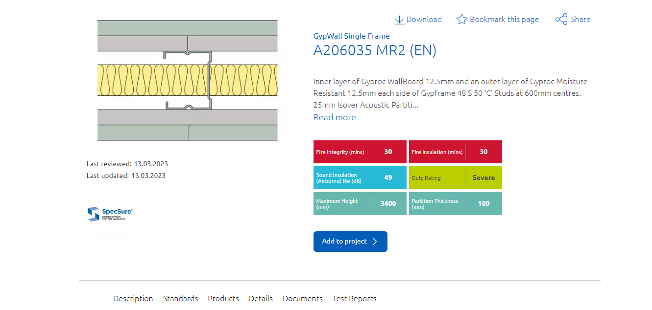

richo106 Posted April 19, 2023 Posted April 19, 2023 Hi All I am planning on using metal stud for a couple bedroom and landing partition walls I was planning on using 70mm stud but the builder has plenty of 50mm stud that he doesn't want and said I could have My plan was to use the 50mm stud, 2 x 12.5mm soundbloc plasterboards either side with 50mm acoustic insulation in the middle Would this be suitable? Many Thanks

richo106 Posted April 19, 2023 Author Posted April 19, 2023 20 minutes ago, nod said: As long as you are no more than 2.5 50 mil will free stand With two layers of PB Don’t forget to stagger each layer Then stagger opposite on the other side My first floor is only 2.4m but my ground floor is 2.6m. I have attached my wall make up
nod Posted April 19, 2023 Posted April 19, 2023 2 hours ago, richo106 said: My first floor is only 2.4m but my ground floor is 2.6m. I have attached my wall make up You will just about get away with that if you double the studs up They will clip inside each other Fix them together with a pan head screw
