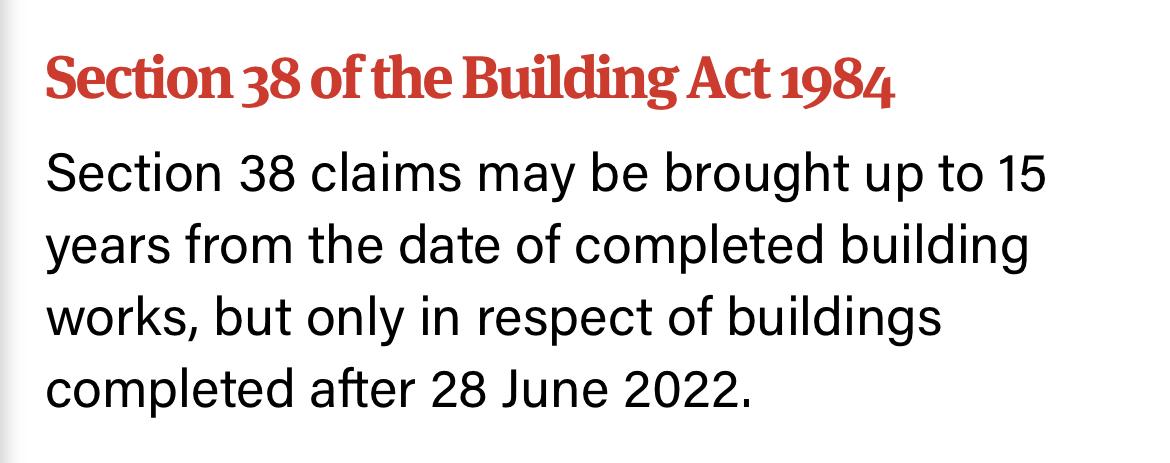

Lofty718 Posted April 6, 2023 Author Share Posted April 6, 2023 7 hours ago, Temp said: When did the BCO approve the drawings? Was it before or after end of June 22? It appears Section 38 of the Building Control Act 1984 _may_ make BCO liable but it only came into force on about 28th June 22 with the Building Safety Act. https://www.mishcon.com/news/introduction-of-section-38-building-act-1984 Interesting thanks for posting this. I been digging and found this about section 38 Link to comment Share on other sites More sharing options...
Adsibob Posted April 6, 2023 Share Posted April 6, 2023 20 hours ago, Lofty718 said: It was an architectural technician not an actual ARB architect. However surely they should still have a responsibility to know the regs (in my opinion) Were they holding themselves out to you as a member of the Chartered Institute of Architectural Technologists (CIAT)? (Check their website, any footers under their email signature or letters after their name in their email signature. Also check the CIAT register. If they were, then yes they probably have some duty of care to you. 20 hours ago, Lofty718 said: I was not aware I could use a fire curtain You definitely can use a fire curtain. You may need a fire engineer's report to satisfy to BCO that this woudl work, but that would be required with a mist suppression system anyway. Just more paperwork and fees, but such is life. 20 hours ago, Lofty718 said: the BCO said door, sprinklers or misting system. Yes, but the BCO has also been incompetent here, so you need to start taking everything they say with several pinches of salt. 20 hours ago, Lofty718 said: However I do not know how a fire curtain would look, the ceiling is flat and square but space is limited, I can't really find many examples of domestic fire curtains anywhere online There are some pictures here: https://www.coopersfire.com/sectors/domestic-housing/ You basically need to cut out a recess for the curtain, which is more like a roller blind. That needs power. In the event of a fire a sensor releases the blind and it drops down to effectively create a fireproof barrier between two spaces. Simples. Link to comment Share on other sites More sharing options...
Adsibob Posted April 6, 2023 Share Posted April 6, 2023 10 hours ago, Lofty718 said: Interesting thanks for posting this. I been digging and found this about section 38 If that is correct, then you're fine, as you can just say it's not been "completed" yet. Presumably you haven't been able to get a completion certificate yet, so easy to prove it's not completed yet. But it would surprise me if that was correct, because it would be an example of legislation with retrospective effect, which is pretty rare in a modern democracy. Link to comment Share on other sites More sharing options...

Lofty718 Posted April 6, 2023 Author Share Posted April 6, 2023 1 hour ago, Adsibob said: If that is correct, then you're fine, as you can just say it's not been "completed" yet. Presumably you haven't been able to get a completion certificate yet, so easy to prove it's not completed yet. But it would surprise me if that was correct, because it would be an example of legislation with retrospective effect, which is pretty rare in a modern democracy. These laws are still being implemented, it's quite vague but I believe it was giving royal assent last year. Link to comment Share on other sites More sharing options...
