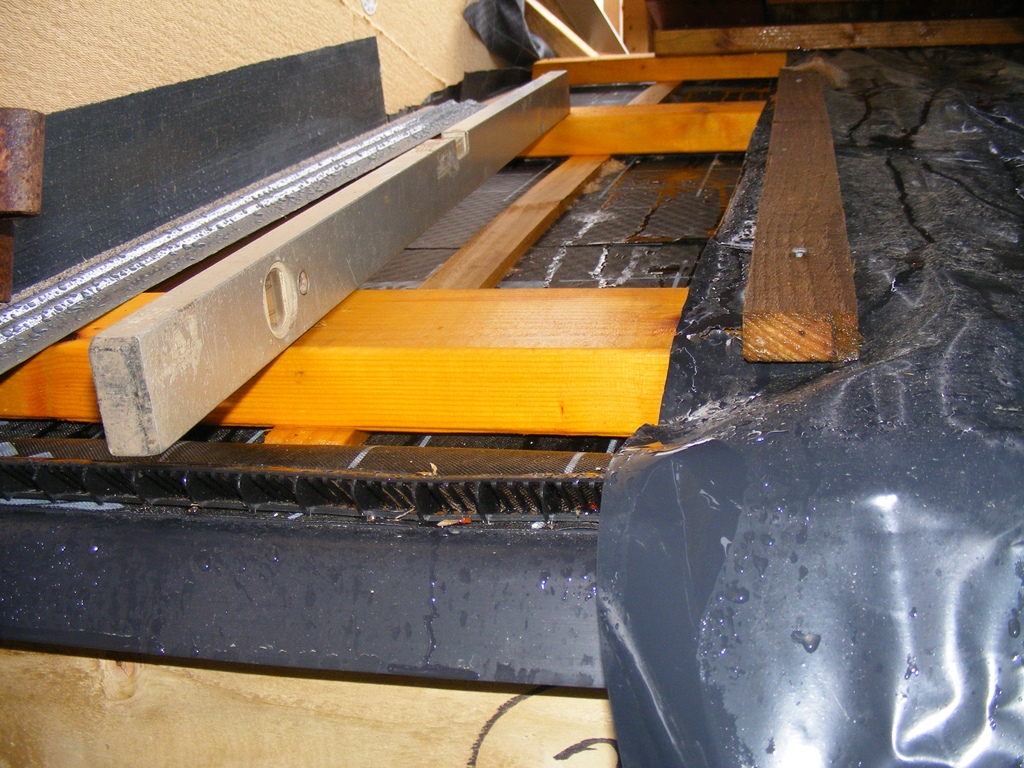

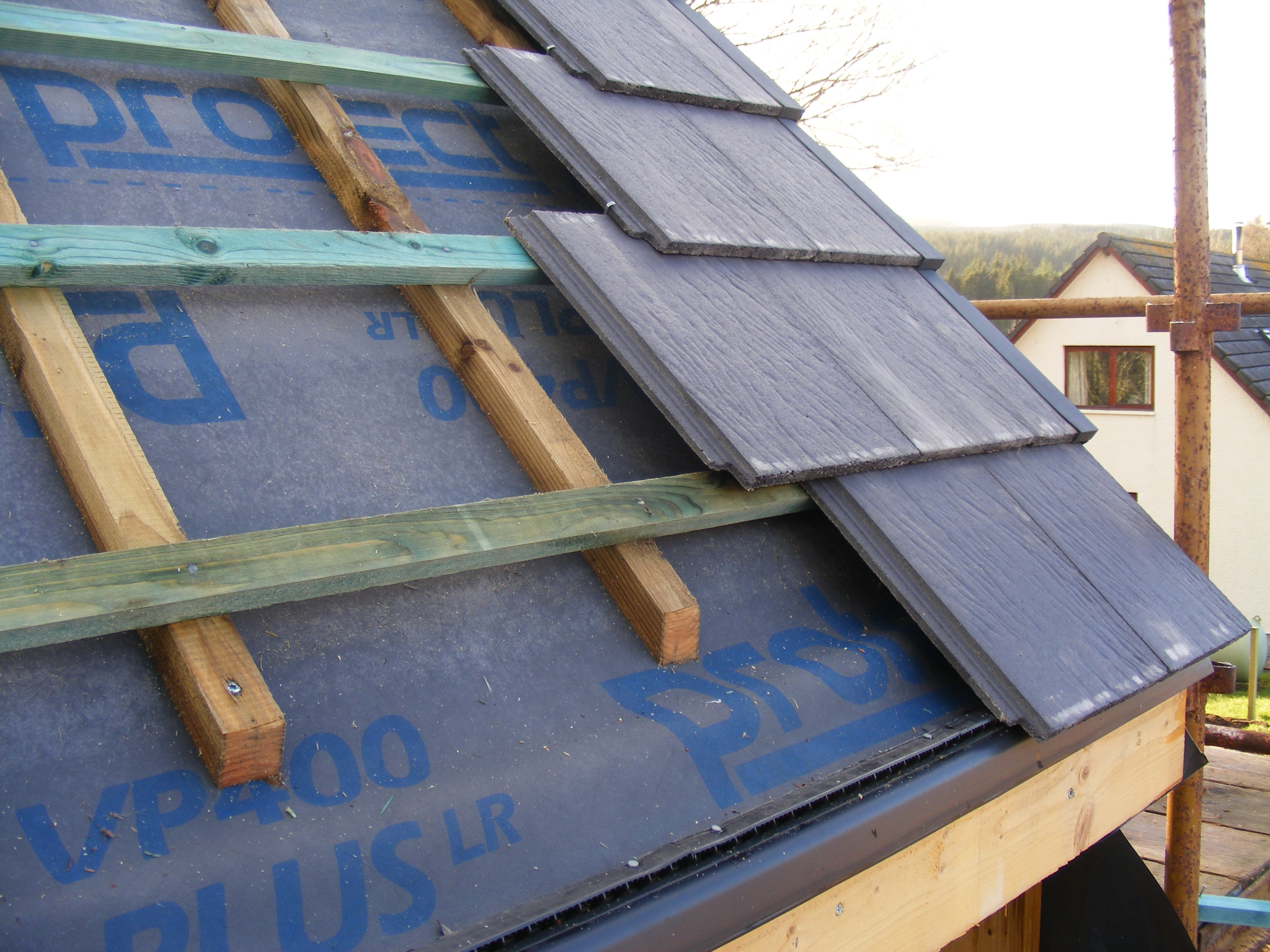

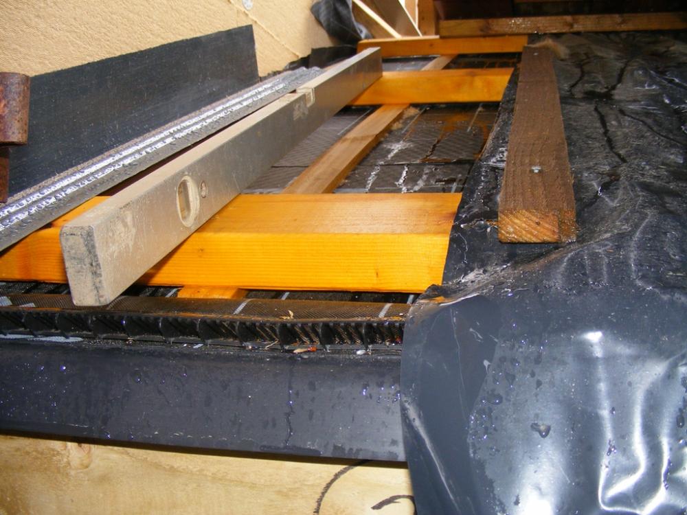

ProDave Posted June 11, 2016 Share Posted June 11, 2016 7 hours ago, Crofter said: On a related note, it seems that I will need to fit eaves guards- guessing that these go between the membrane and the battens? Do you mean this?: What we have is the fascia board set at a height so that allowing for the ventilator strip, it is at the right height for the bottom tile to rest onto. So that usually means the top of the fascia board is higher than the sarking board would be if it carried on down. Some roofers will cut the sarking board just below the bottom batten and have the bottom section of sarking angled onto the top of the fascia. What I did was bought plastic eaves boards (not the proper name but I don't know what the proper name is).They are as cheap as chips from TP something like £3 per 1.5 metre length. So the plastic eaves board fixes to the top of the fascia, and the plastic extends up the roof by 8" or so giving the "kick up". the membrane lays down over the top of this. Then the vent strip goes on and the edge of the membrane then gets trimmed off with a sharp knife leaving the edge of the membrane securely fixed and the plastic eaves board directs any water out into the gutter. Link to comment Share on other sites More sharing options...
Crofter Posted June 11, 2016 Author Share Posted June 11, 2016 How do you secure the membrane over the plastic guard- just nail through both layers? I think the purpose of the eaves guard is to keep the UV off the membrane at the very edge, where it is exposed. I'm planning a rather simpler design where the sarking board angle remains constant and overhangs the edge of the fascia, so the plastic strips would just be to add a UV layer. Would also help hide the cut edge of the OSB. Haven't considered how to deal with the edge of the box profile- I know you were asking about that very issue so I'll dig up tat thread again... Link to comment Share on other sites More sharing options...
ProDave Posted June 11, 2016 Share Posted June 11, 2016 So you are proposing putting the plastic strip on top of the membrane. So any water running down the membrane would run UNDER the plastic strip, and drip off in an uncontrolled fashion and may or may not drip into the gutter, it may just run onto the cut edge of the OSB? By putting rhe plastic under the memnbrane, any water running down the membrane passes through the slot vents over the formed edge of the plastic into the gutter, keeopnf the fascia (and any exposed cut edges of sarking) nice and dry. The edge of the membrane is sandwiched in between the plastic strip and the plastic slot vents, and secured by the nails holding the slot vents that go through all 3 into the top of the fascia board. I have detailed a similar thing for my box profile roofing which I will take a picture of and post it here later. Link to comment Share on other sites More sharing options...
ProDave Posted June 11, 2016 Share Posted June 11, 2016 I have just updated my other roofing thread with this picture. This is the detail I ended up with for my sun room roof. Almost identical except it is set slightly lower, so the roof profile (as mocked up here by the spirit level) does not quite touch the ventilator strips. the filler profile for the box section roofing will fix (glued?) to the top of the ventilator strips. Link to comment Share on other sites More sharing options...
