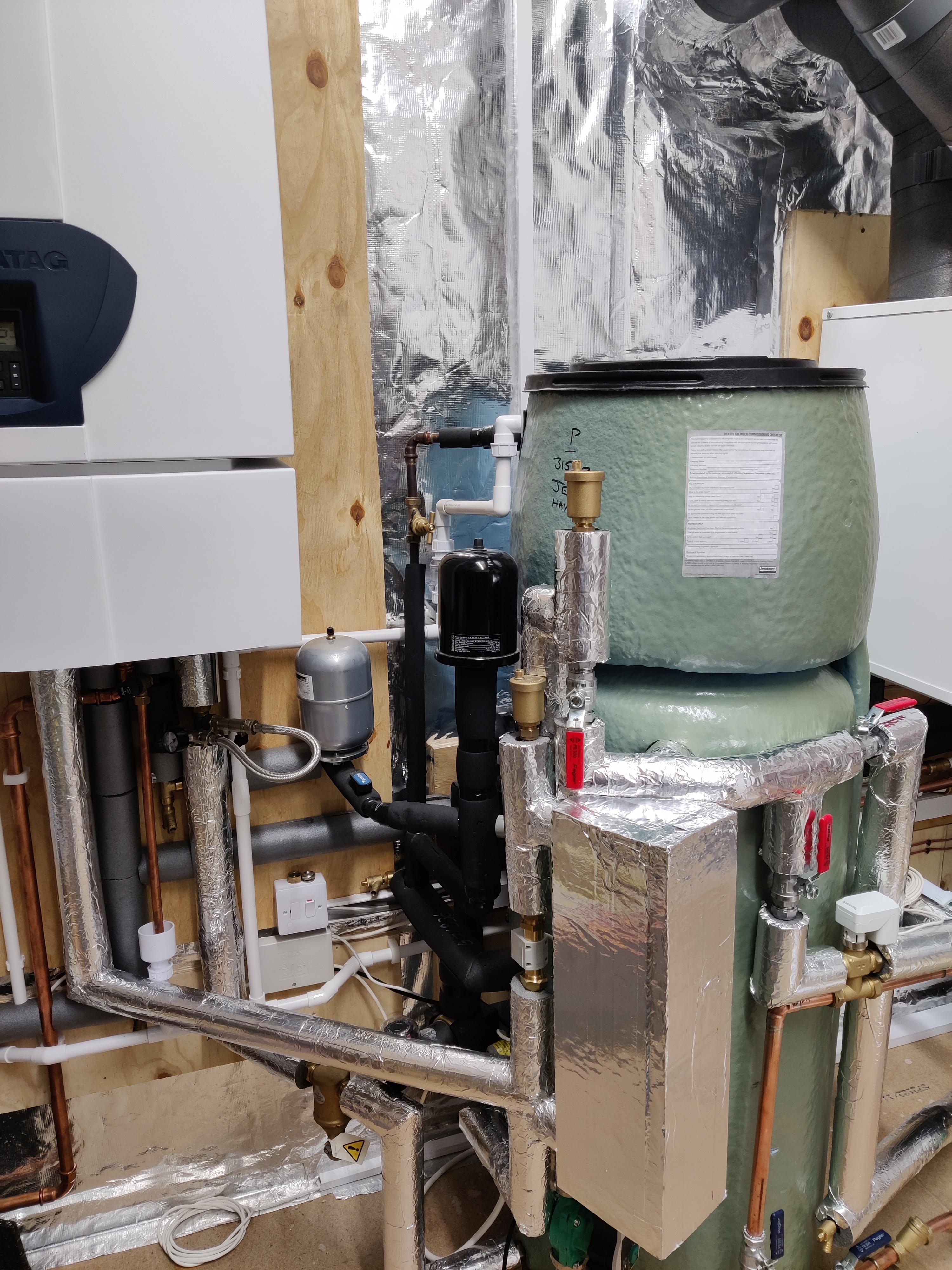

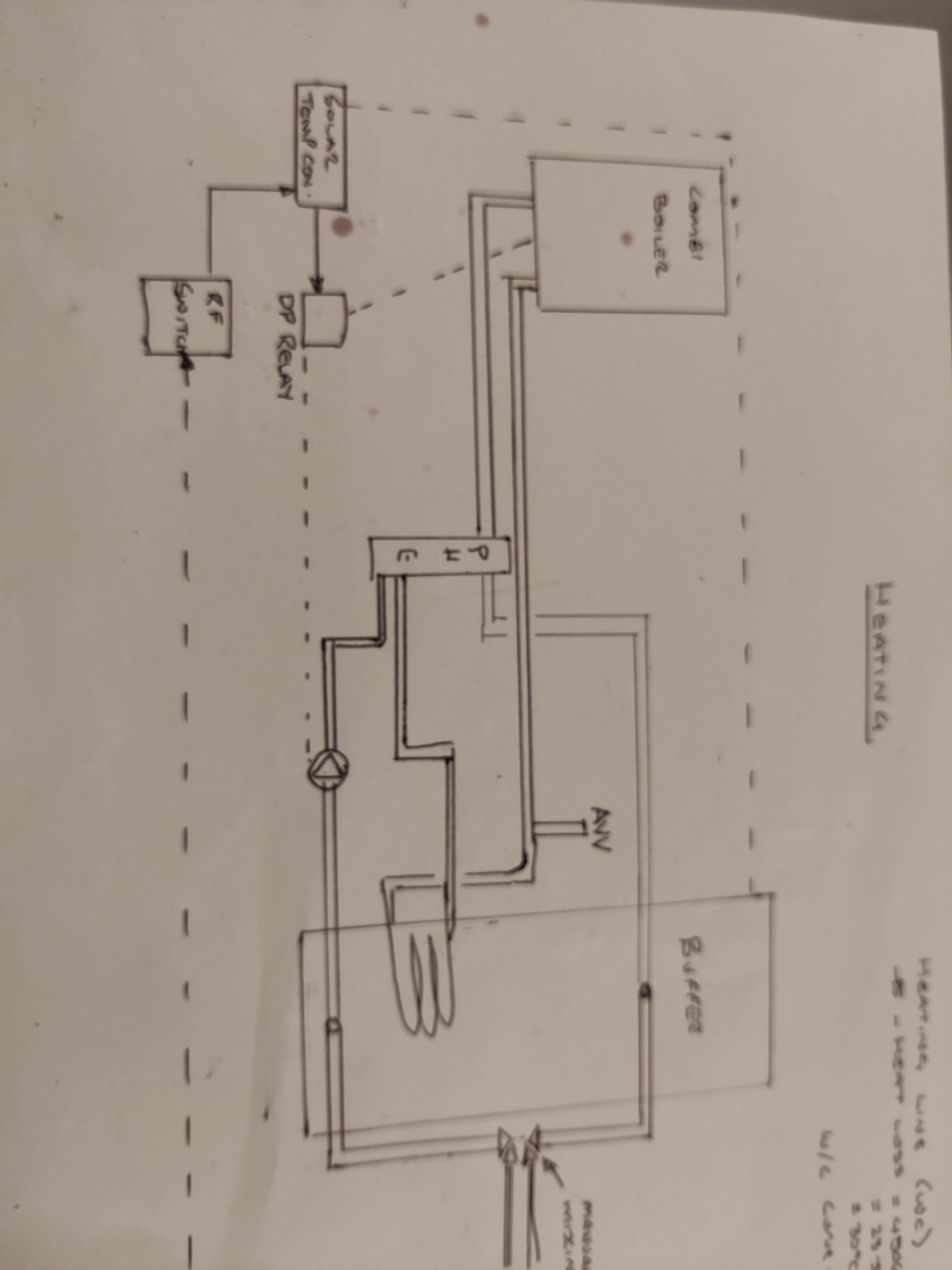

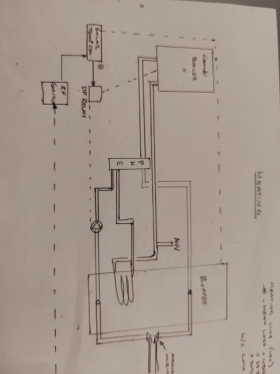

JohnMo Posted April 4, 2023 Posted April 4, 2023 Hot side of PHE. Water from boiler, to PHE, out of PHE in to coil and out back to boiler. Other side of PHE, water is pumped from the bottom of cylinder through PHE to top of cylinder. The cylinder is connected as a two port buffer with oversized tees at the cylinder. The other side of the oversized tee goes to the UFH. The cylinder also has a DHW coil not shown on this drawing. In my case it's a thermal store, but could work with an UVC or any cylinder. Prior to PHE install at 30 degrees flow temps, boiler run for about 1 to 2 mins and shutdown on high temp. Following PHE install boiler runs for about 10 to 20 minutes. The increased area allowing much more heat to be transferred to cylinder. The approach temperature of PHE is about 2 to 3 degrees depending on flow temp.
SteamyTea Posted April 5, 2023 Posted April 5, 2023 @JohnMo You seem to be going down the same path that @Jeremy Harris went down a fair few years ago. Real shame that his blog is not about anymore (possible wayback machine has a copy). In the end he dumped it all and got a Sunamp for the DHW. No idea if that is still going well, he had trouble with one of them.

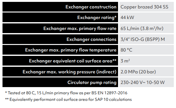

JamesPa Posted April 5, 2023 Posted April 5, 2023 OK @JohnMo that now makes sense. The idea of a PHE separate to the DHW tank merits some exploration, I feel as it has some interesting properties (albeit that it may be a dead end): Mixergy claim it makes the tank smaller and the the HP more efficient. The first is true, 3sq m of 22mm internal coil (the typical area for a HP) has a volume of 33l which subtracts from the available volume of stored DHW. Thats not the 40% they claim though in most cases. The second is true if you can achieve a lower delta T between flow temp and DHW temp with the PHE. Possibly you can, depending on the heat transfer function of the PHE. I looked at a couple of PHE specs and decided I dont know how to interpret them! The spec for the Mixergy one is below so perhaps someone else does. I guess the 'exchanger rating' tells us about the heat transfer - but under what conditions. Also it says it has an equivalent coil surface area of 3sq m, the same as a typical HP DHW coil, in which case Im not so sure about the claim that HP efficiency is increased. I calculate that a 5C temp difference is required with a 3sqm coil to maintain 4kW heat transfer (a figure chosen because its the minimum output of my target 11.2kW HP), so for a 50C water temp you need a 55C flow temp. It would be good to do better! The pump (presumably) more or less completely de-stratifies the stored DHW (in contrast to the Mixergy tank behaviour when its used without a HP). Im not sure if this is good or bad, but probably does serve to reduce a bit the deltaT between the DHW temp and the flow temp, because you are not relying on convection to shift the hot water away from the coil and replace it with cold water. The two points above, if they can be got to work, will presumably reduce recovery time. Pulling the heat exchanger outside the tank also means that it can be swapped out occasionally without swapping out the tank. In hard water areas that may be a benefit. Against this a PHE will presumably be more susceptible to limescale formation (or will the speed of the water negate this) It would in principle (I think)be possible in principle to locate the PHE at a location remote to the cylinder. This might be useful if the cylinder is, for example, in an airing cupboard next to a bedroom and it was desirable to locate the pump somewhere else to reduce noise nuisance. Last, but not least (and of interest to me and, it seems, @sharpener), its a possible way to retrofit an existing cylinder (with an insufficiently large coil) for HP operation - effectively what Mixergy do with their HP conversion kit. The Mixergy has dedicated tappings for this, an existing cylinder wouldn't, so one would have to find a way to tee off from the existing input and output tappings, which might require a non return valve or two to ensure that the pump did 'the right thing'.
sharpener Posted April 5, 2023 Author Posted April 5, 2023 12 hours ago, JamesPa said: I was anyway going to ask what people think of the basic Mixergy idea as it relates to ASHPs. My initial view based on a skim read only was that its silly and that the complex scheduling idea is a gimic, but Im probably missing something Out of interest had a look at Mixergy web site. They claim Mixergy tanks are proven to deliver up to 30% more usable hot water when compared to a conventional cylinder* with a reference to the NPL. The energy savings seem to stem from stratification and heating variable amounts of water according to a demand profile - which also enables you to get away with a smaller tank. Nowhere can I see an explanation of how it actually works. Compatibility with heat pumps is achieved with a control box and and external plate heat exchanger(!). If you are going to need that I would say @JamesPa's idea is at least as good. See you have cross-posted, will read yours and then maybe edit this.
sharpener Posted April 5, 2023 Author Posted April 5, 2023 (edited) 34 minutes ago, JamesPa said: The pump (presumably) more or less completely de-stratifies the stored DHW (in contrast to the Mixergy tank behaviour when its used without a HP). Im not sure if this is good or bad, but probably does serve to reduce a bit the deltaT between the DHW temp and the flow temp, because you are not relying on convection to shift the hot water away from the coil and replace it with cold water. The two points above, if they can be got to work, will presumably reduce recovery time. Pulling the heat exchanger outside the tank also means that it can be swapped out occasionally without swapping out the tank. In hard water areas that may be a benefit. Against this a PHE will presumably be more susceptible to limescale formation (or will the speed of the water negate this) It would in principle (I think)be possible in principle to locate the PHE at a location remote to the cylinder. This might be useful if the cylinder is, for example, in an airing cupboard next to a bedroom and it was desirable to locate the pump somewhere else to reduce noise nuisance. Yes to all the above. Even with a HX rated at 44kW(!) (with Tin = 80C, don't know what else is in BS12897) deltaT is 5deg, I would go to some lengths to avoid that in my system. You can tap into the HW flow anywhere there is a hot water tap, but the feed is difficult because for an unvented tank you have to get to the tank side of the pressure regulator. Is this G3 work? If the HX fails you might contaminate the DHW with antifreeze, don't know if propylene glycol is classified as toxic but ethylene glycol certainly is. Or conversely over-pressurise the HP loop, dumping it to waste or conceivably causing damage. I have not heard of big scaling problems with combi boilers in Cambridge (v. hard water) so perhaps that is not an issue ?because of the flow rates ?=> noise?. Edited April 5, 2023 by sharpener
JamesPa Posted April 5, 2023 Posted April 5, 2023 (edited) 1 hour ago, sharpener said: Even with a HX rated at 44kW(!) (with Tin = 80C, don't know what else is in BS12897) deltaT is 5deg According to my calculations that's the best I will achieve with the standard 3sq m coil and the minimum operating o/p of my HP (4kW). I suspect the actual will be a bit worse. 1 hour ago, sharpener said: You can tap into the HW flow anywhere there is a hot water tap, but the feed is difficult because for an unvented tank you have to get to the tank side of the pressure regulator. Is this G3 work? No idea. I have a vented tank so am now wondering about retaining it and using the PHE trick 1 hour ago, sharpener said: If the HX fails you might contaminate the DHW with antifreeze, don't know if propylene glycol is classified as toxic but ethylene glycol certainly is. Or conversely over-pressurise the HP loop, dumping it to waste or conceivably causing damage. That's true, but its true also if the coil fails in a regular cylinder. Frankly I don't much like the idea of glycol circulating so plan to use anti freeze valves instead. Having said that CH inhibitor probably isnt very good for you. On the other hand most people don't drink hot water. Perhaps CH water should be treated with a dye, then you could spot cross contamination. Edited April 5, 2023 by JamesPa

sharpener Posted April 5, 2023 Author Posted April 5, 2023 9 minutes ago, JamesPa said: I thought this too until one prospective installer, who was otherwise hopeless, pointed out that the current 0.8m coil would cause bad short cycling. I did the math and he was right assuming I stick with a min deltaT between flow temp and target water temp of 5C. Buffer? I'm thinking of a layout which while charging the tank albeit slowly on E7 and topping up in the afternoon will also charge a buffer tank to Tmax (?70) in order to feed the bedroom rads am and late evening while the HP is simultaneously running the UFH at a lower temp with better CoP. This will minimise the operating time at high temp whilst also keeping a good load on the HP to reduce cycling. A 200 litre store will fall at 10 deg/hour while putting out 2.5kW which sounds about right for this application. The TRVs start to close after about half an hour anyway, we lie in bed listening to the gears whizzing round.
JamesPa Posted April 5, 2023 Posted April 5, 2023 30 minutes ago, sharpener said: Buffer? Trying to avoid for reasons of space and also why would I want to buffer at 55C when my CH runs at 45C. Based on these discussions (which are really off-topic) Im going to start a new thread with a related off the wall proposal for people to shoot down.
