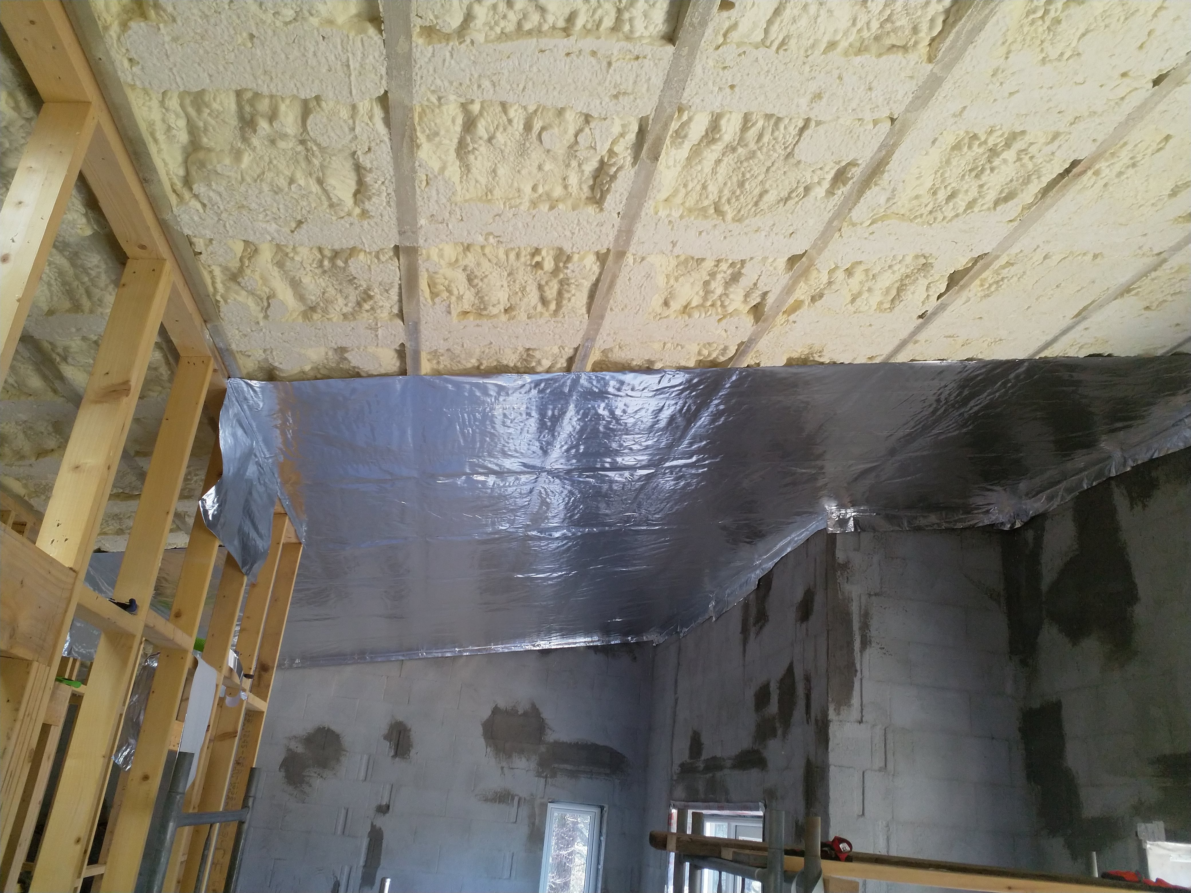

JohnMo Posted April 2, 2023 Share Posted April 2, 2023 2 hours ago, Nickfromwales said: Did you cap the open cell layer with a layer of closed cell, or did you go for an internal membrane instead? We used an airtight vapour tight membrane, double sided taped to battens and stapled, all joints and staples aluminium taped. At the wall the the membrane was glued to wall with airtight mastic. We then added 50mm battens to form a service void and plain plasterboard . 2 Link to comment Share on other sites More sharing options...
Nickfromwales Posted April 2, 2023 Share Posted April 2, 2023 4 minutes ago, JohnMo said: We used an airtight vapour tight membrane, double sided taped to battens and stapled, all joints and staples aluminium taped. At the wall the the membrane was glued to wall with airtight mastic. We then added 50mm battens to form a service void and plain plasterboard . Seems very neat, and looks like you had minimal amounts to clean back? Are you happy to share who the installers / suppliers were? 1 Link to comment Share on other sites More sharing options...
JohnMo Posted April 2, 2023 Share Posted April 2, 2023 (edited) We had about 10 bags of trimmings from over 250m2 of roof. Job was completed in around 2 days. I did all the battens and vapour control layer. Yes very happy to share. The same company built our roof and did the foam (although as two separate contracts). JHJ Joinery and JHJ Insulation. They are based near Aberdeen. The guys on site had a really good work ethic, nothing was to much trouble, they got on with it. Edited April 2, 2023 by JohnMo Added missing details 1 1 Link to comment Share on other sites More sharing options...
Nickfromwales Posted April 2, 2023 Share Posted April 2, 2023 14 minutes ago, JohnMo said: We had about 10 bags of trimmings from over 250m2 of roof. Job was completed in around 2 days. I did all the battens and vapour control layer. Yes very happy to share. The same company built our roof and did the foam (although as two separate contracts). JHJ Joinery and JHJ Insulation. They are based near Aberdeen. The guys on site had a really good work ethic, nothing was to much trouble, they got on with it. Fantastic review of them, and thanks for sharing. Always great to mention troopers like those chaps on here for others to possibly then get support from. Doubt they'd want to travel to the M25 region? Link to comment Share on other sites More sharing options...

Dave Jones Posted April 21, 2023 Share Posted April 21, 2023 32 minutes ago, dabba said: Many thanks for the replies, With the new building regs in mind would anyone know the likely 'over the rafter' insulation thickness for a warm roof, the company doing the building regs drawings are showing some reluctance (they had designed for between & under the rafters) the reason they have reservations is "it would raise the roof height" which could be an issue with planning. If anyone has a idea of possible over the rafter insulation thicknes along with between the rafter insulation (the attic truss design is 197mm for truss & ceiling timbers) it would be most helpful. you need 250mm of celtex to meet new build regs or 150mm for a refurb. Issue putting it externally on the trusses (warm roof style) is how are you going to fix the tiles ? Putting it between 8 x 2 trusses and then 50mm again under that works. You then have the issue of making it vapour tight which is very hard as you are left nowhere to run cables unless you batten again to make a service void but it wont be deep enough for downlighters unless you use 4x2 at which point you have now lost 150mm of headroom all over the roof. No easy wins. 1 Link to comment Share on other sites More sharing options...
JohnMo Posted April 21, 2023 Share Posted April 21, 2023 3 hours ago, Dave Jones said: service void but it wont be deep enough for downlighters unless you use 4x2 You only need 50mm battens for downlights, if you select the right ones. The transformer comes seperate and will slip in the void and the lights are slimmer than that. 2 Link to comment Share on other sites More sharing options...
