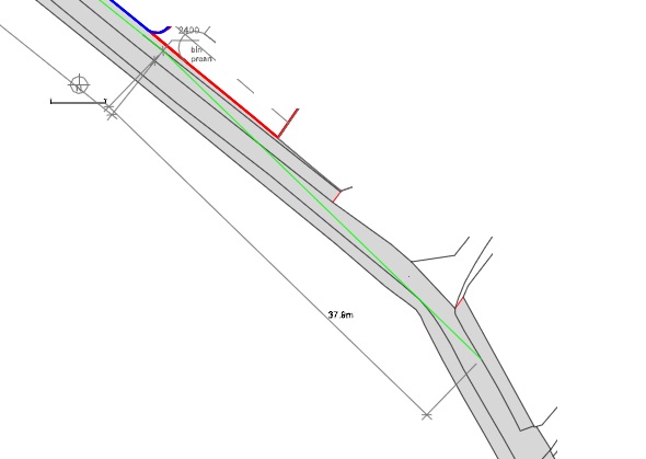

Alan Ambrose Posted March 28, 2023 Posted March 28, 2023 (edited) I've searched around but can't find an answer to this - can/should visibility splays include the verges (as opposed to just the carriageway)? The local examples I can see (e.g. below) exclude the verge - but I would like to include it for obvious reasons. Edited March 28, 2023 by Alan Ambrose

Alan Ambrose Posted March 29, 2023 Author Posted March 29, 2023 Thanks everyone - seems clear that open verges are fine and the architect that submitted the previous application was mistaken / over-cautious.
