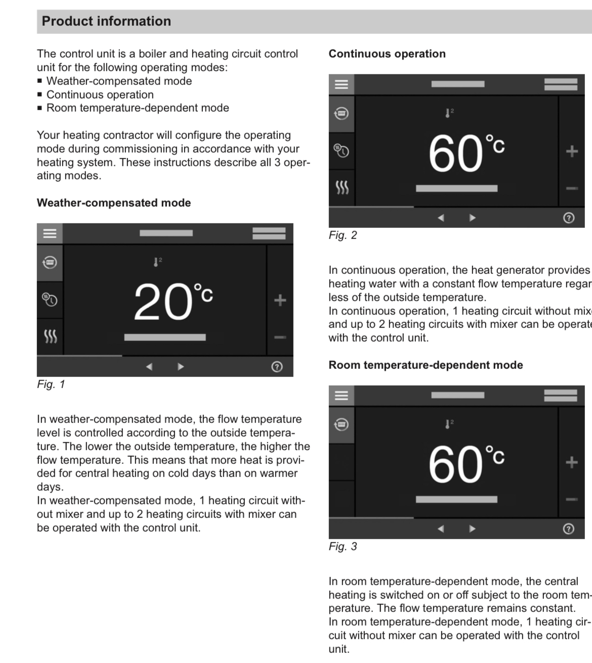

Adsibob Posted March 26, 2023 Posted March 26, 2023 We are away on holiday and have a friend checking up on the house. He called me up to tell me the boiler fan was running and some adjacent pipes were hot. At the time this observation was made, the thermostats in the rooms and HW for the cylinder had all been off for 30h at least. Fishing through the various menus on the Viessman (a Vitodens 200W system boiler), and consulting the manual it appears that there are three modes which it can be setup on initial commissioning: - weather compensated mode - continuous operation - room temperature dependent mode Im just trying to work out if this was a mistake on commissioning or if there might be a reason for choosing continuous operation? We have our system boiler installed with a low loss header. All our heating is UFH (four manifolds) except in two bathrooms, where we also have a towel rad in each one. My friend couldn’t seem to change the mode to “room temperature dependent mode”, so he has just turned the whole boiler off at the mains. I will investigate when I’m back home, but it was commissioned 9 months ago and because we have the hot water tank heated by the boiler three times a day plus a recirculating secondary loop that comes on wherever you’re in the room where the boiler is, I had assumed the hot pipes were from that - never noticed the boiler make any fan noise when it was meant to be off, so I wonder if this is a mistake at the time it was commissioned, or an issue that’s developed since. I attach a screenshot from the manual; it doesn’t give much info:

Nickfromwales Posted March 27, 2023 Posted March 27, 2023 1 hour ago, Adsibob said: Indeed. Just curious as to other’s thoughts on the utility of a continuous operation mode. Maybe @Nickfromwales will chime in with some views. Continuous operation as I read it in your screenshot means it just doesn’t attenuate flow temp a-La weather comp. Not that the boiler ( heat generator ) would run continuously? Was there a WC’p outside sensor installed also when the boiler was installed? If not, then that’s why it’s set to that. I would have thought room temp setting would have been the one, with the room stat dictating this? FYI, I’ve never worked on / been around an install for one of these.

Adsibob Posted March 27, 2023 Author Posted March 27, 2023 19 minutes ago, Nickfromwales said: Was there a WC’p outside sensor installed also when the boiler was installed? no. 19 minutes ago, Nickfromwales said: If not, then that’s why it’s set to that. I would have thought room temp setting would have been the one, with the room stat dictating this? don’t these two statements contradict each other?

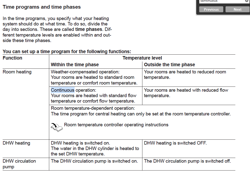

Temp Posted March 27, 2023 Posted March 27, 2023 Manual also has this.. Quote Your system is preset Your heating system is preset at the factory and is therefore ready for operation following commissioning by your contractor: Central heating in weather-compensated operation ■ Between 06:00 h and 22:00 h, rooms are heated to 20 °C "Room set temperature" (standard room temperature). ■ Between 22:00 h and 06:00 h, rooms are heated to 3 °C "Set reduced room temperature" (reduced room temperature, frost protection). Central heating in continuous operation ■ Between 06:00 h and 22:00 h, the set flow temperature is 60 °C ("Normal set flow temperature") ■ Between 22:00 h and 06:00 h the set flow temperature is 50 °C ("Reduced set flow temperature", frost protection) Central heating in room temperature-dependent operation ■ The rooms are heated in accordance with the settings on your room temperature controller. Not sure it make things any clearer.
Temp Posted March 27, 2023 Posted March 27, 2023 The only time I can think continuous mode might work is when you have a rad system with a TRV on every rad? and a bypass to shut the boiler off when they are all closed. Will be interesting to hear what the answer is.

Adsibob Posted March 27, 2023 Author Posted March 27, 2023 1 hour ago, Temp said: Thanks @Temp, this just makes me think it should have been commissioned in room temperature-dependent mode.

Nickfromwales Posted March 28, 2023 Posted March 28, 2023 Thanks @Temp Seems that continuous mode uses either comfort or economy temps, and doesn't actually shut off. I expect having DHW and a HRC running when in residence has masked this occurrence. Case closed. "Watson, fetch me my pipe!".
