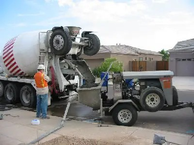

LSB Posted March 26, 2023 Share Posted March 26, 2023 Right, thoughts please. This came to light when trying to get quotes. Total wall length of the whole build is 81 linear metres around the outside. We had decided on using Durox foundation blocks (215 * 315 * 350 - 11kg) laid 350 wide for 150 insulation compared with Celcon foundation blocks (215*300*450 - 22kg) with 100 insulation based solely on the weight. HID doesn't feel that he can manage the 22kg due to weight. Trouble is one BM does Durox and the others only do Celcon. Concrete - due to the location of good ground it looks like we need a boom pump, but they are very expensive. Therefore, I did a little table and taking costing into account the cheapest option is 950mm concrete and 1 foundation block, which will get us up to 1175 giving enough leeway to be 150 over GL for DPM. I then started looking at using blocks in foundation, but that is the same price by the time you put concrete in the middle of the cavity. Does anyone have any experience of Durox v Celcon foundation blocks. Link to comment Share on other sites More sharing options...
saveasteading Posted March 26, 2023 Share Posted March 26, 2023 16 minutes ago, LSB said: concrete in the middle of the cavity Why do you need a cavity in the foundation? My default is concrete bed then 2 normal blocks. The 2 beds gives more chance to get the lebeks right. Link to comment Share on other sites More sharing options...
LSB Posted March 26, 2023 Author Share Posted March 26, 2023 15 minutes ago, saveasteading said: Why do you need a cavity in the foundation? My default is concrete bed then 2 normal blocks. The 2 beds gives more chance to get the lebeks right. I haven't explained myself, we don't want a cavity in the foundation. We are filling the 1m trench up to 950mm with concrete, then we are planning on 1 foundation block, the issue we have is the different BM's offer different foundation blocks. We weren't keen on using 2 blocks because the cavity between them under the DPM has to be filled with concrete which mean another readymix delivery, with the expensive pump due to the distance from hard standing. Or are you suggesting something else and I haven't understood (quite possible) Link to comment Share on other sites More sharing options...
MikeGrahamT21 Posted March 26, 2023 Share Posted March 26, 2023 I used the celcon trench blocks years ago, heavy buggers they were, but yeah did the job just fine. how about thermalite, tongue and groove with handles? I would use them if I ever needed trench blocks again https://www.ebay.co.uk/itm/185483333075?mkcid=16&mkevt=1&mkrid=711-127632-2357-0&ssspo=dk9yp24sta2&sssrc=2349624&ssuid=SHn2lQD2QEu&var=&widget_ver=artemis&media=COPY Link to comment Share on other sites More sharing options...
saveasteading Posted March 26, 2023 Share Posted March 26, 2023 51 minutes ago, LSB said: something else. Concrete footing. 2 courses 100mm block or 150. Backfill trench to dpm level, but with stone, barrowed presumably. Then dpm, hardcore, pir, turned up the block face, concrete slab. Oops my comment went into the quote box and is etaying there. Also, a concrete pump doesn't have to be a boom, if you can get round the obstructing building. Or bring in 4 barrowers for the occasion. Link to comment Share on other sites More sharing options...
LSB Posted March 26, 2023 Author Share Posted March 26, 2023 10 minutes ago, saveasteading said: Oops my comment went into the quote box and is etaying there. Also, a concrete pump doesn't have to be a boom, if you can get round the obstructing building. Or bring in 4 barrowers for the occasion. the problem isn't access it's the ground, as in a field which I'm concerned will be too soft for a concrete lorry The field went right up to the barn and some will become our garden. 1.5 ton digger slides around so hate to think what mess concrete lorry will get in. Also supplier said that with boom we need space for 2 lorries 🙂 Link to comment Share on other sites More sharing options...
saveasteading Posted March 26, 2023 Share Posted March 26, 2023 OK, so you are being told to hire a boom pump. A hopper pump will do it. Link to comment Share on other sites More sharing options...
saveasteading Posted March 26, 2023 Share Posted March 26, 2023 You can also hire conveyors to shift the stone if it can't be dumpered. But a tracked excavator won't disappear and could form its own track in. Any reason against a stone access, apart from cost? Link to comment Share on other sites More sharing options...

Dave Jones Posted March 27, 2023 Share Posted March 27, 2023 hire a 6 or 9 ton dumper for the day to move the concrete. they are peanuts a week from GAP nothing stopping you putting in a temporary track either. 1 Link to comment Share on other sites More sharing options...
