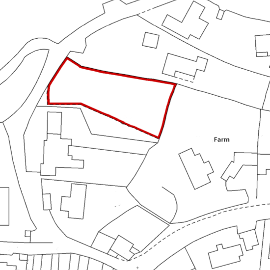

Whilst the cost of living crisis bites hard, and unwilling to part with too much (any) money on this at such an early stage, could anyone help me decipher the deeds and covenants on a field/paddock from a farm within a town boundary? Could I buy this and build on it?

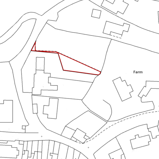

It actually has a separate deed for the entrance/access strip into the field, I'll add them both below.
Field:
  1. 1       (01.09.2003) The Freehold land shown edged with red on the plan of the
           above title filed at the Registry and being Paddock on the West side of
           REDACTED FOR PRIVACY.
  2. 2       (01.09.2003) The land in this title has the benefit of the rights
           granted by but is subject as mentioned in a Conveyance thereof dated 29
           March 1961 made between (1) (Vendor) and (2) (Purchaser) in the
           following terms:-
           "SUBJECT TO and with the BENEFIT OF all easements and rights in the
           nature of easements at present belonging to or employed with adjoining
           and neighbouring property on over or relating to the property hereby
           conveyed (so far as the Vendors and assign the same)"
  3. 3       (01.09.2003) The Conveyance dated 29 March 1961 referred to above
           contains the following provision:-
           "3. It is hereby declared that the Purchasers and their successors in
           title shall not be entitled to any easement or right of light or air or
           other easement or right which would restrict or interfere with the full
           use of any adjoining land of the Vendors or by the Vendors or any
           person deriving title under them from building or any other purpose"
           NOTE: The Vendors land was not further defined.
Entrance/Access Strip:
1      (15.08.2006) The land is subject to such restrictive covenants and
       easements as may have been imposed thereon before 15 August 2006 and
       are still subsisting and capable of being enforced.
Thanks cleverer people than I.
The field does not appear to have any restrictions, but likewise has no right of light etc.
The access strip is subject to covenants that may have been imposed earlier but are not specified.

It is 3.3
You cant spoil the neighbours rights.
Plannning and regs define that anyway.
Looks ok.
Joining the 2 red lined areas, are you looking at taking the combined area?
I would continue to research the plot to confitrm your interest but get that covenant looked at profesionally before committing.
A conveyancer would likely give free advice on the promise of the following work.

Thanks very much, the language is so obtuse (to me) that I wasn't sure it was even worth the hassle of putting infront of a conveyancer.
I would ideally take the combined area, but it wouldn't be a deal breaker to only have the field, provided I'd be able to create a new access point to the road.

Just now, saveasteading said:
What a big IF.
Yeah, don't fancy having to climb over a wall to get the kids and shopping in the front door.
You can't take the risk of not getting access  permission.
Ask the agents about it.
Can't tell from the plans. You need a minimum distance line of sight from an entrance, and it depends on speed limit and any obstructions. If the county doesn't permit it, you simply won't get permission.
And don't assume an existing agricultural access to a field will meet the requirements for access to a domestic dwelling.  Have a good look at what actual visibility you get in both directions from the existing access.
